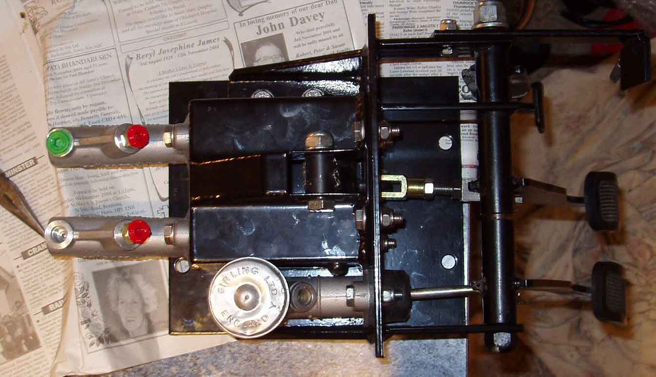

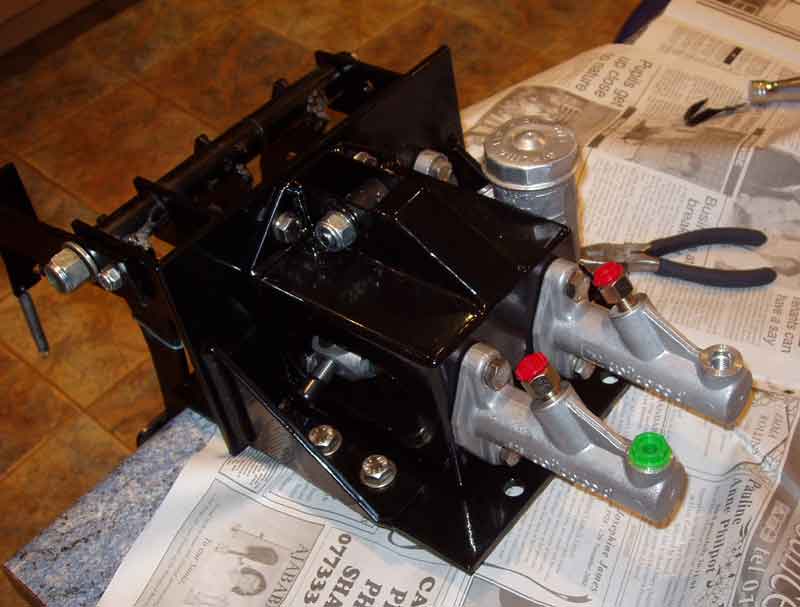

My upgraded brakes are here and ready to be fitted and I have enclosed some pictures of my GTD pedal box with the upgraded twin master cylinder/balance bar fitted.
This is a standard unit from Rally Design and has twin Willwood master cylinders as standard.
It fits to the GTD pedal box like it was made for it, requiring NO modification apart from four bolt holes to fix it to the GTD "upright" that the original master cylinder was fixed to.

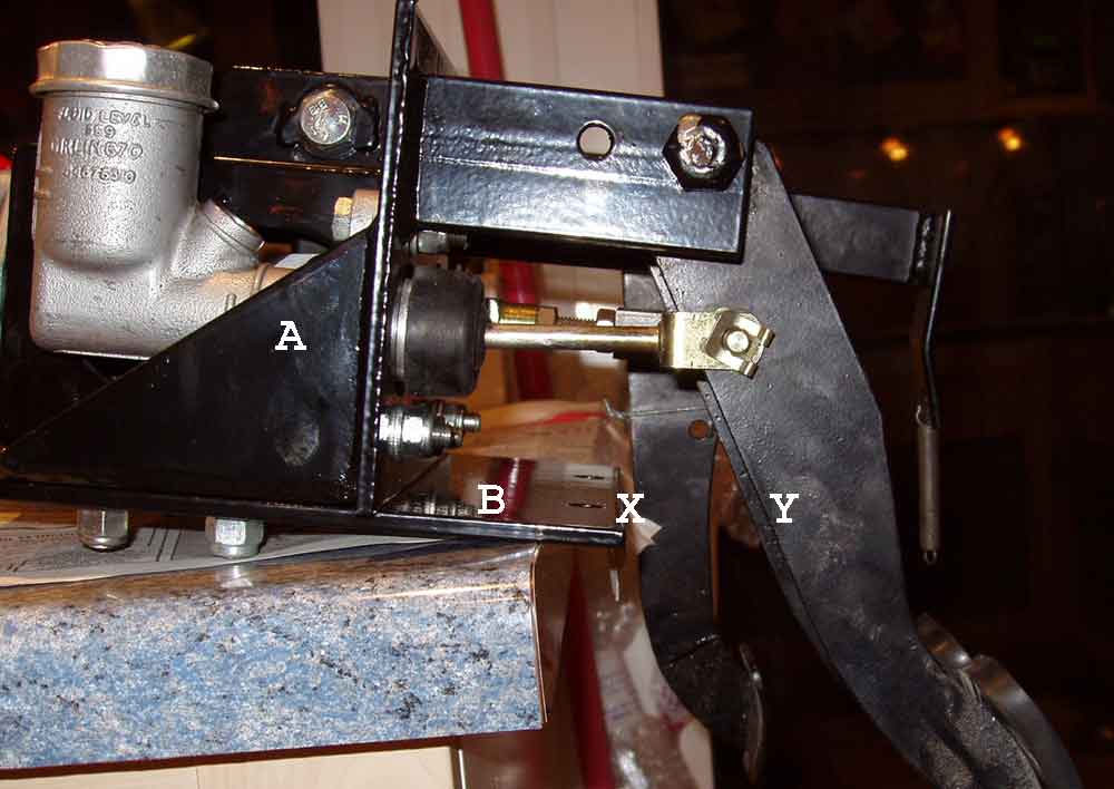

I have a query about the amount of movement I need to acctuate the brakes and clutch though.
As many of you may know, the standard GTD pedal box was "adjustable" (after a fashion) and on my car was fixed at the position most rearwards (the previous owner was a lot shorter) I could drive the car, but noticed there was plenty of room BEHIND the pedals. I am therefore able to move the pedal box "upright" (A on the enclosed picture) further back (left) in regards to flat plate (B in the pic) about an inch and a half to give myself some more room. HOWEVER this means that the back of the pedal (Y) is very close to the front of the plate (B) at X (confused?...you will be...) does this mean that I won't get enough movement?

Oh I almost forgot your question. Couldnt you notch the base plate to allow for clearance of ther peddles or is the base plate in alinement with the chassis cross bar. If so I think the wilwood catalog on line has dimentional drawing and mounting guidance. MERRY CHRISTMAS !!!!!!!

Yes, the front of the base plate lines up with the chassis rail, so the other option would be to notch the chassis rail and extend the whole footwell area.

Would this set up get clearance under a deep throat nostril section? Just a thought. Those master cylinders stick out quite a way.
Next time I fit it, I'll take some pictures and some measurements if anyone's interested. At the moment the front clip's off so it'd be difficult to judge. There's plenty of room with my twin nostril setup (which I'm going to deepen)
Simon
FYI, the master cylinders are 9 inches from the upright plate to the end, and the highest part (where the green bung is in the last picture) is 3.5 inches high, when measured from the flat plate that bolts to the chassis. Hope this is of use to anyone who's interested.

Hi Simon,
To answer your first question about travel, the geometry of the pedal arms are ideal when the mid point in the stroke results in the clevis pin on the pedal arm to master cylinder being perpendicular to the pedal pivot pin. That way you have minimised the tendancy for pedal effort to change as you depress the pedal. Also angularity of the pushrods are minimised.
This is the only way to go. If you have to adjust the pedal distance for comfort, do it by modifying the pedal arm past the clevis pin or move the whole assembly. Do not use master cylinder push rod length to adjust pedals for driver seating. Been there, done that, bought the T-shirt!
