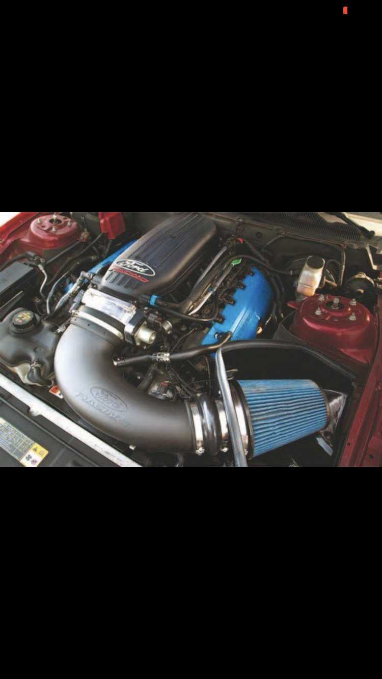

My Have Found A Coyote Intake Solution

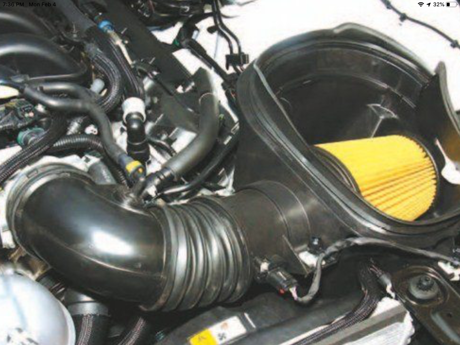

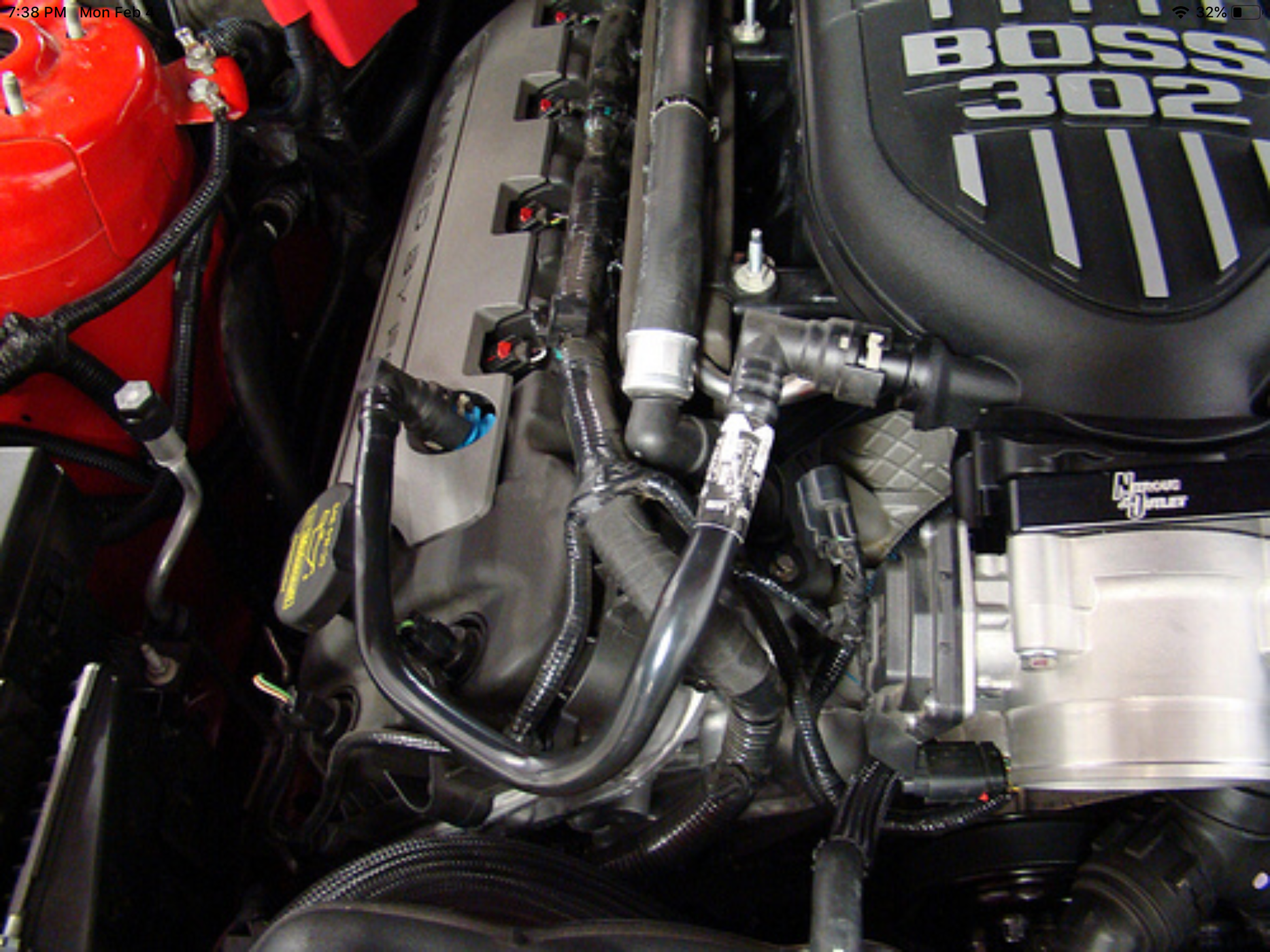

What’s strange is looking at the Ford Coyote engine, it has a hose from the cold air intake to a PCV valve to the valve cover and the other side goes to the intake. At lease as far as I can tell from pictures.
There are no real diagrams for Coyote engines
See how in this picture the hose goes from the cold air intake to the valve cover. That’s just like I did mine.
You’re saying that this is incorrect?

Is that one before and one after the throttle body / butterfly?
To the one closest to the air filter is taking filtered air and that is drawn into the valve cover
The one after the butterfly will be at vacuum so draw air from the other valve cover ointment the engine

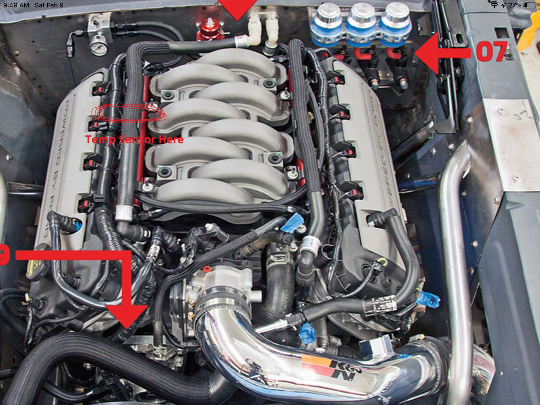

Does anyone have a PCV plumbing diagram that you can show me for a Ford Coyote or a modular engine?
I’m more of a visual guy and I can’t see what everyone is trying to say.
This is where I’m confused.
If you look at these pictures, it looks as though I’m plumbing correctly.
I have the same OEM GT350 cold air intake.
What am I not seeing?

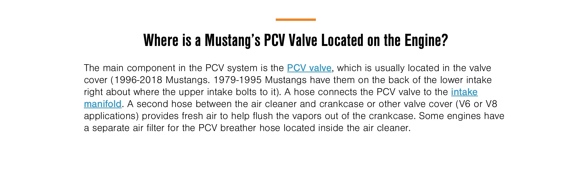

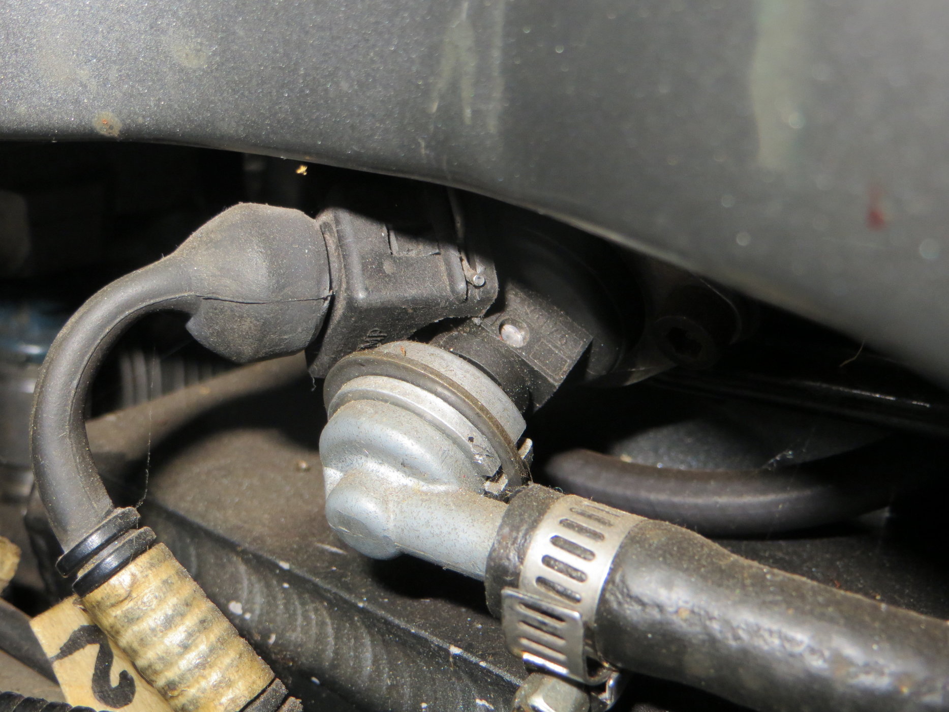

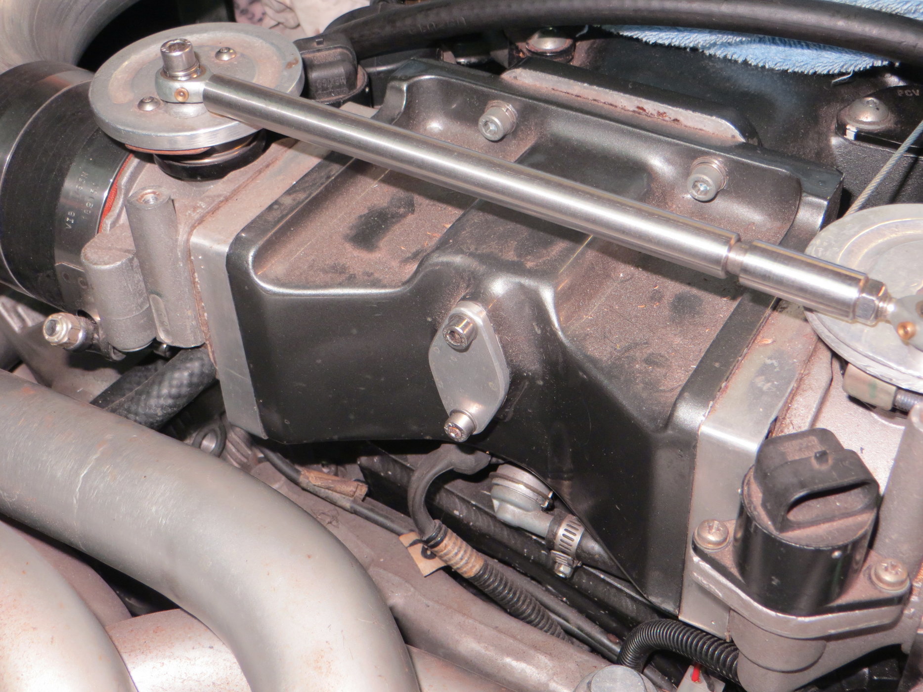

Here in Australia I’ve been informed, and my understanding is, that all engine vents must feed back into the inlet to be burnt up. Nothing is to vent to atmosphere, so filters are not allowed as engine pressure would vent gases out through the filter. To avoid that, is there a one-way valve below the filter mentioned by JP above?
Feeding in engine vents upwind of the MAP makes sense, so that it “sees” all of the flow, but it may be that the ECU / sensors can, in fact, handle venting downwind of the MAP. I’m afraid I don’t know the answer to that one. In looking at my situation more closely, (I think it’s) the MAP is below the manifold (see images) and so venting into the blanked off port should be fine after all. Or am I wrong about that? That will save me a fair bit of messing around if correct.
I’m just as confused as you with respect to the Coyote plumbing. Flushing with fresh air is new to me (no surprises there), but how does manifold vacuum supply air to a rocker cover? The vacuum from the other vent line is enough to overcome engine vacuum at the inlet and draw off some fresh air? My understanding was that any vents had to be controlled, usually by PCVs that opened with pressure. Anyway, I will continue to research, but welcome any clarification.
