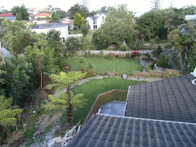

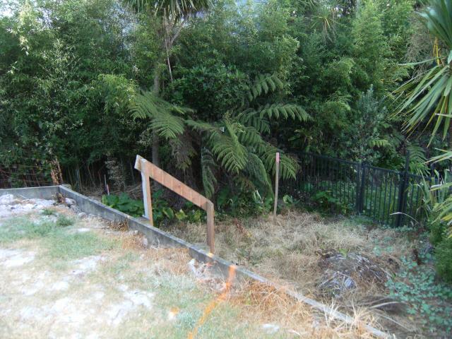

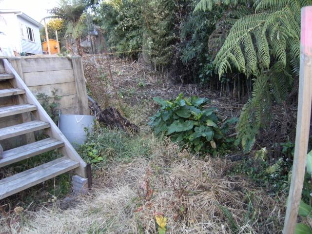

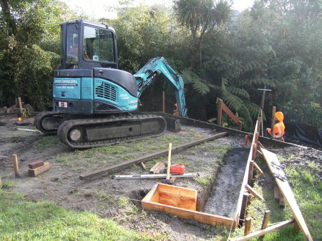

At last some action on the new workshop, nearly 4 months through the council regulatory authorities read jump thru hoops and I finaly got permission to spend my money on my land. The new place we bought has some waste land at the bottom of the property that had a non permited retaining wall and a public sewer running close by that all had to be taken into account with the design. Basicaly the back piles are timber piles bored down to 1 meter below the sewer and the top piles above the retaing wall are bored down to below the wall with concrete and steel cages fitted,all conected to a bond beam along the top edge, these piles go down 3.5 mtrs to clear the sewer. All this is tied together into the floor and then we are away. This action will happen rain or shine on Wednesday. The area where I am building has resulted in an unusual shaped shed of 9 mtrs long with 7 mtrs one end and 5 mtrs at the other. I have spent the last few days digging the above ground foundations and making the boxing. Really looking forward to getting all my toys and tools back in one spot so that I can get back onto the Lotus 7 style of car that I was building for my wife. I will even have windows to look out of compared to my last cave. As you can see from the pictures, its a bit of a challenge but worth it. I will post the progress as it happens.
The moral of this story is never give up trying when beurocracy waves it heavy hand. I had an ex councilor on my back boundary who did not want me to build there...her house is hidden in the trees to the left.

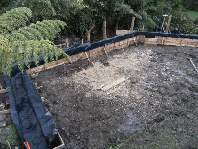

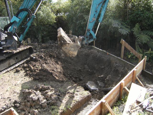

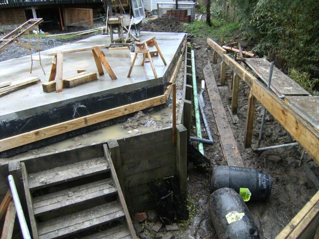

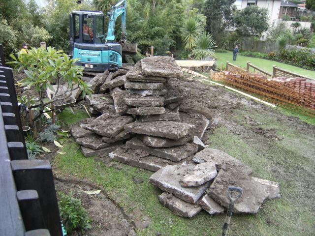

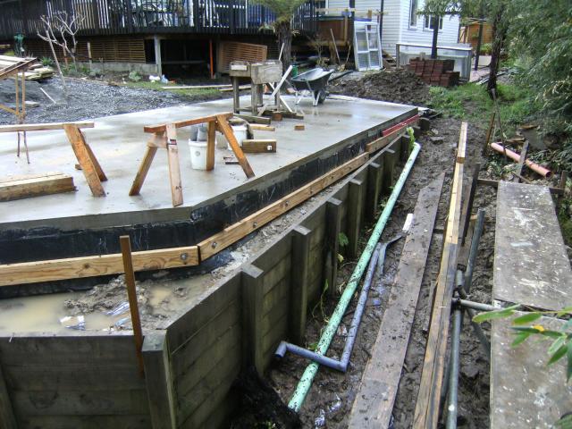

Well day 1 of progress, in comes the team with the digger and a few cups of tea later we have all the lower holes bored down to a depth of 3.5 metres, seems to easy so when we start drilling the top level and the first one goes down to its 2 mtrs depth easy, well we nearly order lunch. Onto the next one which is 3 mtrs and then clunk at 500mm oh well try the next, clunk, and the next clunk...all six holes left impossable to drill as the kind soul who built the wall had buried some 5 to 10 tons of heavy concrete slabs in behind it. I really did feel like some vital organs had slipped out thru my nether regions...all I could see was a picture of me standing there burning $100 dollar bills. After some skilled discussion, the crew decided that the best way forward was to dig it all out and as you can see from the picture, it was not looking pretty. After a bad sleep i had to head off to work for the day and dreaded what I was going to see on my return. On my first look I could have kissed them all..just joking, somehow they had managed to drill the holes and raise the colums with large cardboard tubes which were then back filled and compacted along with carefully placing each slab of concrete back in like crazy pave all filled and compacted. Then rebuilt the boxing to pour the beam. The yards now looks like a thousand wildebeast have driven thru but hey thats only grass. I am now back on track and should have the slab poured in the next few week.

Russell, you needed a bigga digga mate:), just joking! Im always impressed with what those guys can do with those small machines.

Progress, its stopped raining and the builder has dried out! Started to get the floor bearers down with the floor joists to morrow and hope to have walls emerging early next week. Time to put some beer in the fridge.

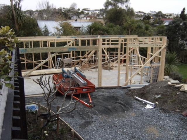

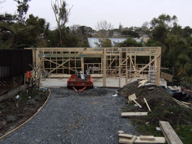

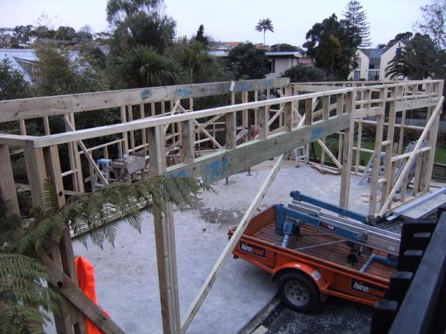

More progress now with all the floor down and walls up, lifted the flitch beams in for the roof and the rafters will be on tomorrow so hopefully the roof on next week with all done and dusted by the end of Sept early October...then I can bring the toys home if I can remember where I stored them. The floor lay out means that I can easily get my Mclaren on its trailer in the left hand corner, My brothers Plymouth in the middle and Carols Lotus Replica to the right still with heaps of storage space and workshop space. Now that I have an actual building to wander around in, I have changed the layout slighty to make better use of space.

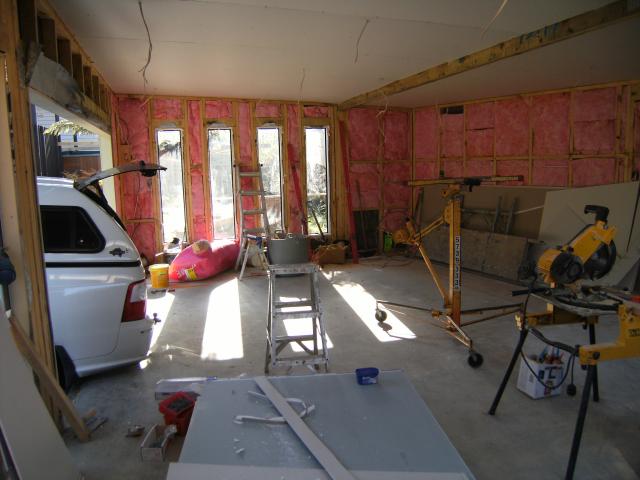

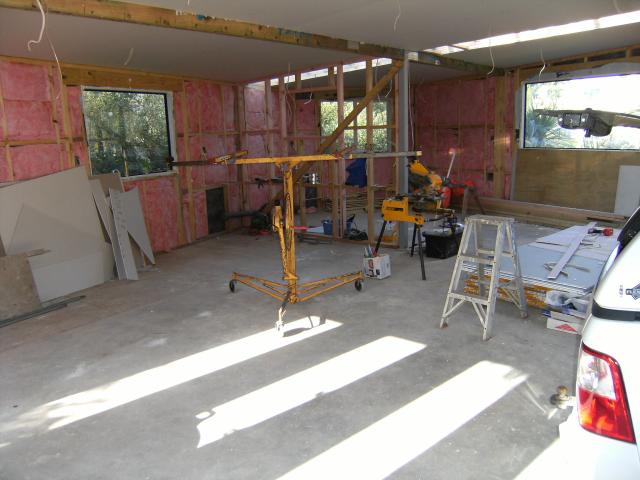

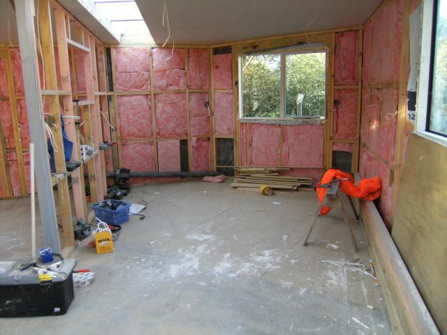

More progress now it all closed in and the back outside walls all painted ready to drop the scaffold. Had the pre line inspection and the good old council wants some changes made. Even though we have signed a caveat that it will not be made into a `home` they need these alterations just in case some one in the future may want to! Think I will install rail tracks as they just may want a train station at some time.....just in case.
Any way another couple of weeks and the cars will be in residence and I can be a bloke again. Have got my work area all planed out and managed to score a full kitchen with Kauri doors so it should look smart. My son in law has fitted all the wiring and lights so might be able to see.
