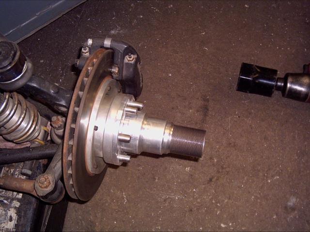

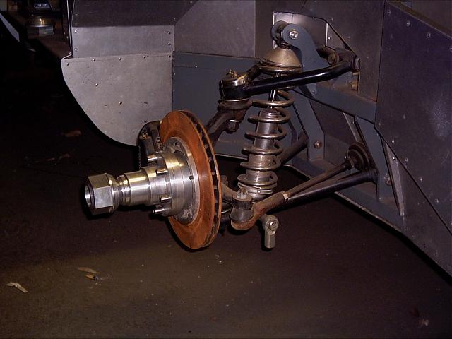

Here are some photos of my completed front wheel mounts to take the 15 X 10 fronts.

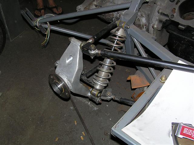

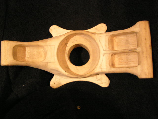

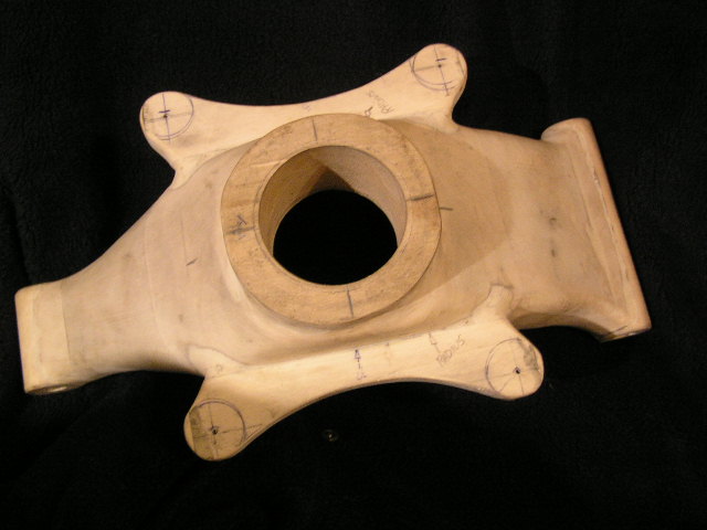

My uprights are my own design. I wanted the upright to fit into the wheels I am using, and provide as much stability as I could get.
They are 6061 alum, and use a ford bearing and hub.
My goal was to get my lower wishbone and transverse upper links as long as possible, while keeping with the 56" track width...everything works, and the units are strong and very light.
Here is a photo of the upright installed with just the hub mounted.
Phil

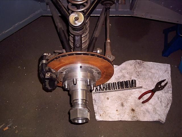

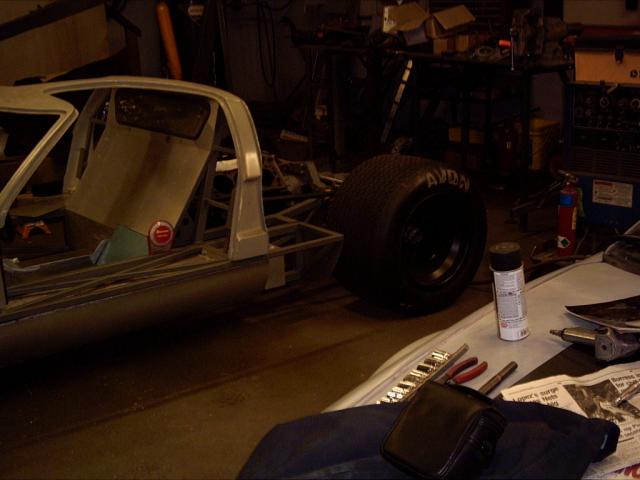

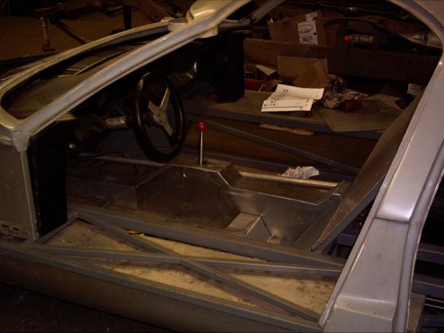

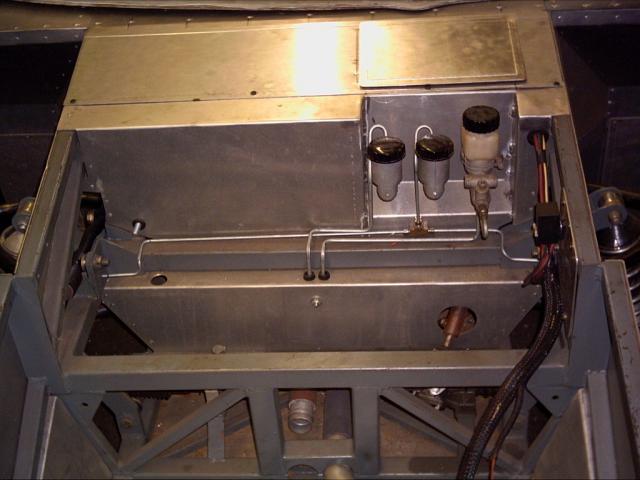

Good to hear from you. Don't know about bringing my chassis, but I will be there for sure. Meanwhile here are some photos I promised, progress is a little slow as I am on a big project now and happy to have work so "nose to the grindstone" as they say.
Here are photos I took sunday, wheels and tires are mounted, and I am working to complete panels and then on to some wiring. Brake pipes are run, need to complete mounting the rear brakes and flex lines to all 4 wheels.
Bill, I will give you a call in the next few days.
Phil

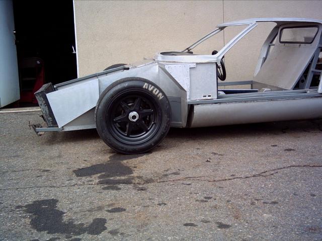

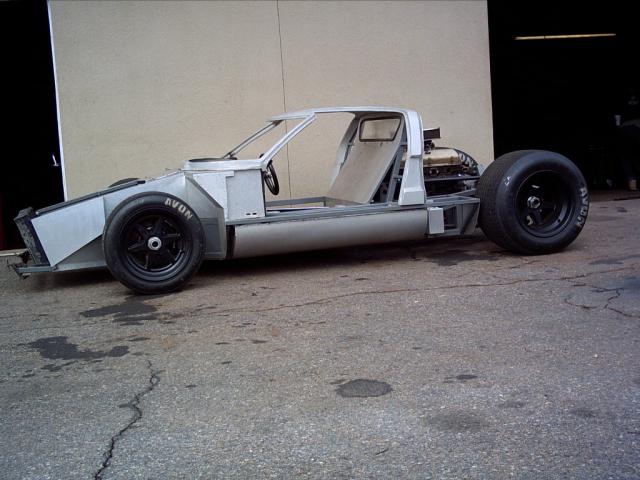

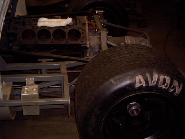

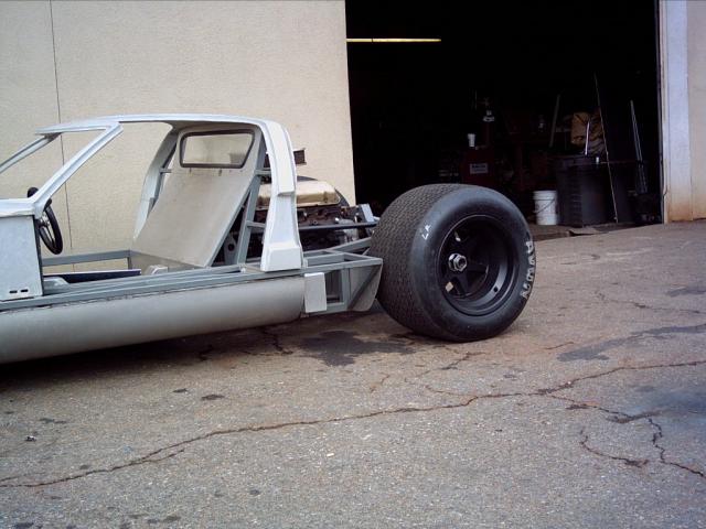

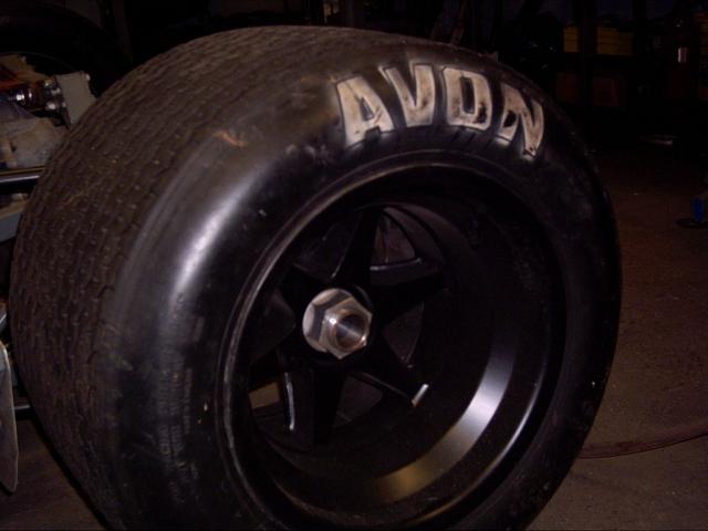

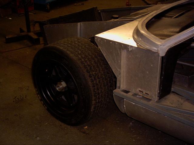

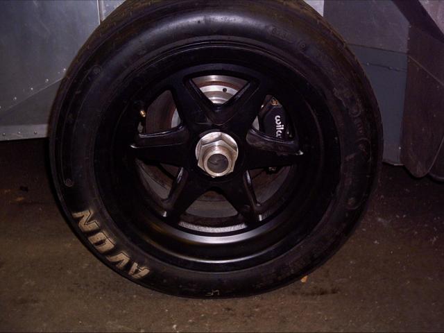

Back to my passion. A little spring cleaning and making space for the important stuff.
Finally got my adapters sorted out and wheels mounted correctly. I need to start fitting up the center section and then doors. I should have my rear decklid soon and can't wait to see how the tires fill the wheels arches. Hopefully I can progress faster than I have lately, and post some more progress. Took a few photos outside today and I think it sits about right.
Phil
