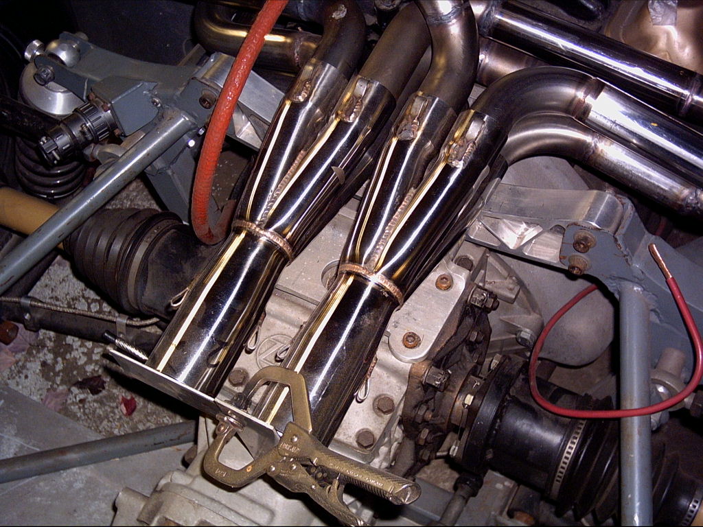

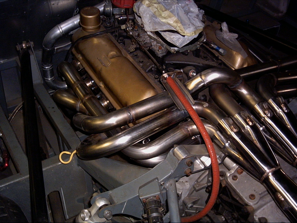

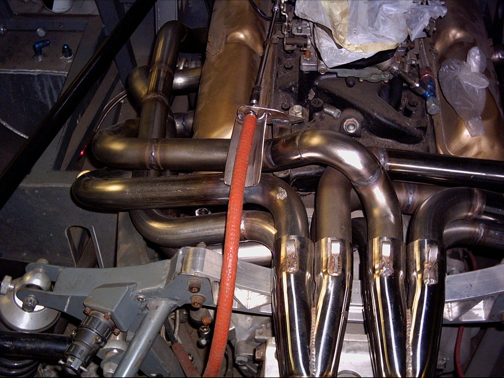

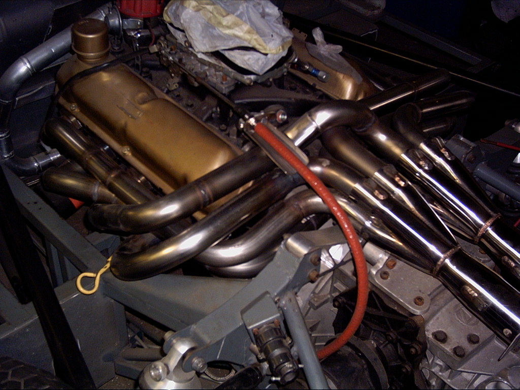

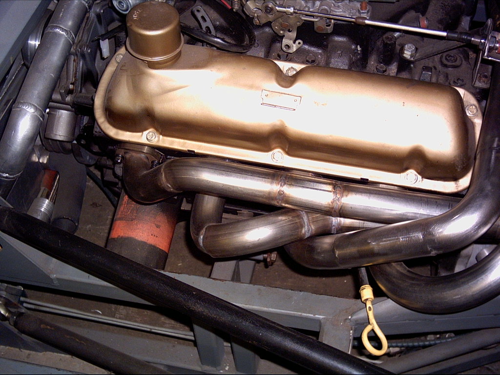

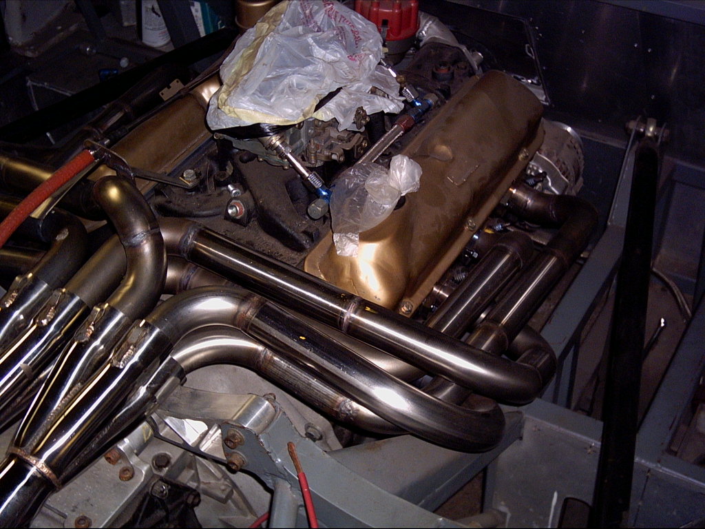

Finished up most of the exhaust and I just need to expand the end of the tubes into the collectors for a better fit.
I have two megaphones made and soon I will cut the end of the collectors and install the V-Band clamp assembly to mount the megaphones and give me the flexibility of swapping out to mufflers if need be.
Meanwhile here are some photos of the exhaust mounted without the megs.
Phil

Nice job Phil, Well done. How much room do you have from the end of the collector to the rear of the car? I am at that stage and trying to fit in some decent size mufflers with out it turning ugly.
Woody
Thanks Mark and Woody....I made some some small mistakes but for now I need to fire it up and deal with that later'
As far as room...I need to cut those collectors down at the merge point to fit my megaphones but I rightly don't know how much space is available....but tomorrow morning I will stretch a tape from the collectors to where the body work goes and give you a decent idea...
I can say that going from memory I believe the megs or mufflers run approx 27" back from the centerline of the axles and there is a height spec also but thats the closest I can remember until I get to the shop and measure...
Phil

Very nice work on the bundle of snakes Phil...
Rather curious water piping there at the front of the engine.. I take it that this was the only visble way to traverse to the other side.. Maybe need (or have and I didn't see it) an air bleed valve at the top?
Thanks Randy....You are very observant... Yeah there's a bleeder at the top...I always weld in bungs even if I don't need them, it is so much easier to remove a plug and bleed from the high spots when it is already there...sure beats the alternative.
I also have 2 bleeders at the top of the radiator and the water piping is the last thing to do so we are looking at startup soon.
