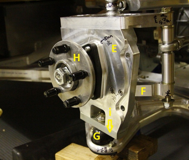

Yes, I am ignorant.:shy: Now that that is out of the way, I'm looking for some elementary information in the form of "What is this part called?".
I appreciate the forum entertaining my benighted questions. Your answers will help me to refrain from making references such as "The upper boomerang-shaped thingy". :laugh:

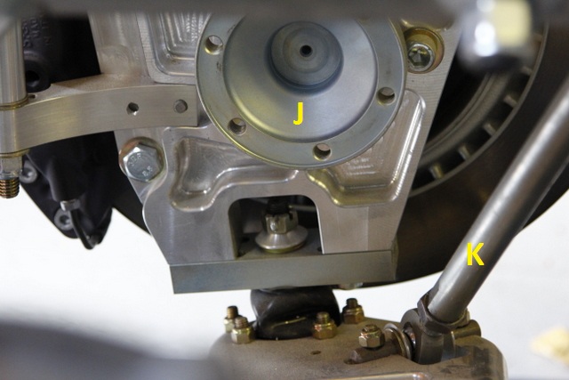

a - upper control arm
b - thingie upper control arm attaches to
c - toe bar (sets toe)
d - lower control arm
e - thingie hub attaches to
f
g - balljoint
h - hub
i - bar that bolts into main thingie that has a tapered fit for the balljoitn
j - thingie axle bolts to (57-ftlbs)
k - bar that I never figured out that I think has something to do with rideheight?

Don't have SLC suspension visually memorized but I'm pretty sure....
c -- tie rod
f -- upright
e -- upright (part of)?
j -- drive flange
k -- pull (push?) rod?

Thanks for the help Alan. In addition to reversing my ignorance, I need the information to help in naming bolt locations.
Today I started removing and measuring all of the bolts for the suspension. When the time comes to figure out what size washers are needed, I think this information will help myself and others.
