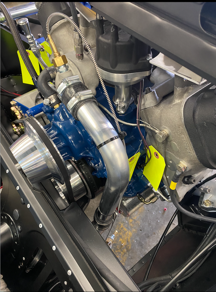

You are using silicone hoses? And many are leaking? Something does not sound right Mike? T-Bolt clamps are actually capable of crushing tube so this really surprises me. Especially a water pump outlet? Good ole hose clamp is all you need to hold pressure.
I am using silicone hoses Lee and yes, and a couple of silicon hose to metal hose connections were leaking. The T-Bolts are retained where I felt comfortable with their placement and had no sign of leakage. There are a couple of locations where I could not get them to seal completely. I think it is due to a couple of factors - they are wider, they require more room to access where I am placing them, and the metal hose provided by SPF had short hand welded beads at each end. I continued to have issues there using the T-Bolt clamps. Removing them and replacing with basic screw bands seems to have worked - I can pull a vacuum to about 24-25in right now.

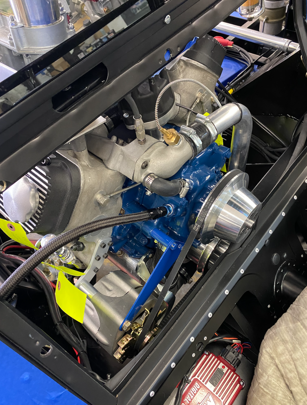

couple of shots of my set up. Making the bends in rigid helps quite a bit, takes the pressure off the clamps
