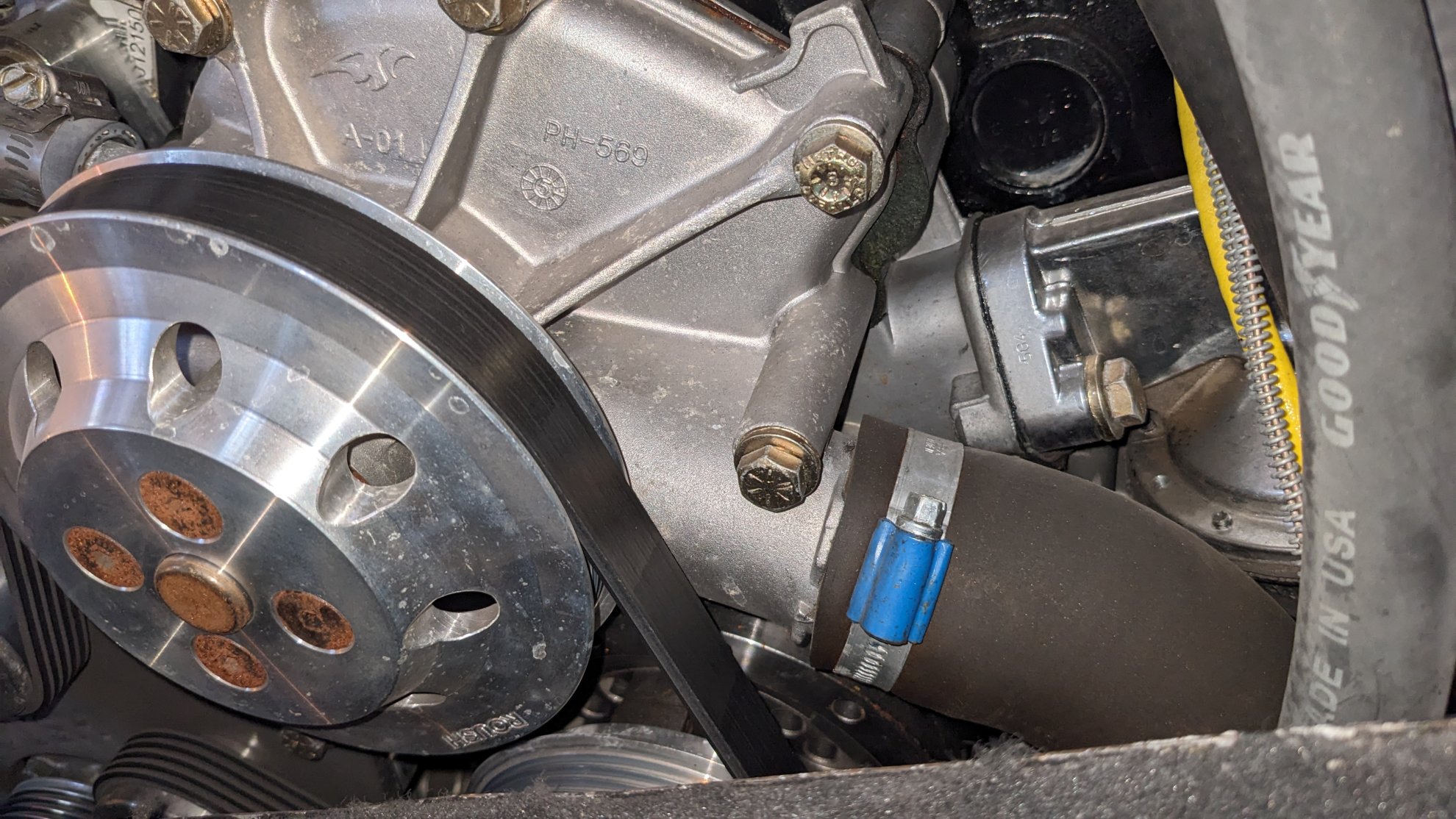

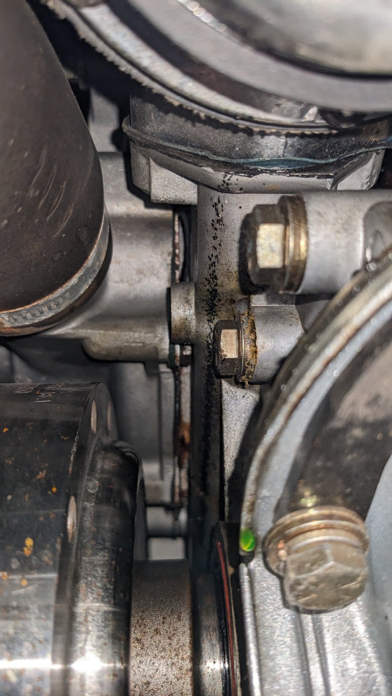

Got back to the car and started by removing the access panels for a better view. I am pretty sure the water pump is weeping on the center lower edge (kind of blurry brown in the below image taken from below on the left side of car). I swee a trail from there down to the green blob about to let go.
I checked all of the mounting hardware, but I see that doesn't do much (most likely) as I need to get to the sealing plate hardware too. That looks hard to do without WP removal. Do I have this right?
I see a part number PH-563 on the front side of the pump and I am seeing partial pump kits online with that part number. Since I can't see the whole pump, am I safe in ordering just this part number or do I need to verify anything else before ordering? Is there a preferred band and/or source to order these from? Sorry, I am more of an aircooled guy and this is a bit new to me! I don't shy awawy from amking a mess though...

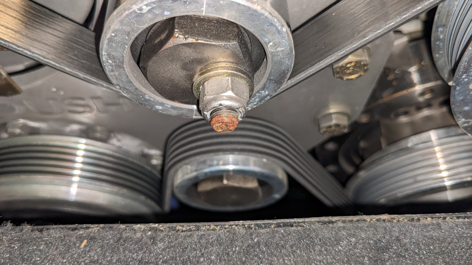

One more Q for now...how do I release tension on the belt? I see, what appear to me to be, two idler type pulleys, but I don't see any spring operated arm to them.

Mike, I’m not 100% sure, but it looks to me like the idlers are on a eccentric. Loosen the nut on the stud and then you should be able to take or remove tension on the pulley. I could be wrong, but that’s what it looks like to me .

I see what you are saying Brian, thanks. That looks fairly doable.
Dave, so does that mean only the hoses are removed and then the attachment bolts for the forward section of the WP and I can deal with the sealing plate gasket outside the car? Is that how this works on this Roush 427SR?

I would agree with Lee's advice Mike. Yes the waterpump can be removed with the firewall off and serpentine belt removed, but best to determine what if anything is causing overheating. Weeping from the waterpump would not cause this,

I just opened the car up for a better view of what is going on and posted here for further advise. Over the last year or two I have lost around a cup of coolant as far as I can tell...a slow weepage from the spot I found today. It is fairly constant. This is one issue and the other is the temp indication issue.
