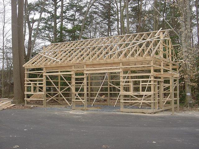

I am in the process of having a 40'L x 24'W x 12'H (w/40'x 16'W x 6'H loft) garage erected, and need suggestions. I HAVE searched for the previous thread, which contained some great ideas, but had no luck finding it, so I'm posing the question again.
What would you include in a new garage??????
Any and all ideas will be considered and appreciated.
A simple list would be great, in order of preference.
Thanks!

My garage has a 12' ceiling (see photo showing 9'H x 10'W
garage doors).
