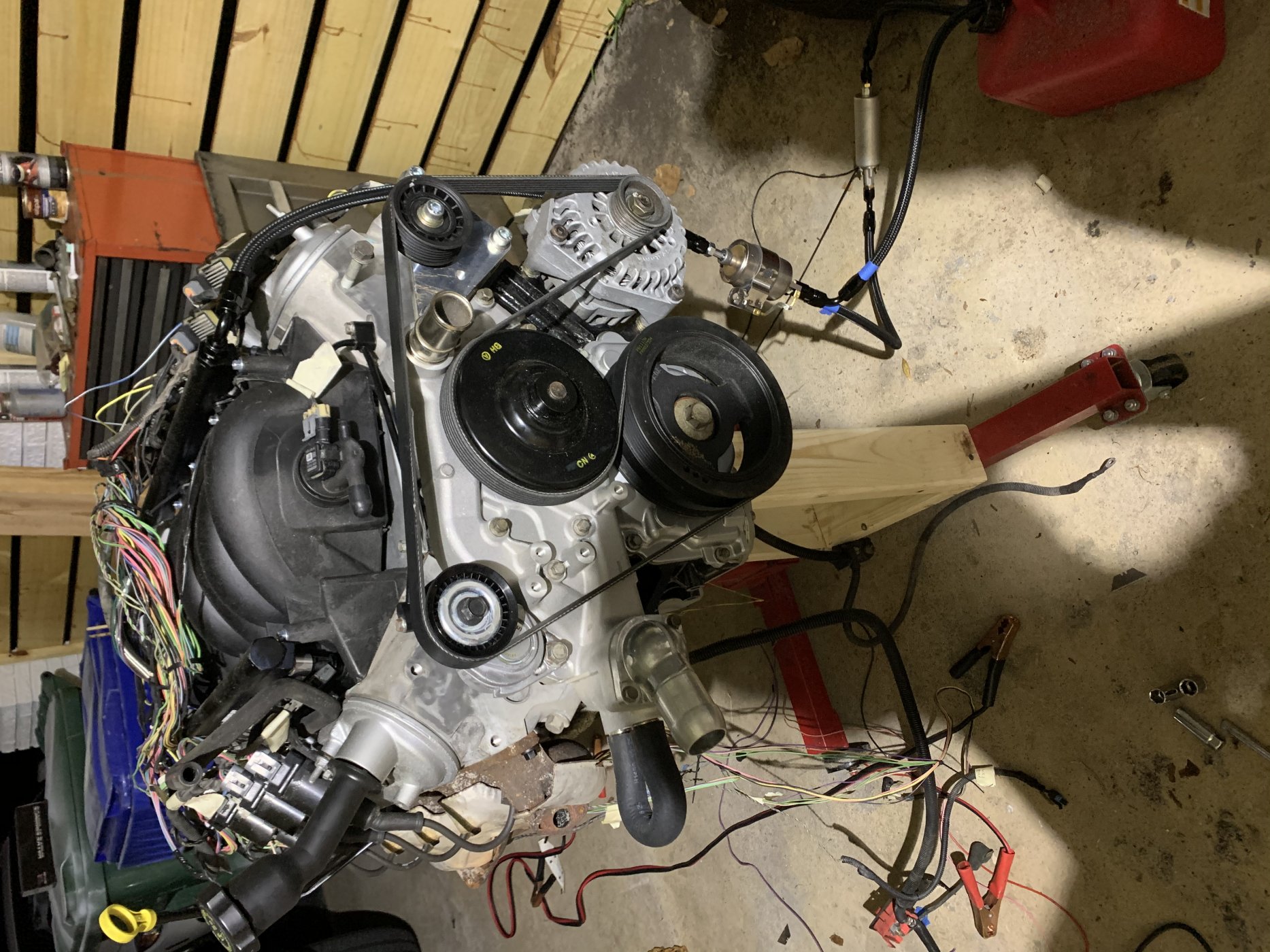

Most of the motor is wrapped up now, just need to crank down the balancer, timing cover and install fuel rails.
If any knows what the giant sensor on the drivers side block near cylinder #7 is? Also need to do something about the oil pressure sensor that is hitting the LS6 intake.

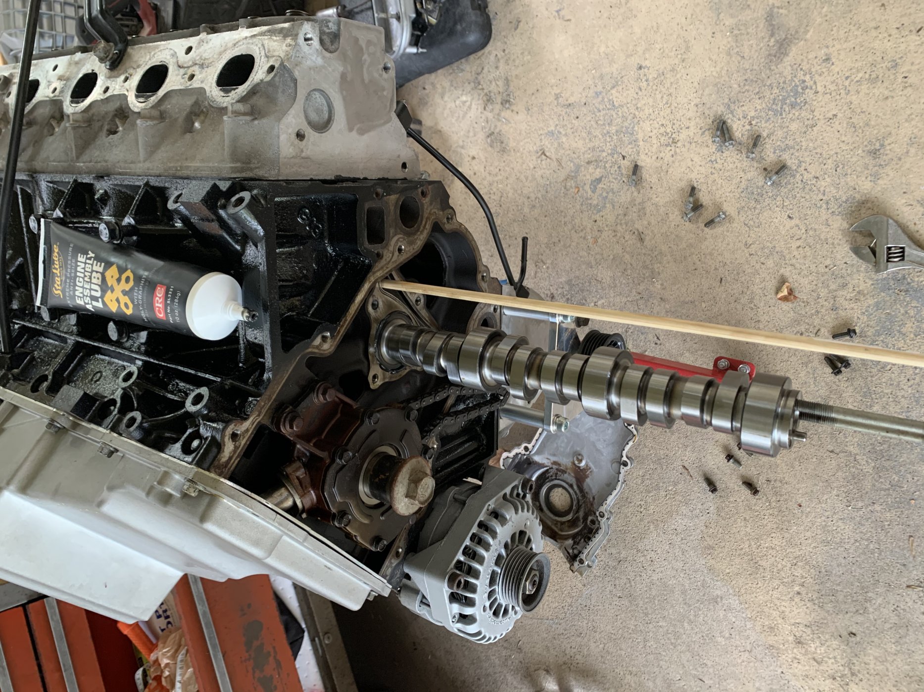

Installed a cam, new springs, new gaskets, deleted the VATs in the PCM, everything hooked up ready to go. Fuel pump and AN lines work with no leaks. However I seem to have a bad starter. It’ll spin the motor over without plugs, but with plugs in. It’ll hit and maybe spin a 1/4 turn and then stop. I have good grounds I believe and the positive on the starter is cleaned. Only other thing I can think of is I’m using jumper cables to my truck and maybe they aren’t providing enough juice.
Mark B.
Try a larger cable. Most jumper cables are only 4 gauge. I use 1 gauge with a small battery and it works great.

Yes sir, I blipped the throttle just a bit and it moved quite a bit. No more of that until I get a stand that bolts to the motor mounts.

That hose that is by your oil fill is for the connection to the LS6 manifold when it was turned around facing typical front. Since you have rotated, that is the pcv connection.
Kyle
Ya for sure, haven’t hooked any PcV stuff up yet because I’ll eventually do a catch can. Also not sure if I’ll keep the ugly stock valve covers.
