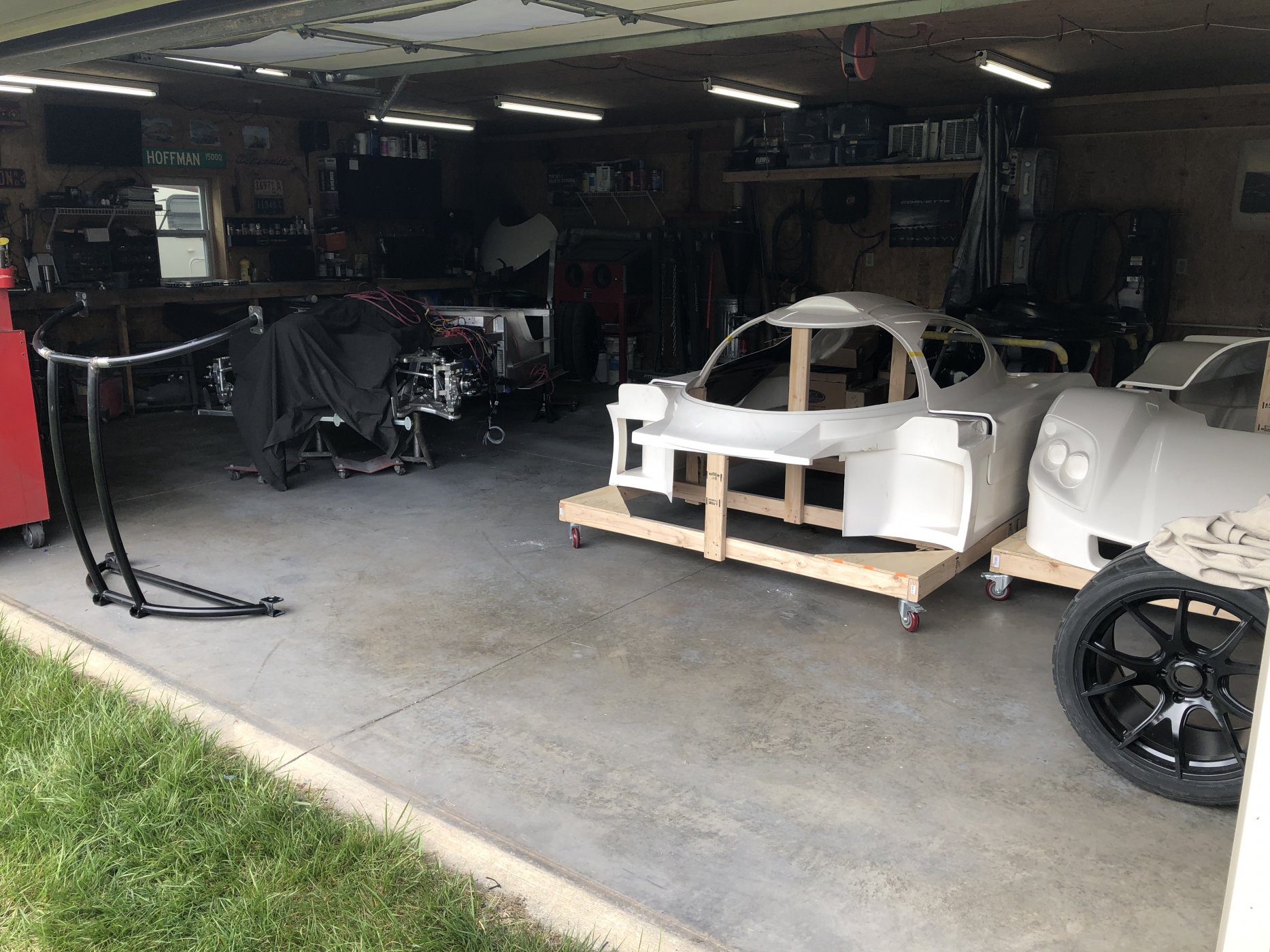

You will need to put the body in storage while you work on the chassis. Unless your garage is tall enough to hang it. I hung the spider and put the rest in storage even though I have a bigger garage. For some reason, my wife seems to think one car spot is hers. And I almost always have another race car in the garage....
It is hard to show in a picture but I brought the GTO and Camaro out of storage today to get all the SL-C parts in my 3 car shop that is out back behind my house. I have the front and rear clam stored on one buck that I built and the spider on another. This will allow me to do bodywork on all three pieces while the are fully supported on the bucks. If you plan to paint you will be sanding, priming, block sanding, and sanding some more. The body is in really good shape straight out of the mold but not good enough for the level of paint work I am going for.
As Frank stated, you will need to put the body as well as a lot of other items in storage to work on the chassis in a one car shop.

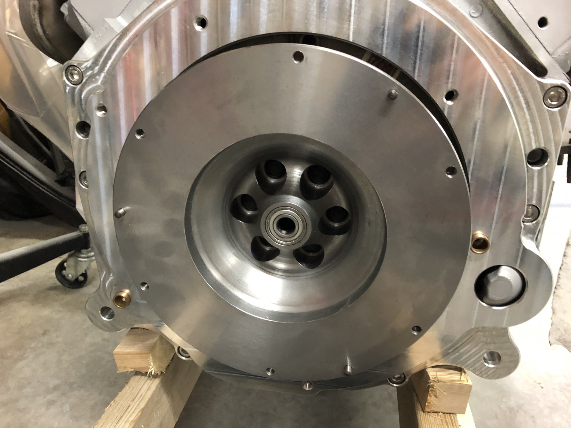

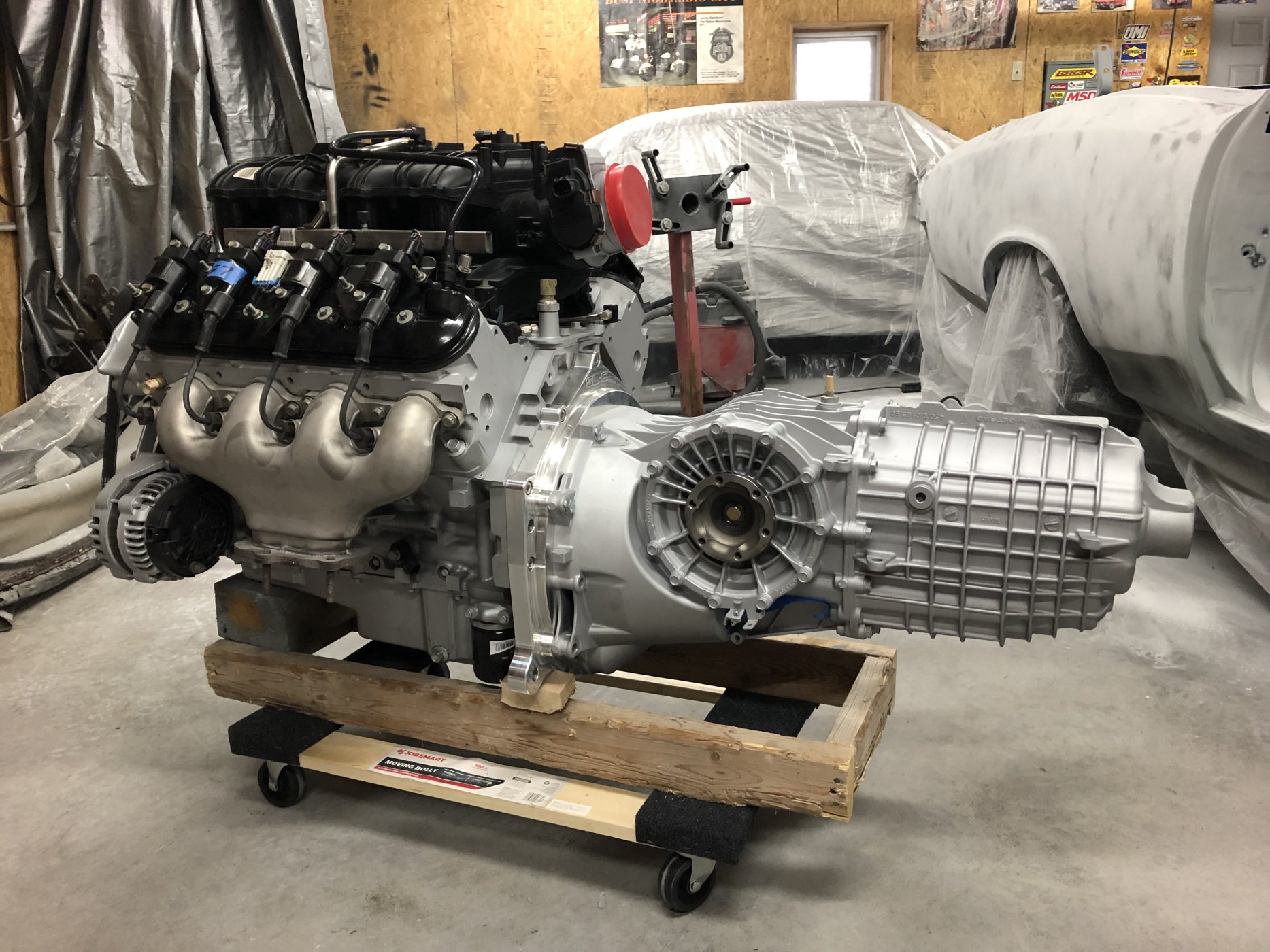

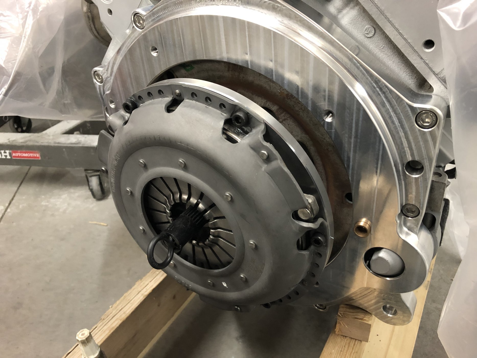

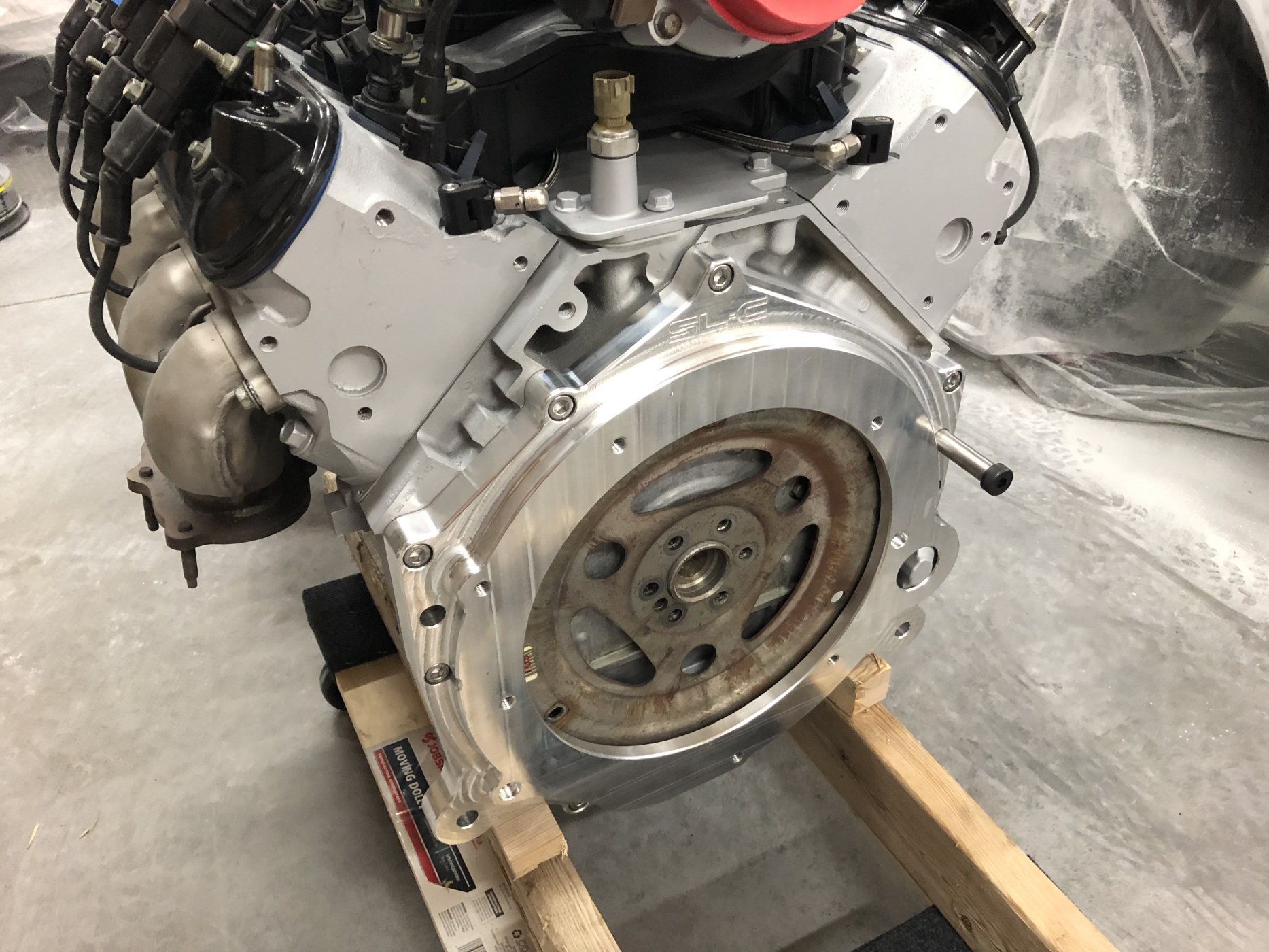

The adapter plate comes with the kit from RCR to mate the G96 to a LS1. The flywheel from RCR costs $495 extra. It uses a stock LS flexplate and the stock LS starter (my engine came from an automatic transmission vehicle so I was all set to go). You will also need a Sachs clutch part number K70246-01 that can be purchased from Rock Auto for $350 (or another source). Here are some pictures of my installation for reference.
Stock GM LS auto transmission flexplate and RCR adapter plate
RCR flywheel installed

clutch installed
transaxle bolted into place
