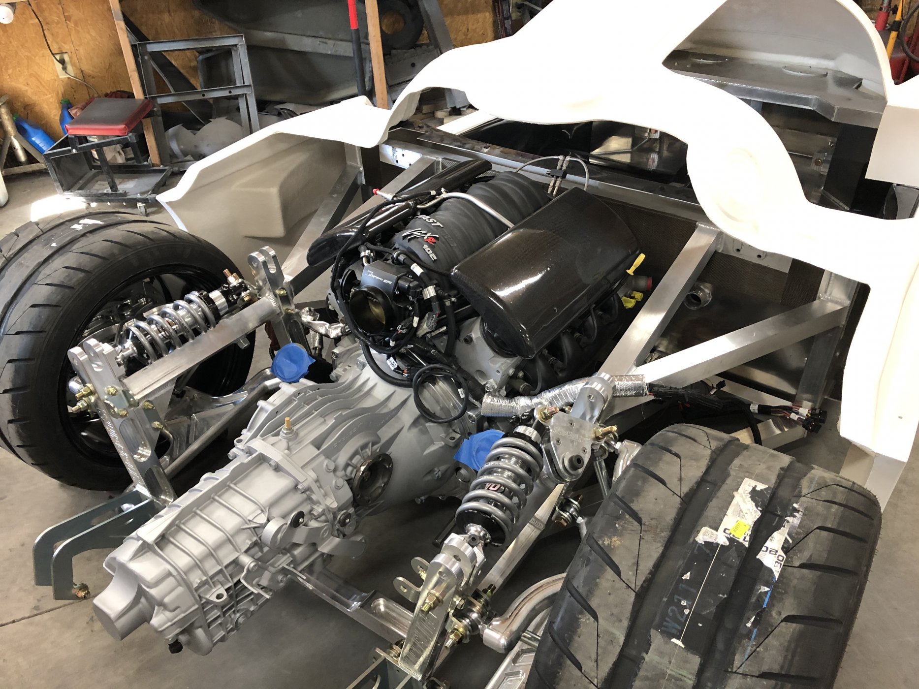

That fitting is the vent I was referring to. You will need to remove that fitting (it is pressed in), tap the hole carefully not allowing any chips to fall down into the case, and plug the hole. I used grease on my drill and tap to keep the chips out of the case. Use a lot of grease and clean it often, re-applying the grease each time. I installed a short brass nipple with red thread sealing loctite into the case. I then installed a brass NPT coupling with thread sealing loctite onto the nipple. This was finished off with a brass plug fitting in the coupling with teflon tape. This way when I need to remove the plug to change the transaxle lube I am not wearing the threads out in the thin walled aluminum case. Probably overkill but better safe than sorry in my book. (I couldn't find any pics of this in my log, if you want a pic let me know)
To vent the case after you have flipped it over, remove the large plug on the bottom (now the top) of the transaxle, drill and tap it, and install a vent fitting. You can see the vent fitting in the top center of my transaxle in the picture below (it is a sintered bronze pneumatic muffler fitting, if I get oil misting out of this fitting I will need to change it to something else).
Let me know if you need more detailed assistance, I'm happy to help out any way I can.

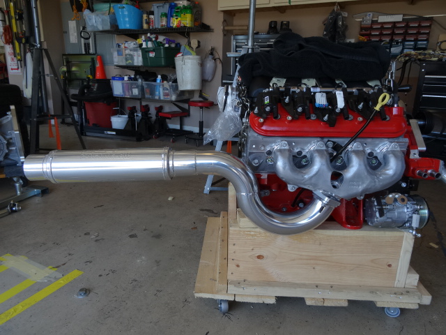

I see lots of people using LS7 manifolds. Any particular reason everyone is going this route? Me personally I don't feel like factoring HP gains on cars like the corvettes are comparable, the SLC have very short exhausts, most of them also with very free flowing mufflers; if any. Combined with the "cold air intake" which is basically a straight pipe to the back of the clam, this should produce very free flowing. From what I know the LS7 headers are heavy. Any reason people aren't going with shorty/hugger headers?
Ken Roberts
Kinda funny. You are using an iron block at about a 100lb penalty and worrying about a little extra weight in the LS7 exhaust manifold. They are stainless, double walled, strong flange, high flowing, cheap and plentiful on the used market. The only reason not to use them is if your engine already came with something different. The LS3 Corvette exhaust manifolds are also packaged well.
Here is a picture of Dan Carters car with LS3 manifolds.

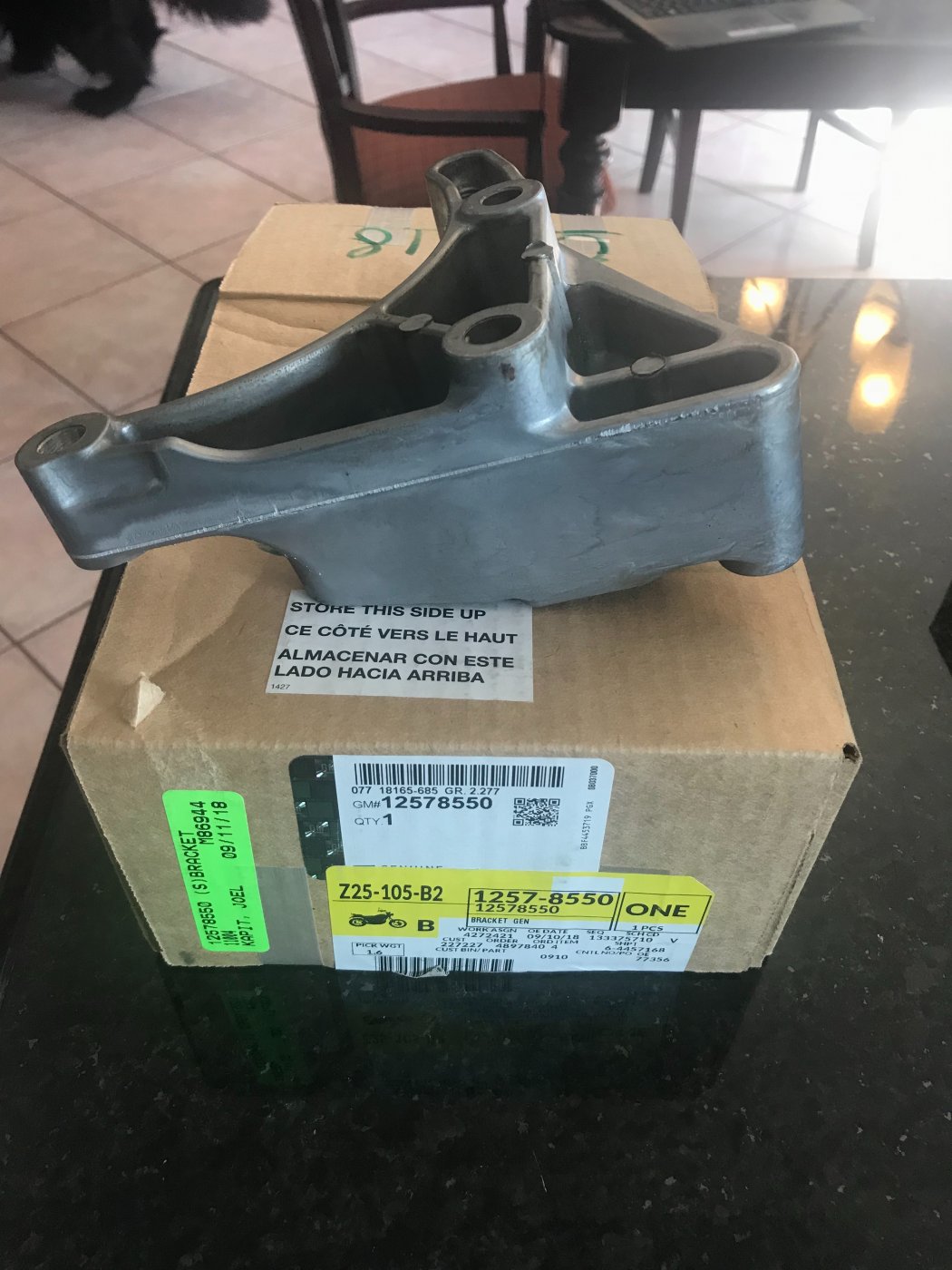

Kyle, you are moving right along. FYI, if you are looking for an LS low mount alternator bracket, I have a new one for sale, 50% off GM discounted price plus shipping.
Also have a few pulleys that are new.
So I just weighed the G96 and it came out as 142lbs, I'm not sure what the graz is, assuming its 200lbs I'be already picked up 50lbs there. I truly am not THAT concerned about weight, but it is in the back of my mind. I was also considering fabrication options, I'm sure someones explored this, but it seems like shortys would give a much better trajectory out of the back of the car. With many of the LS7 headers I'm seeing near 90 degree turns just after exiting the manifold.
