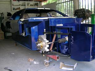

I am taking measurements off the car to produce a spaceframe and looking to incorporate upper and lower wishbones and the front and rear but keeping all the measurements the same if possible - just out of interest really at the moment. I like the body of the car but the chassis etc is a bit 'old skool' really although fairs quite well but I think a bit of a modernization program is about to start....will model the spaceframe in a modelling program first I think and then look to get one made if it stands up to finite element anaylsis.....

Here is some pics of my chassis & suspension
