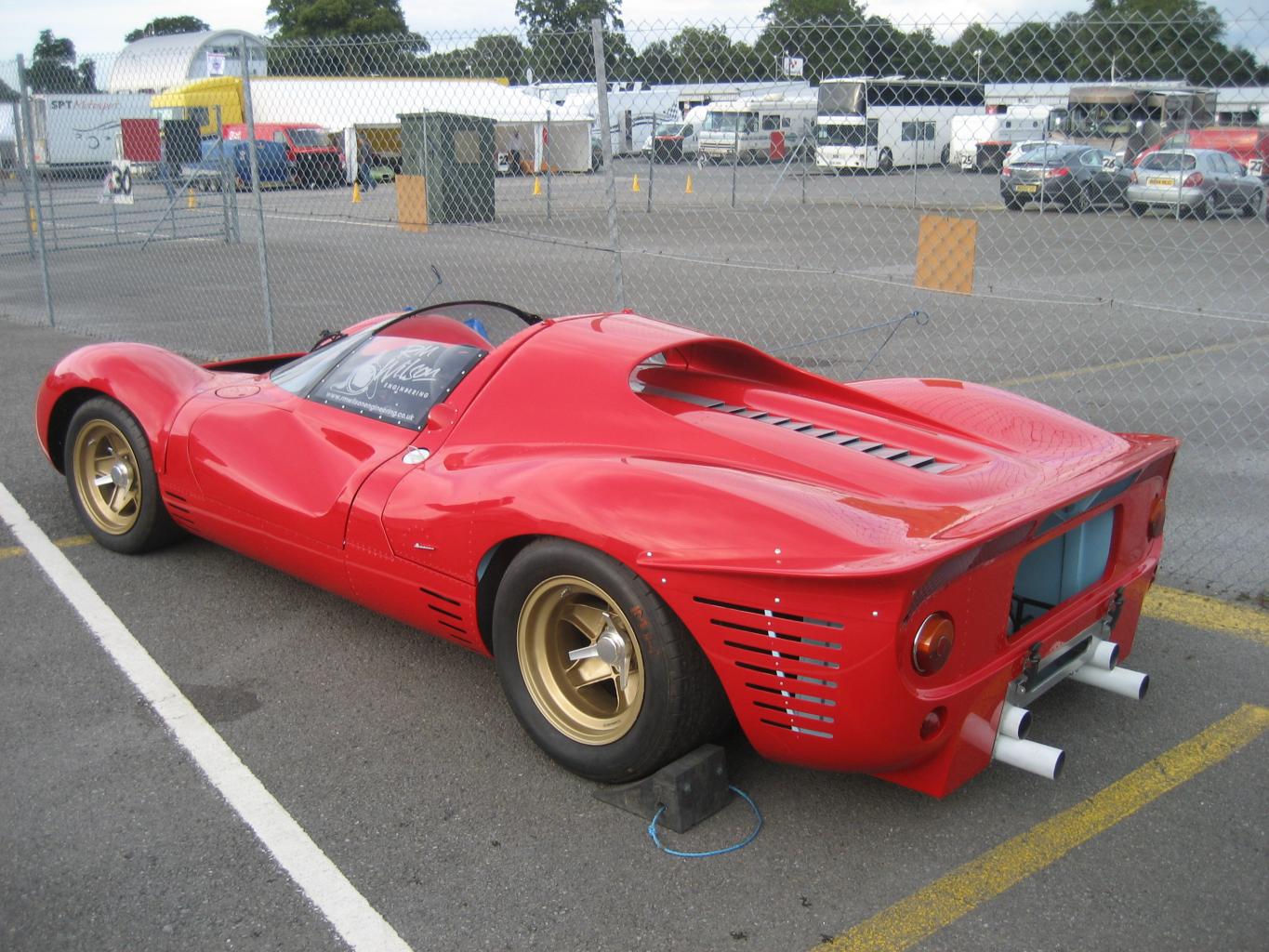

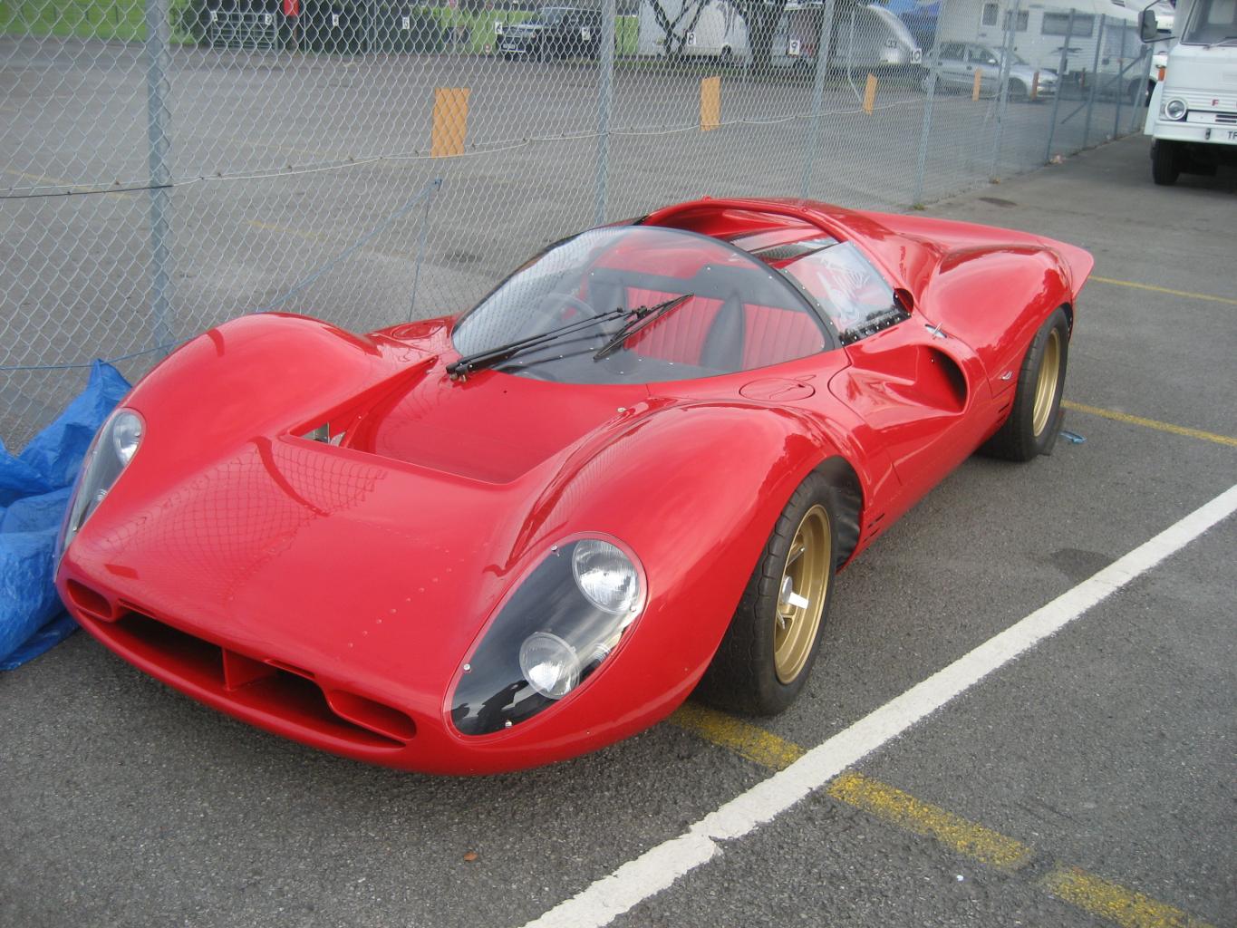

If I didn't have a GT40 a P4 is the shape I would pick. Here are a couple of pics I took last year at the Oulton Park historic meeting. This car was in the paddock but not racing. I could not find the owner to ask about the car but it seemed to have an alloy body and the go bits were all Ferrari with white exhaust pipes- very nice too.
