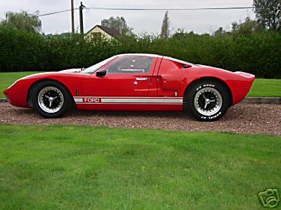

4. One of the wheels is missing a dummy spinner, picture attached. There is no makers mark on the rim. The spinner is attached by micro allen screws which grip the centre hub lip. Does anybody know the maker and whether I might find a repacement.

4. you can get the dummy spinners from Image Wheels 0121 522 2442 Unit 3, Fountain lane Tipton, West Midlands DY4 9HA
