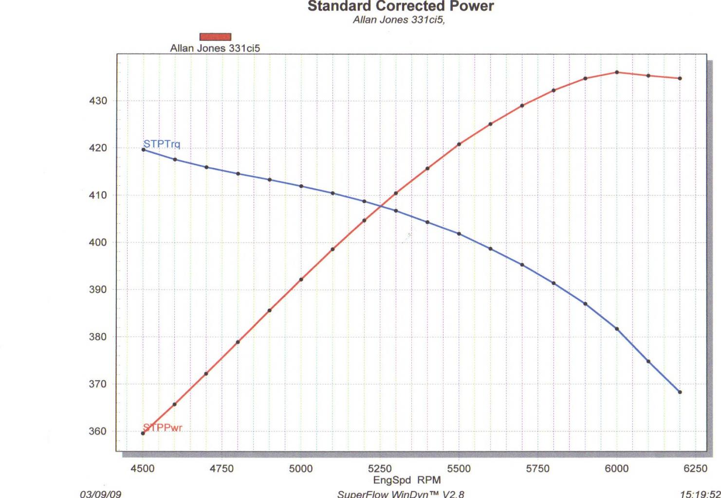

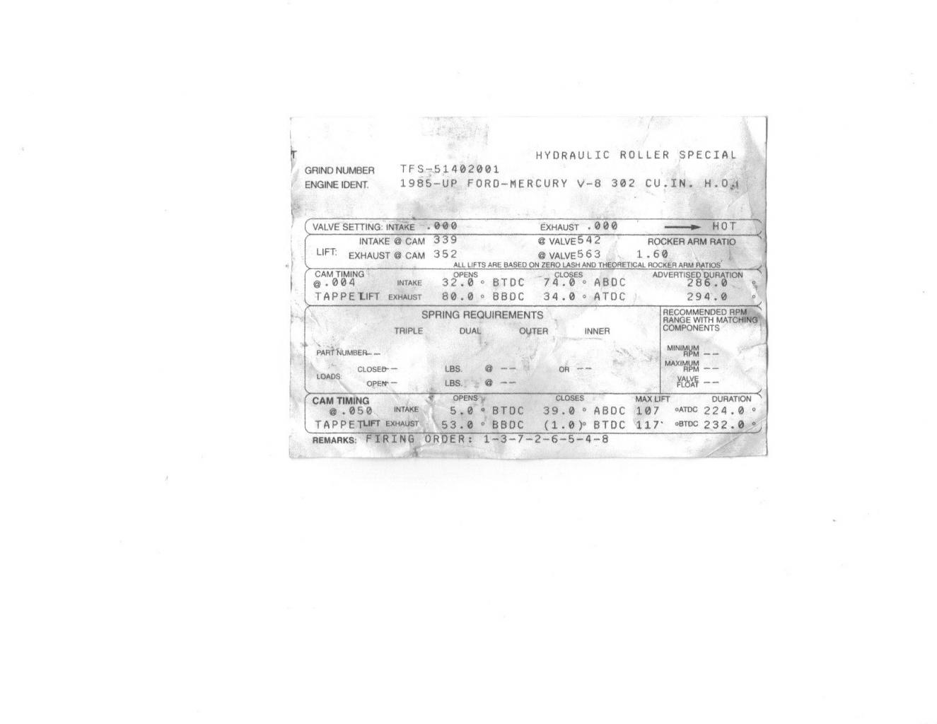

If you do build a motor that is not a pure race engine (pump gas motor) then I would build a hyd roller cam engine because the oil available nowadays is pretty much no good for flat tappet cams. Google ZDDP oil additive and you can read all about the problem. Hyd roller lifters are heavy and so they limit engine revs to about 6500 RPMs and with the compression ratio held to pump gas specs of about 10.5 to 1 you are again not going to be making any more power at about 6000 RPM. Look at the above dyno chart.
By the way that engine is Perfect for a ZF and a GT40. Just do that. I bet that combo would last 10 years + with oil changes. Not stupid money either.

Howard - That motor in the dyno chart is an upgrade from the standard Keith Craft crate engine with street civility in mind. It had a 1" 4 hole carb spacer/isolator added after delivery from KC (on their advice) for a bit better mid range response. It has a Canton 8 qt road race baffled oil pan, MSD ignition, 10.1 comp ratio, forged pistons, Scorpion roller rockers, steel crank (balanced assy), TFS hyd roller, and Edelbrock Performer RPM intake on AFR aluminum heads. I included this info for perpective on a comment on the carb you mentioned. I think the 750 Holley would be a bit much unless you swapped out the cam for a more agressive one. This engine has a Quick Fuel 680 and the carb, the manifold and the heads will all flow more than the engine used at peak hp/rpm according to the flow numbers and efficiency info furnished by KC (which I didn't post). Just a switch to a different cam, using all the existing components will net an increase, making a 750 cfm carb unecessary. In fact, you might soften the low end response without appreciable high end gain. With a nasty cam in there and possibly an Air Gap or Victor manifold the big Holley would work well but you will lose some streetability. I thought the engine was a good deal at $8400, w/break-in and dyno test. Some might disagree I suppose. As you said, not 'stupid money' and it will have the minimal maintenance longevity you mentioned. Thanks for the 'perfect engine for a GT40' comment. I talked this over at length with the folks at KC...car weight, intended use, etc and this is what they came up with.
