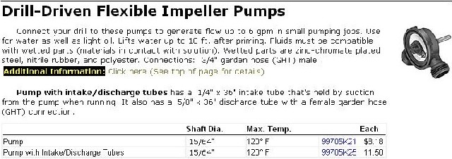

I've used these electric drill driven pumps with great success to suck tranny fluid and even diff fluid. They self prime fairly easily, and they can usually be found for $10 to $15. Their ports are standard garden hose, so any hardware store has adaptors.
John

Thanks Bob, This box has NO plugs suitable for draining, and If we do ever dismantle it then we can follow your advice. The box is just rebuilt with new oil, so I hope it will be a little while before we need to do that. Frank
