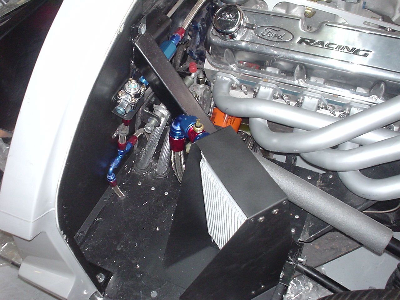

Here are some of the pics.
Here is the ledge. The old sheet metal went from the upper edge to the lower edge along the line of the engine block. This was cut out and the right angle pieces were added. 7" high by 5" deep. If yours is close to this you won't have room to get your hand up there to do any work. Removing an oil filter on these setups is rather messy and you need the room to work. Original sloping panel.
New shelf
Looks roomy til you try to add something.
Changing the fuel filter is a B...h without pulling the engine. Had the high pressure pump quit on me in traffic one day. Got it home and pulling that to get the piece of trash from the fuel line was no fun at all.As you can see from this pic there is no room to get your hands down beside the engine. there is a little room at the bottom but you just can't maneuver around.
Here is the oil filter arrangement.
Looking at the pic I realized I gave the wrong information. The adapter has 4 openings. two in and two out. The in is the oil from the engine and the line out to the oil pressure gauge and the lo pressure switch. The other side has the out from the filter to the thermostat. The last opening goes to the second thermostat that controls the fan for the oil cooler.
The thermostat is located below the filter adapter it has 4 ports as well. in from the filter and in from the cooler, out to the engine and out to the cooler. It operates the way I stated it. I also added a one way valve that is between the oil line from the cooler to the thermostat. This forces the oil exiting the thermostat toward the engine, and it keeps the oil(high pressure) in the Accusump going toward the engine when it detects low oil pressure.
Here is the bypass switch for the lo pressure oil switch. It is covered by the door jamb when closed. this switch has been swapped out for a momentary switch. The door would not close with this one on, and it doesn't press the switch when closed.

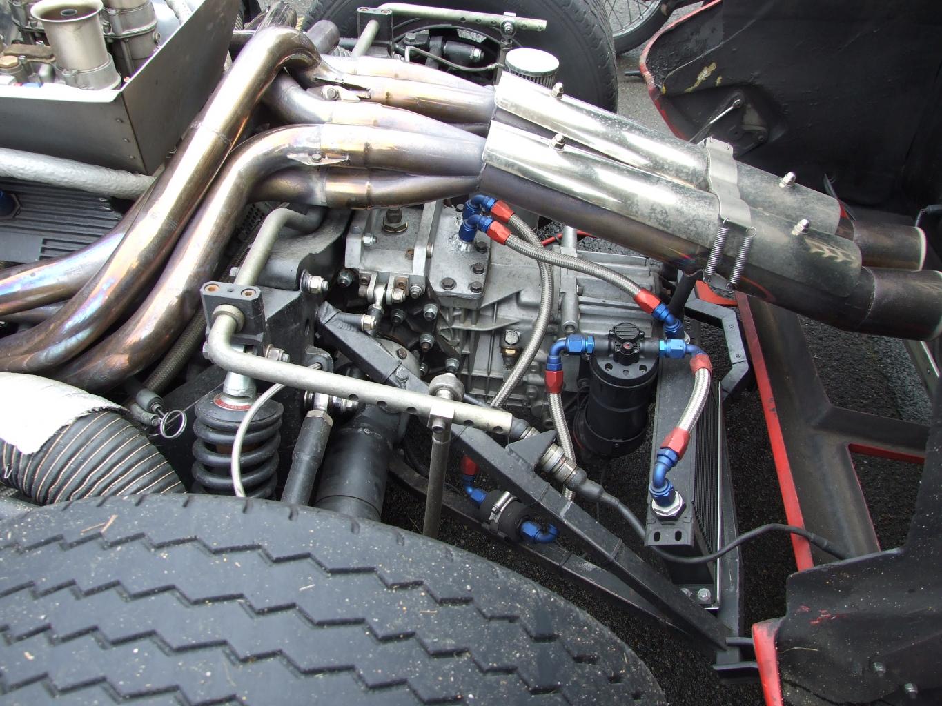

FWIW, just an another way of installing oil cooler on rear... The later Gulf cars were had oil cooler in this area.
