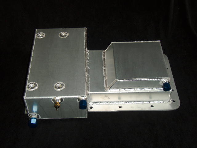

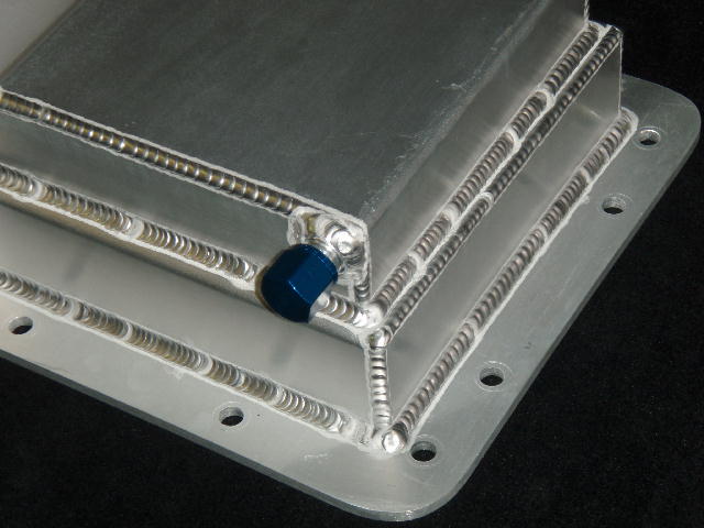

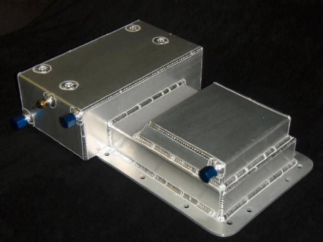

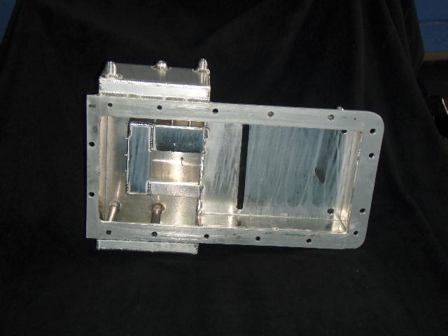

After searching for some time, it was decided to make our own. It halds 15L, it has baffles and gates, it fits perfectly and the quality is with the best of them. The sump is for a 4.6L MOD motor going in RF134.

Very nice job Bobski....
My next purchase is a TIG welder..
Is there room for a windage tray?
Hey Randy,
There is plenty of room for a windage tray, and we are using the standard windage tray that comes with the 2001 Mustang Cobra motor.
Regards
Bob.
