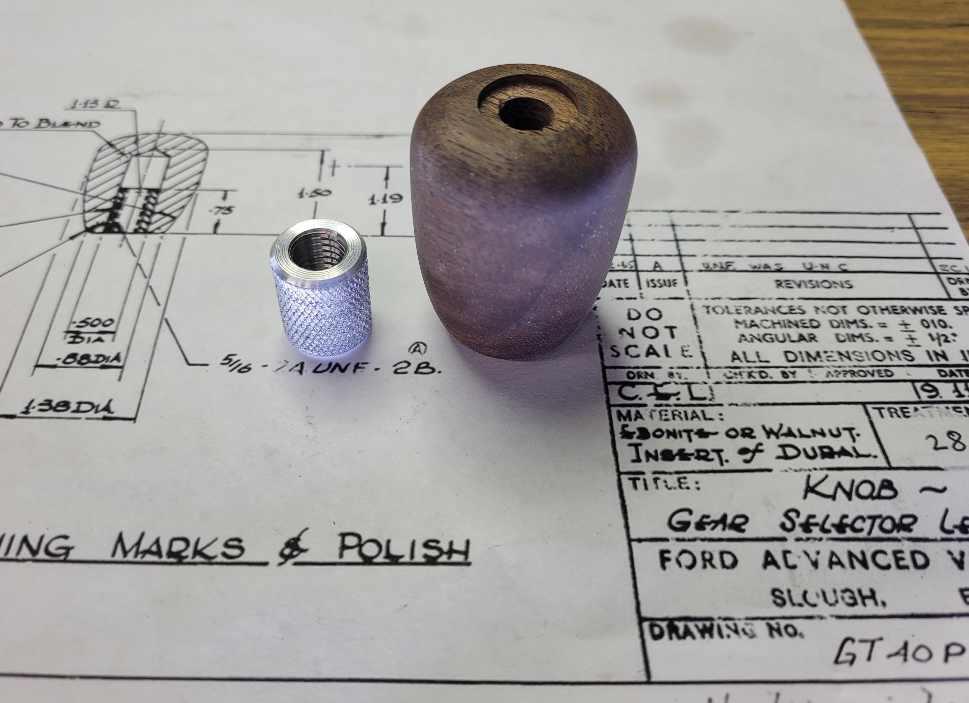

Original FAV GT-40 shift knob drawings.
Mine.

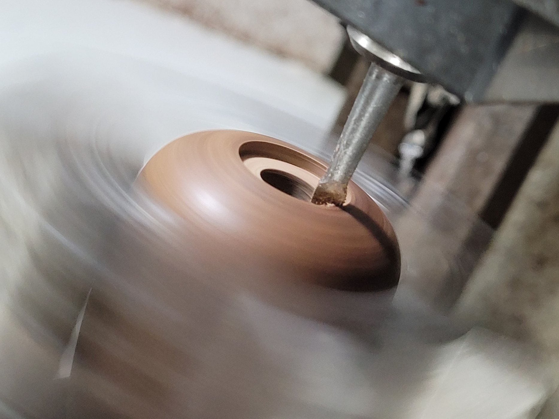

I finally got around to making my first shift knob yesterday. I was surprised how well my metal lathe worked as a wood lathe. Now that I know I can make one I have a nice piece of burl walnut I'd like to try. Hard to believe the tiny carbide boring bar is supposed to cut steel. The insert I turned out of aluminum and SPF's shifter uses a 10 mm 1.25 thread. I'm not sure why this sites software turned the 2nd picture 90° to the left. Can anyone tell me what to do to fix that? The original FAV blueprint calls for Walnut or some other kind of wood. Can someone tell me what the other wood is? I don't seemed to be able to understand it. You know it's how you Brits talk over there. Soooo just kidding I loved my time in England and you guys built one hell of a car.

Richard,
The other material specified is not wood.
"Ebonite" is a coal / hard rubber derivative material much used in the making of bowling balls, smoking pipe stems and quality fountain pens years ago. It is still produced in Eastern Europe.
Usually black but oxidises into a brown colour.
Polypenko is a black modern plastic which machines just as well. This is used as a replacement for ebony or blackwood wind instruments these days. Scots bagpipes for instance !!.
Peter Barnes

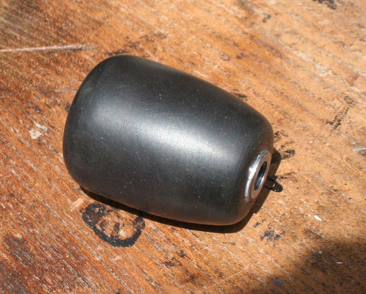

My Morris 8 restoration was missing a door handle knob made from Ebonite. So I bought enough to make a GT40 knob too.

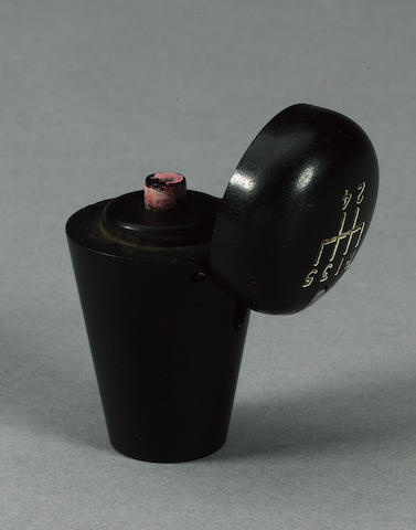

I was going to go for a DB5 gearshift knob....
and and original sold for.... £41,100 !!!!!!!!

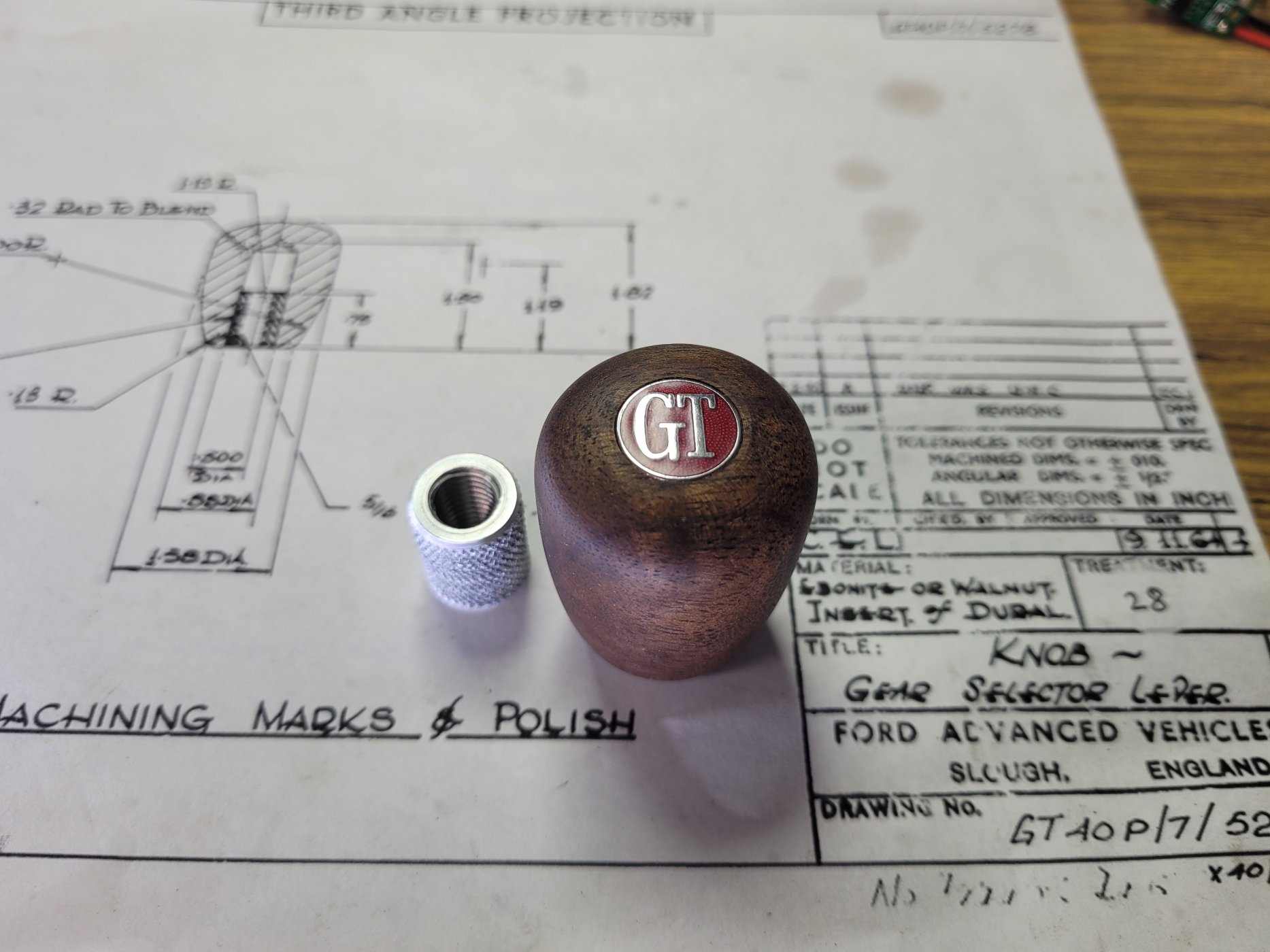

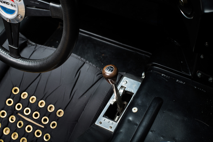

Thought I'd share another picture of my knob but this time with one of JimmyMac's amazing GT emblems. Thanks James.
