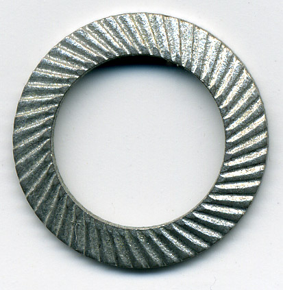

Hey Guys, This past weekend I went to a Porsche place in northern Georgia. While I was there one of the mechanics noticed that some of the bolts that screw into the transaxile were loose. To say the least I was very suprised that they could loosen like that. Come to findout that CAV sent me an E-mail about checking these bolts periodicaly and tighten them as necessary. The mechanic gave me a set of 12 washers that he put on and torqued them down. If I had waited longer my drive shafts would have seperater from the 016 getrag. You can get these special washers from a Porsche dealer in your area. I don't know what they are called, but they have grooves on both sides that grip into the head of the bolt and the metal part that connects to the joint that connects to the plate on the transaxile. I'll try to put a picture of one here. He told me that they were 15 mm. Joe /ubbthreads/images/graemlins/blush.gif /ubbthreads/images/graemlins/blush.gif

Does any one know what these bolts should be torqued to? They torqued the Porsches to 55 lbs. They torqued mine to 40 lbs. because the didn't want to strip the threads since the plate that the bolts screwed into is cast iron. Joe /ubbthreads/images/graemlins/confused.gif
Thanks Bill, What color do you suggest? I was told to use red, but if I need to take it apart it can be very hard to do. These washers are suposed to work very good without making it permanent. Joe

You should replace these bolts with HT studs and secure the nuts with wire or cotter pins for security.
