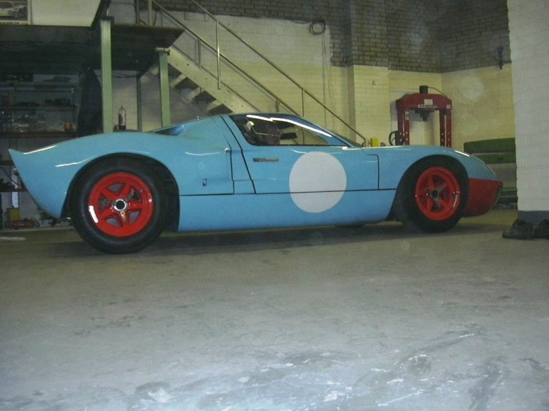

Attached is a picture of 1008 in one of it's identities in Gulf livery. At present in Mk11 guise it is on a set of Vintage wheels Halibrand type.
Period pictures in various books from 1965 show 1008 with borrani wheels.

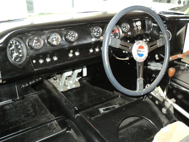

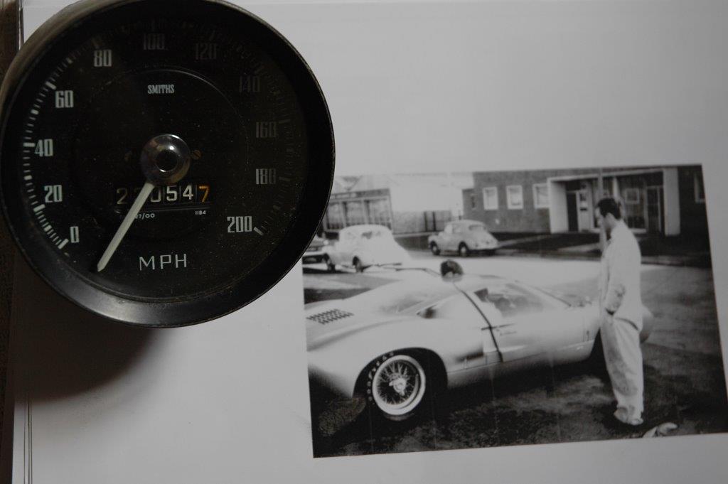

The speedometer you see in the dashboard shots is a reproduction Smiths-GT40 gauge from GT40 Gold Parts in the UK. However, after discussions with Dave Brown, it's been decided to replace it with the original speedo from GT40P/1013, the Ford press car, which featured in many motoring magazines in the mid 1960s (see separate photo).

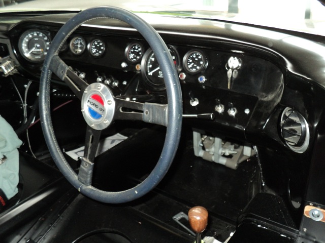

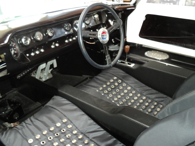

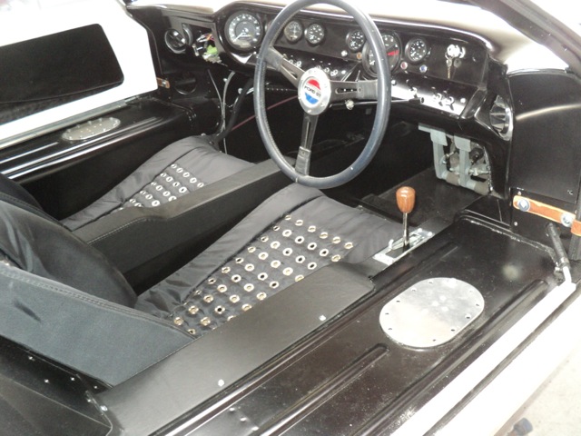

Well, at last, some news. The interior is almost complete, the motor has turned via the starter key and the electrics are finished. Final job is hubs, shafts and wheels fitted! It will be back in the UK next Spring, it will, it will.. I think!

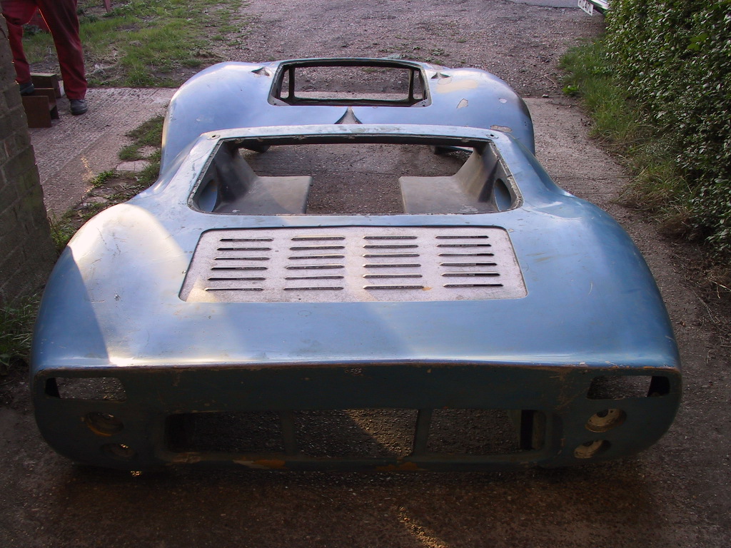

Hi Mike, to recap- GT40P/1042 was consumed by fire at Monza in 1968 (see photo). That car was rebuilt and according to Ronnie Spain's 2000 edition, it's always been resident in Italy. However GT40P/1042 was owned and raced by Belgium racing driver Jean Blaton in the 1980s and 1990s. This car now lives in France, and is a well-known GT40 in the classic racing circles. It is painted red with white stripes. I have no idea if someone like Sbarro has had anything to do with the confusion. All I know is that the Blaton car was rebuilt by Chris Chilles in 2000. The parts of my car and papers stem from this car, but my VIN is P/1042. As I am trying not to get my GT40 confused with the "original" GT40P/1042, I have concentrated upon the history of the bodywork which came off GT40P/1001. That car was Essex Wire white with red stripes, then green stripes when Sid Taylor owned it in 1967, then yellow when Andrew Cox owned it from 1968 Etc. The car in the previous photo is 1001, hence yellow. Please look again at the restoration photo below for all the old colours unearthed when the body was rubbed down and you'll see that yellow. Hope this helps.. Andrew
