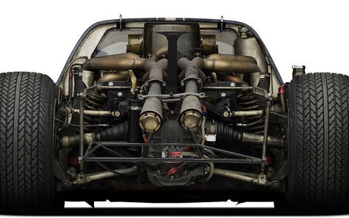

We all like pictures and attached is J8 showing the axle angle with a T44 and FE. They all have something more then perfect.
I'm going to make what I have work.

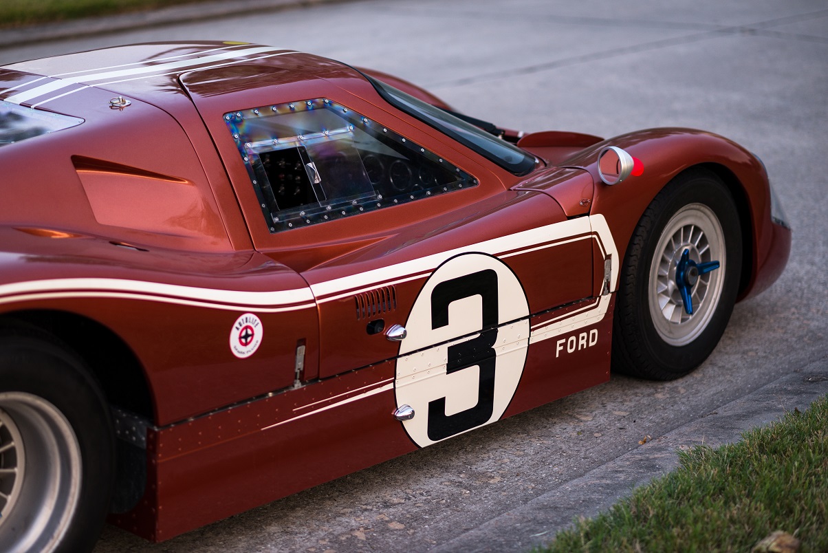

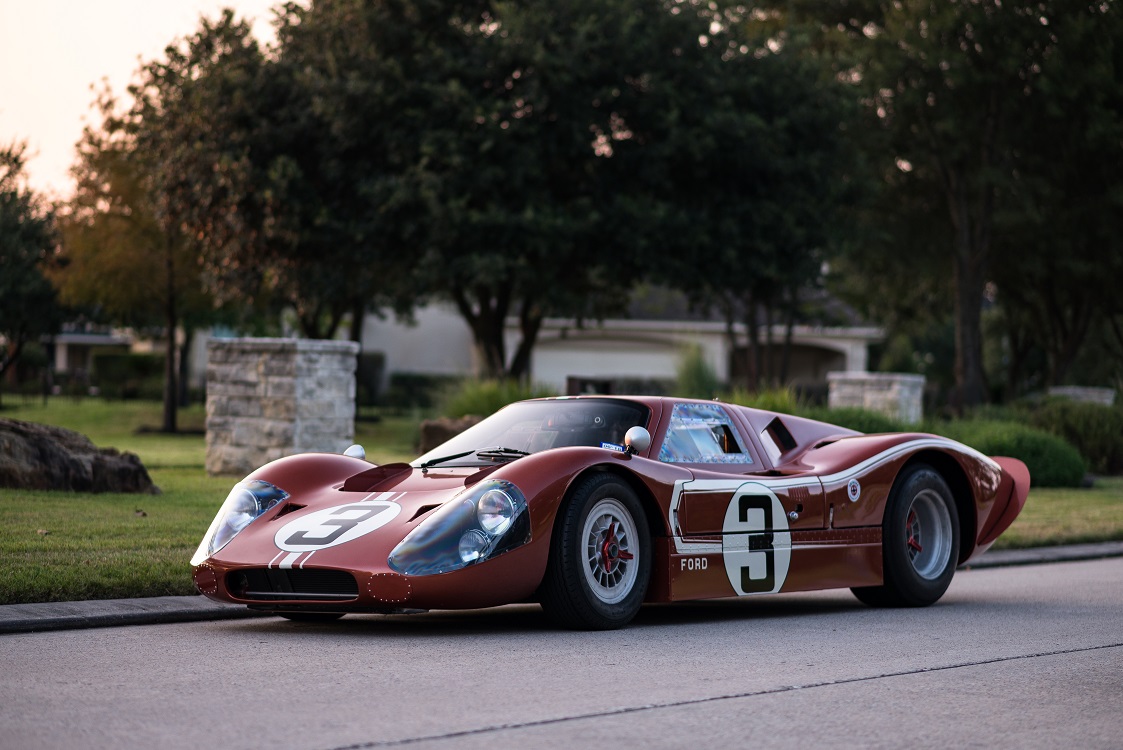

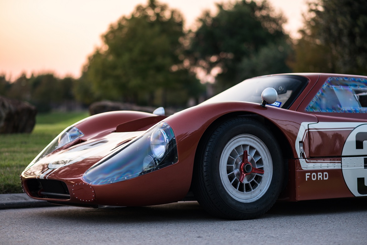

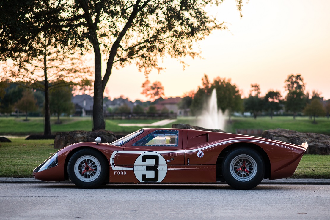

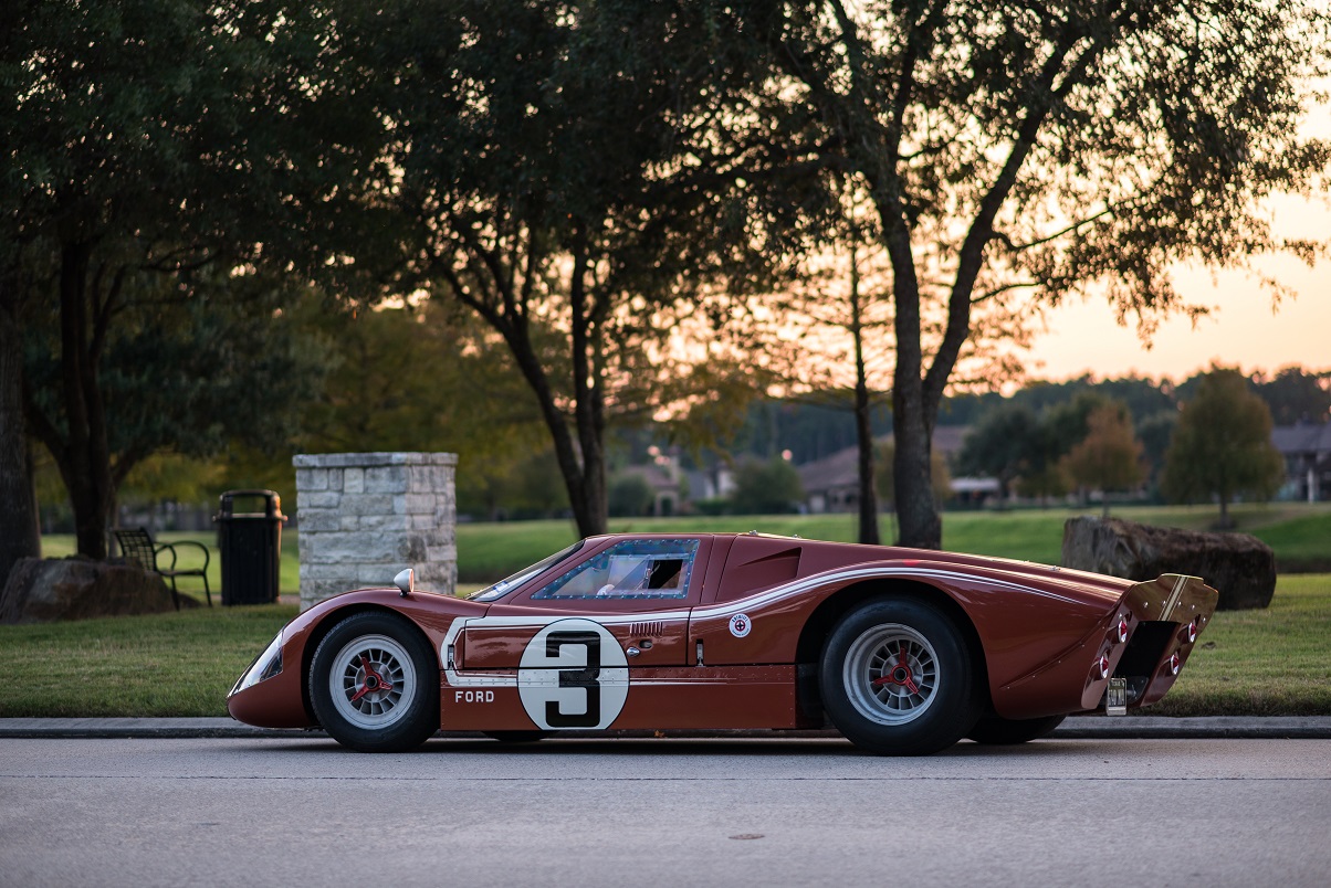

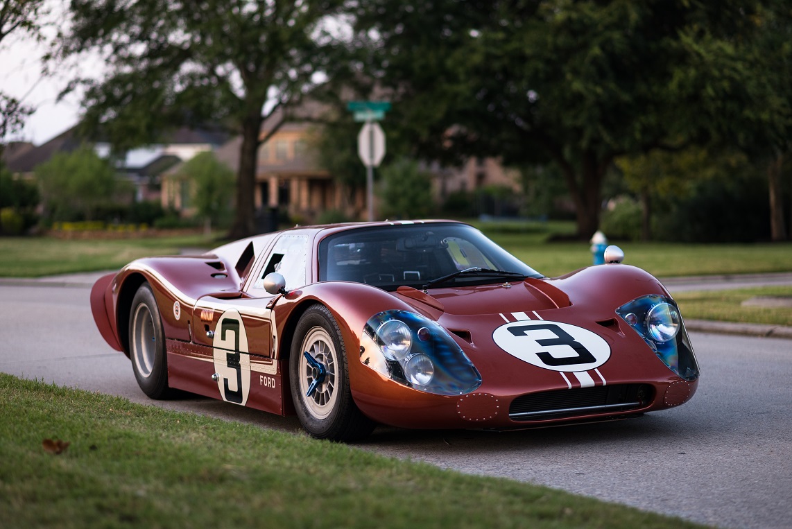

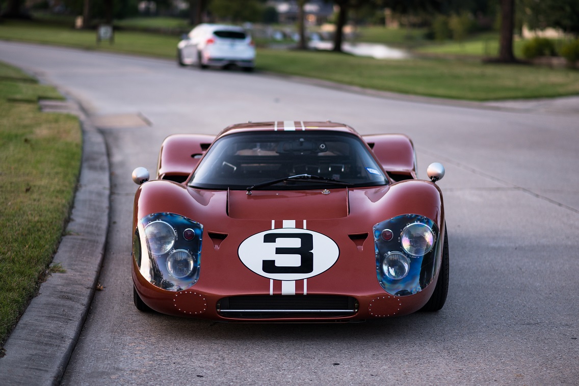

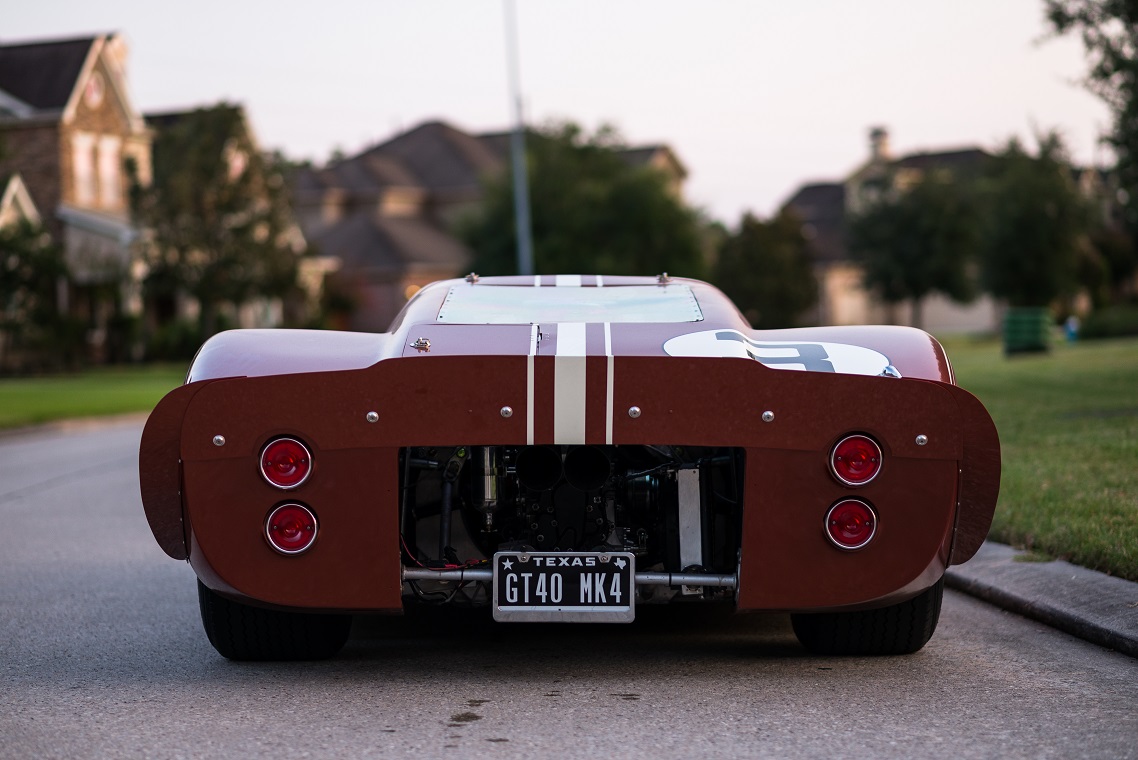

Car is back home and looking great. It's at the final ride height and I'm glad I installed the power lift kit, damn it's low!
Interesting thing happened on the way home. I turned in to my neighborhood and it stopped running. The way it sounded it was like turning off the key. I thought I flooded it trying to get it started so decided to wait it out. It just happened to have the sunset. fountain and my house in the far background. So I made the best of it by taking some pictures. One of the little boys in the neighborhood would always ride his bike over to the house while I was building the car and always ask if he could take some pictures when it was completed. He is driving a car now and just happened to drive by while I was waiting for sunset light. He ran home and got his camera and he's not bad taking pictures. Much better than those fussy iphone pics. He gives me his card so I can email him for the pics. Alex Bouckley, Creative Media Specialist, McLaren Houston. The kid will going places.
The reason the car stopped running was a fuse which powers the coil and fuel pump relay. Fuse looked perfect in the car but was only passing 0.48 volts? Took it out and tested with a ohm meter and it had a high resistance. Replaced fuse and the car runs and I drive it home. I'm checking all my fuses. Very strange!
Enjoy the pictures I'm enjoying the car.
Don

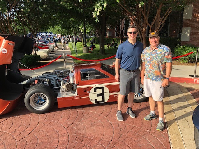

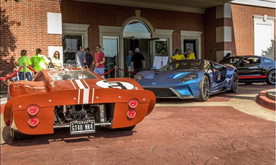

Update, Took the car to 9th Annual Shelby car Show held in Plano, Tx. June 9th and had a great time meeting the Shelby family. S.C.A.T. members are very friendly and fun to be around.
I have attached some photos of the car show. Arron Shelby, Carrol Shelby's grandson really liked the GT and we took pictures in fromt of my car and his car. Very cool!
Planning on being at Coffee and Cars in Houston on the 7th. It was hard to build but lots of fun to drive and show it.
