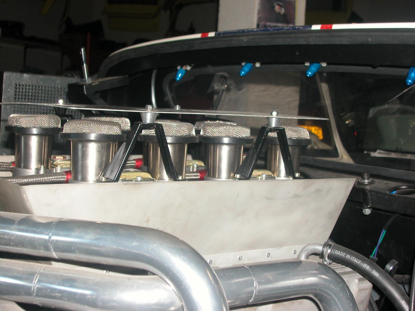

I would put the nozzles at the source of ignition (not far from the distributor) and/or by the source of fuel...

I placed mine on the firewall on either side of the engine. The spray pattern covers the complete engine compartment. The third is in the cockpit, drivers side.

I had devised a very neat arrangement, mounting them on the firewall above the bulkhead window, facing back into the engine bay, to find that (A) they foul the rear clip, and (B), they spray straight into the rear window area. Not very clever!

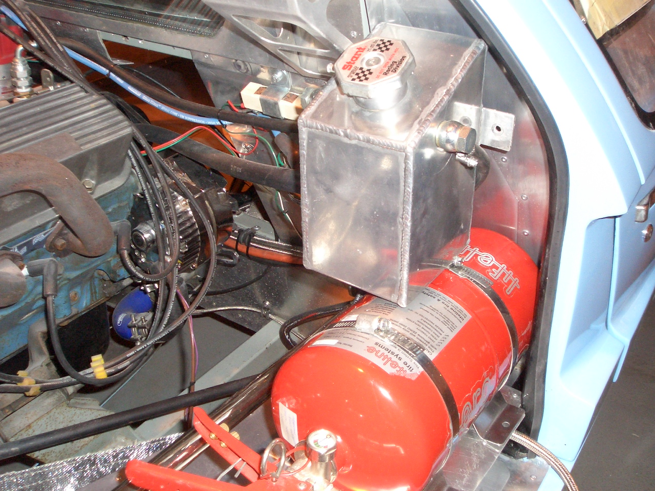

I've just had a very depressing conversation with Lifeline re my 4.0 litre extinguisher.
I'd planned to mount it on the RHS of the engine bay - An ideal place, almost made to measure, and I thought I had seen loads mounted there.
However.........The extinguisher operating temperature must not exceed 60 Degrees. Apparently Lifeline have just had one back with the end blown off.
Also, I understand that the extinguishant also breaks down above that temperature.
They suggest boxing in the extinguisher as well as fitting a heatshield, and using temperature sensing stickers to monitor the bottle.
Has any anybody got any experience of all this?
I was just about to fit the plumbing!
Looking foward to seeing what everybody else has done.
Financialy, I'm not really in the position to change it for a smaller bottle.
Cheers,
Geoff.

One nozzle facing driver from front, one on rear bulkhead facing forward to driver p high. 2 in engine compartment, 1 facing the distributor / carburators from high on the firewall, and one facing directly at the fuel pumps / filters / regulators.

I've done some digging around, and found a thread back in 2003, where there was an enquiry as to where the bottle was fitted on the Roaring Forties.
Robert Logan states that they mounted the bottle exactly where I want to mount mine.
Does anybody running an RF have any comments??
Is there ANYBODY out there mounting the bottle on the RH sill in the engine bay??
Hoping to hear from you.
Cheers,
Geoff.

Geoff,
Yes, that's where mine is located. Frank Catt put it there, where it's in the airstream coming in through the side intake.
Will post pics soon, when I next take the car out of its Carcoon.
