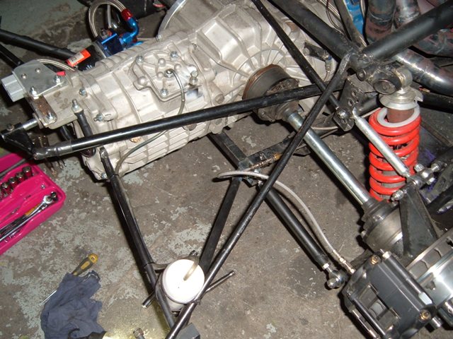

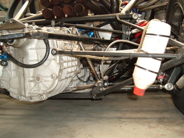

Also, wouldn't mind seeing some pictures of some breathers and catch cans on 930s. I've got some good ideas of how to make one, but I like to see what others have done too.
This is my breather Ron. Works a treat. Catch tank is nothing special but is easily drained! Although it only ever has a teaspoon full in it.
Unfortunately I didn't do any photos of it at the time I built it. Will whip it off and take some close ups tomorrow if you like.

Hi Russ,
That looks just like our other breathers - an empty can of your favorite beer, some hose, zip line, and you are good to go.

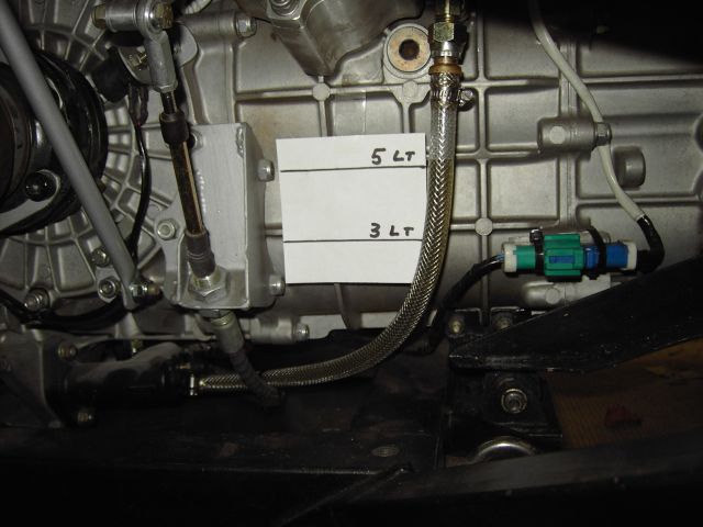

Here is the G50 transaxle fill picture I was after. Looks like 4-5 quarts would be a good fill level for a system with no trans a cooler. Credit goes to Dimi for the photo, the thread can be found here:
http://www.gt40s.com/forum/gt40-build-logs/21100-dimis-build-drb-68-a.html#post290061

I'm curious how the tubing used withinstands the heat and exposure to petroleum products.. Most Vinyl will harden and crack with exposed to both..
Is this some sort of special tubing?
Thanks for digging up the picture Dimi!
Dimi Terleckyj
Hi Randy
I have now driven the car for 14000Km's in temps reaching 40'c with no problems.
The tubing used is a special tubing sold here specifically for petrol use.
On the G50 transaxle there are 2 reinforcing webs on the side of the case.
They coincide with the oil level at 3 litres and at 5 litres as shown in the photo.
Dimi

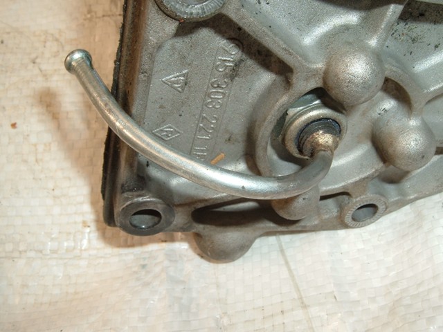

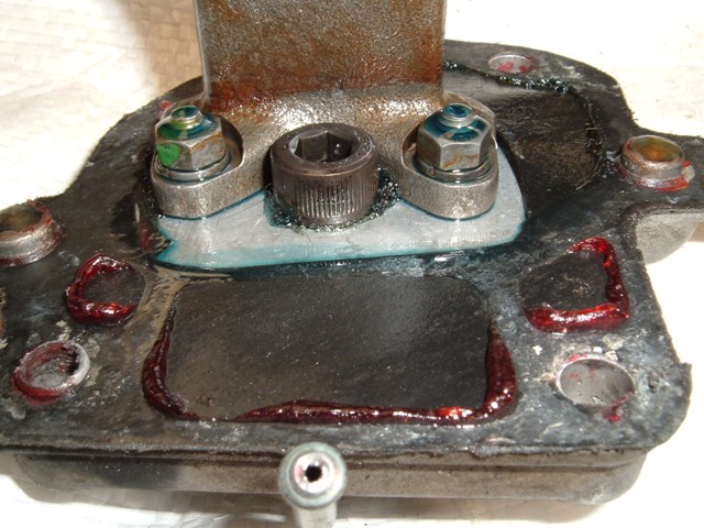

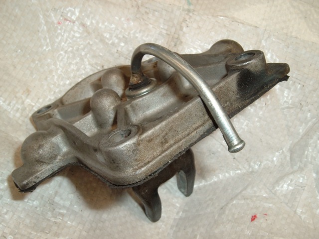

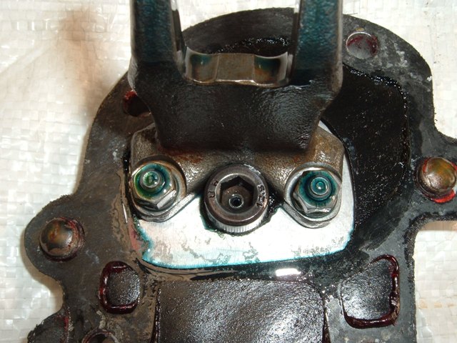

Ron,
Just pulled the fulcrum plate to get some pics for you. The breather is an M10 capscrew drilled up the centre with a short length of 3/16" bundy tube brazed into it and a flare formed on the end to retain the plastic tube. Its held in by a nyloc on top and assembled with sealer on the threads under the nut to stop any weepage. It works fine.
