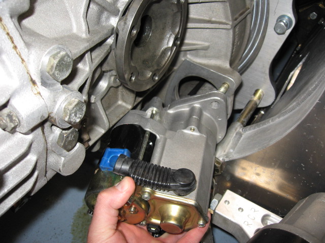

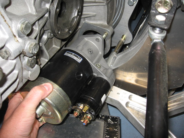

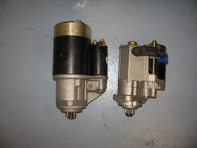

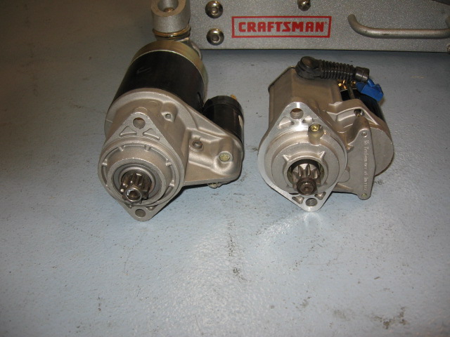

Hi Mark,
Any source on that little starter you have?
Ok, I have a stock 930 starter in house as well as the mini gear reduction high torque unit. Neither will fit as you can see in the photos. What I need is a mini starter that is clockable in relation to the ears for mounting. In fact, that is what I thought I was buying when I got this ministarter, but that wasn't the case.
Have a look at the photos and see if you can suggest anything I'm missing. Looks like I'll have a ministarter for sale shortly, I think I can return the 930 starter. Anyone know of a source for the piece Mark found or a source for mini starters that are clockable?
Ron

Re: A Starter Predicament
Will do fellows, thanks for that. Gregg, that European page does have something that looks good, but I tried them the other day and got nowhere. Will try again tomorrow as well as try Fran's suggestion too.
That little one I show in the picture would work if it'd clock about 20 degrees up, counter-clockwise. Unfortunately the case and flange are cast as one piece and it isn't easily clockable.
Ron

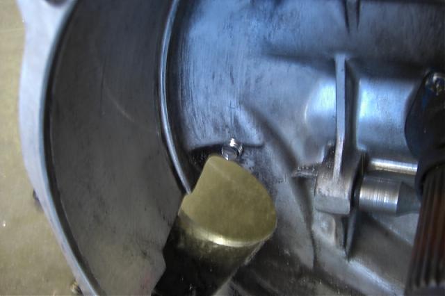

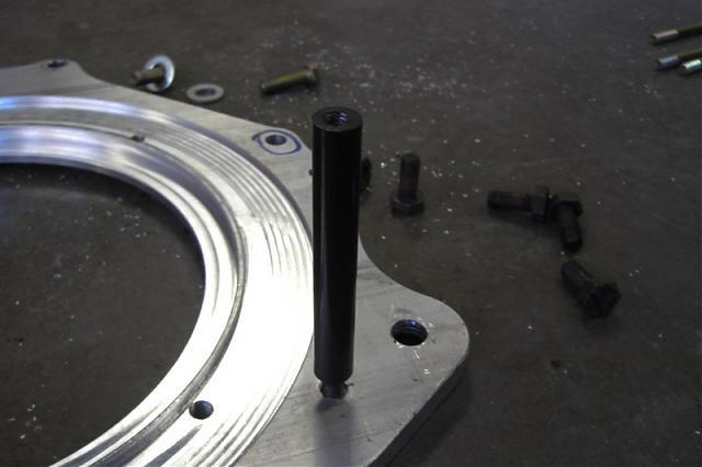

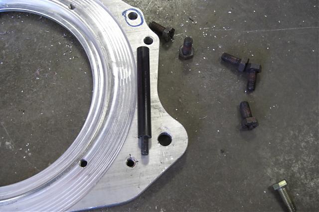

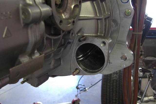

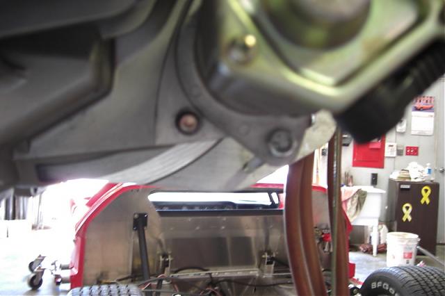

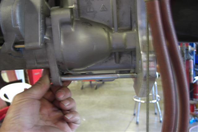

Ok here is what I did. First off I wanted my motor further forward in the chassis. Fran said I could use a indexable starter but I already had the good priced Ebay starter. I wanted to modify the trans so if I needed a new starter later it would be a bolt on and go part.
I turned the starter so it didn't hit the trans or the cradle. The bellhousing locates the starter. I turned it where the positive cable would miss the trans. I then drilled and heli-coiled the hole. The back side of the bell housing is irregular here and I would suggest a Heli-coil. I installed the Heli-coil and a stud with red loc-tite. The bottom ear is a straight shot to the adapter plate and misses everything. I think it was almost 4 7/16" to the adapter plate. I have a friend making a spacer the exact length tonight. I lined that bolt hole up and drilled and heli-coiled that hole ( this is overkill but I already had all the stuff out). It is a little tight on space for the spacer so install everything before you drill the first hole. It works on the RCR 40.
Jeff Hamilton
The other thing I looked into was making a distributor type hold down off of the factory stud for the lower mount. If I install the nut on the lower stud before the starter it clears.
Jeff,
that is a very similar solution to the one that I discussed with Ron a short while back....we also looked at that solution using the indexable starter from Kennedy and making the starter motor itself have a stud threaded into the nose cone and bolting straight through the adapter plate to the engine side...
Nice work...
Hey Jeff,
So the jist of it is mount the starter where it can fit, then use long bolts to secure it. One will go into the adapter plate, the other will sink into the bellhousing somewhere.
Do you have some pictures of the bellhousing hole and location?
This is a good solution and I didn't think of it at all. I was considering modifying the starter but with the one I have the housing is all cast as one piece and really can't be changed easily.
I've got a new starter (third one is the charm?) coming from IHI, who supplies Kennedy. It is indexable. We'll see if it fits, nice thing is the fellow there is extremely pleasant and said if it won't work then return it, no problem.
If it won't fit then your solution is going to be put into place, nice work!!!

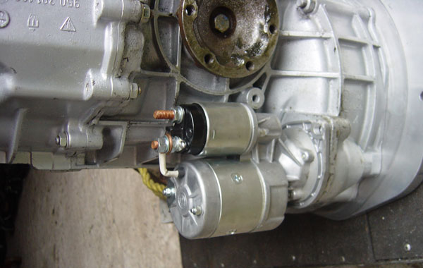

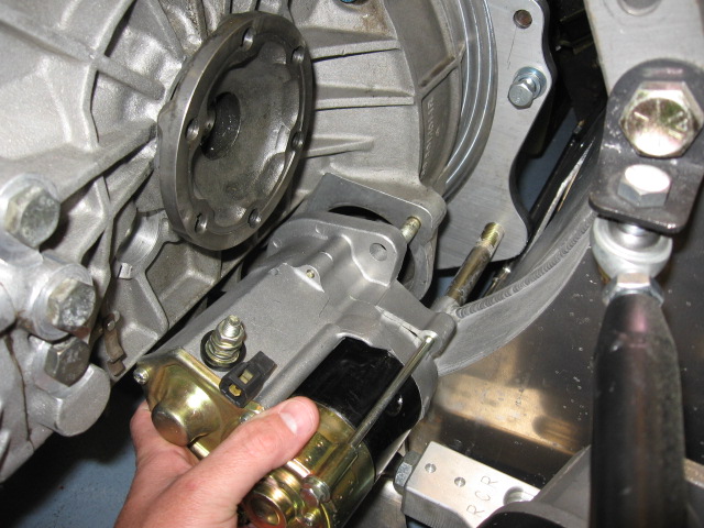

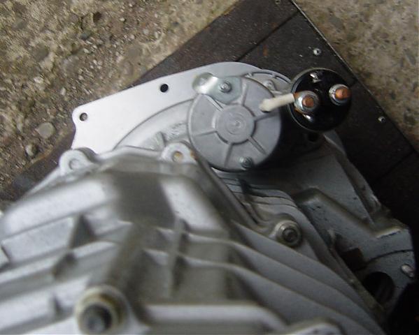

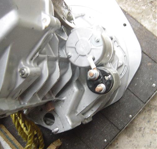

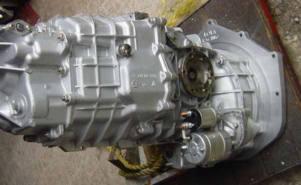

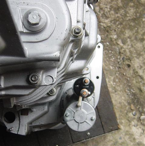

Hi Ron
Sorry for the delay in getting these pictures up here is the starter i have attached to my G50 as promised i think it could be coaxed to fit either way and have shown photos both ways (first & last pics the wrong way up!). The company who made it are supposed to be emailing me some info, they no longer make that model but have a new versionwhich is wider & longer. If you think the starter will do the job i would sell you the one i have as i have no fitting issues and could use the larger one i paid £190 for the starter.
I have the same mini starter you have in your picture. I added the stud at the top of the starter opening. Here is a few more pictures. I told John I needed a spacer and he made a nice one. He drilled and tapped the end for a starter bolt.
Jeff Hamilton
