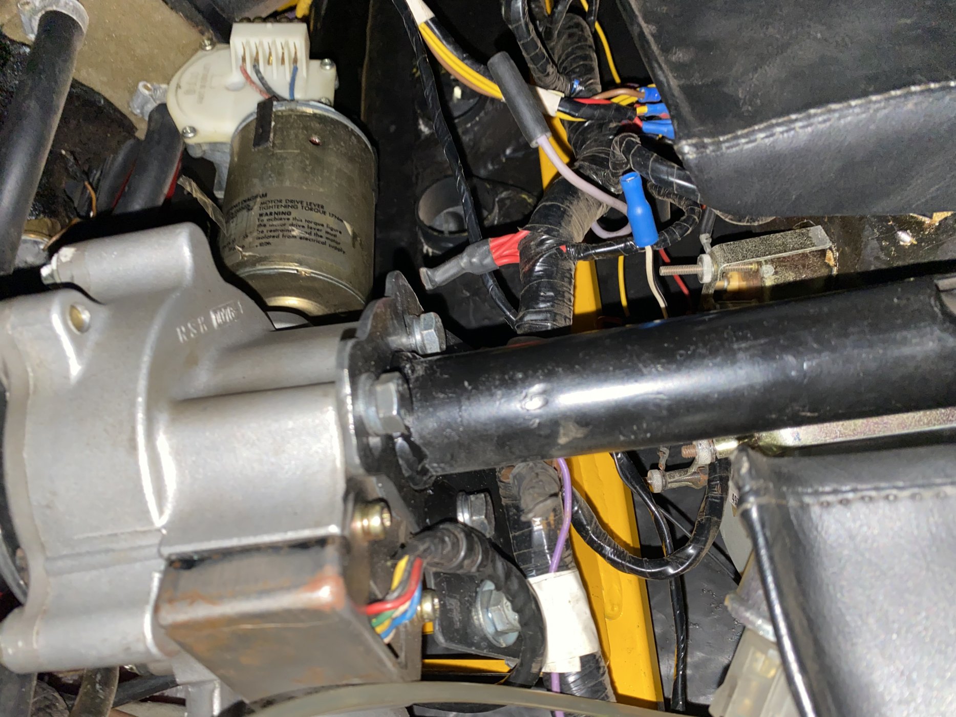

I utilized the Prius EPAS. Very simple default mode of 12vdc + and -...period. Provided about double the torque at the wheel, and drew about 22 amps at full lock. I did have to shorten mine, but the '40 has a little more room for one. Control box is separate from the unit, which makes positioning easy. Self centers fine, and never felt like I lost any feedback to the wheel.

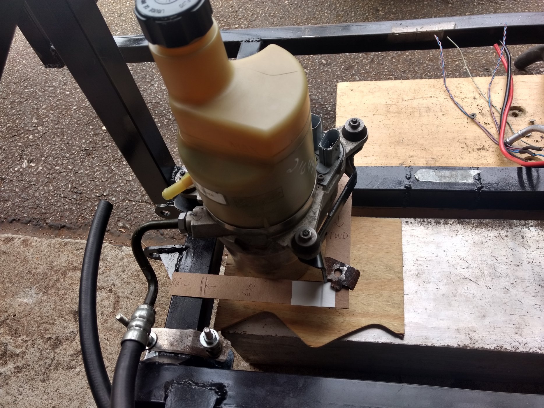

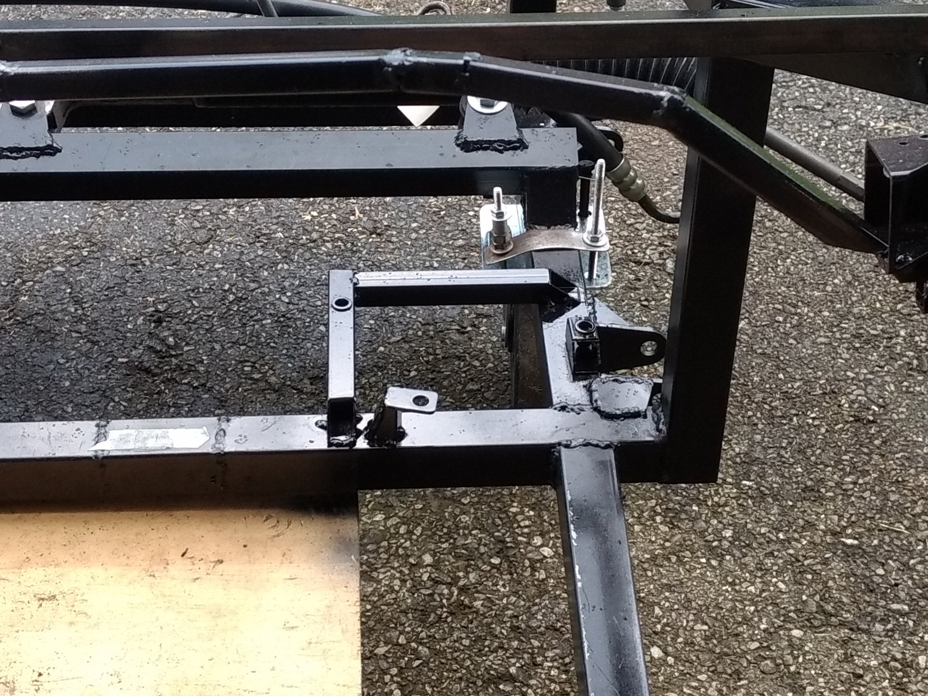

Hello all, like Jim I also chose a Volvo/Ford electric power steering pump for the CLK build. I found a used one locally that luckily came with the mounting bracket and hoses. I fabbed up a small corner for the pump to live in the front suspension cradle, ahead of the passenger footbox (LHD). The hose's run to the rack was just 24 inches/60cm and required the local parts store to crimp together a pressure line using the old ends. Donor car was a Volvo v50 .
