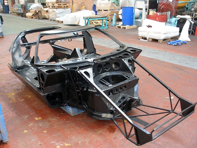

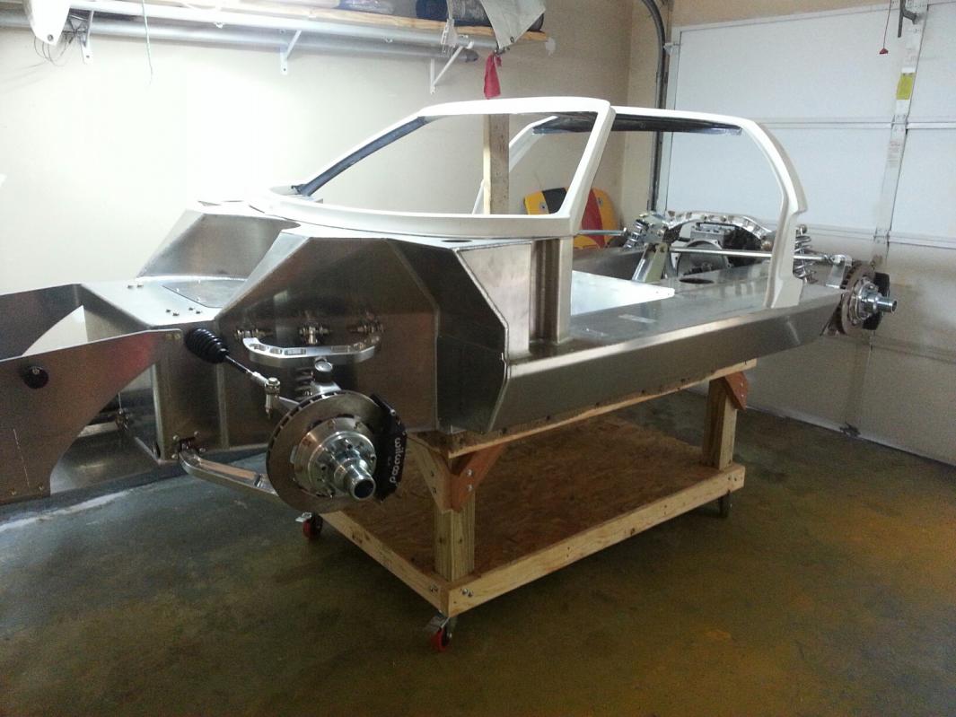

FAV cars are pressed steel monocoques, not aluminum (save for some one-offs) so none other than Gelscoe, David, Brown and SPF are "as original". I would suggest you are looking for an original LOOKING car rather than an original "type" car. And CAV IS an alloy monocoque save for the early cars they built.
Don't write off the other brands due to the space frame construction, they can be made to look very convincing with proper attention.
The only originals that had alloy chassis were the MKIV's and a few 'one of' subcontracted out to McLaren Racing. All others used a steel mono chassis.
So to simplify all MK1 & Mk 2 style had a steel mono, to get that at any where close to your budget an SPF is your only option, from there you have to go with RCR ( Alloy mono tub ) or CAV ( Steel or Stainless tubs ) or Tornado ( CF tub or semi space frame). However the RCR, CAV, & Tornado tubs are simplified in layout compared to the SPF & Originals.
Now I would question why you must bore & stroke to 427, a well built true 351 will make an easy /docile 450 HP and once everything is buttoned up look just the same and widen your choice of available transaxles and torque capabilities as well.
Pic attached of a genuine Mono vs a RCR, search for the others, then search search search before locking yourself into a decision. RCR on Left, SPF/Original on Right.
Andy used to sell a steel mono several years back. Now it's three chassis types, steel space frame, alloy composite mono, and carbon fiber composite mono.
