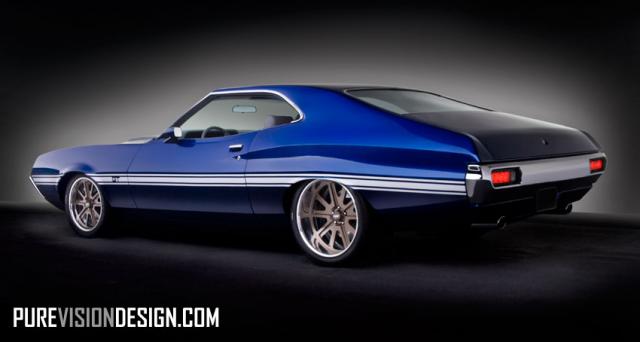

i´m just building a new racebike for the new season ( starting 4th of may)
Will paint it white and blue.
THis is exactly the blue i´m looking for
click
Anyone knows the color code ) or of a very similar blue ( remember a post with a gt40 painted in a lexus blue, which is very similar, but did not note the color code at that time, and can not find the post either).
Thanks for your help
TOM

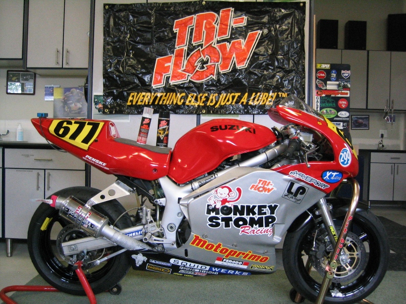

Excellent color! Make sure to post up photos when you are finished. Here's a photo of my bike, which I sold recently. Chucking myself down the track just got to be too painful, so it was time to hang it up.

Check out Ford Royal Blue Pearl (KM 6479). Great color. I did a Cobra in that color with GM arctic white stripes. Very similar to the GS colors.
Thanks for your answers so far, I think i go with the lexus color Spectra Blue Mica which is the factory Toyota color 8M6 .
