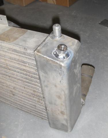

Here's a cooling system improvement you can make next time you have to change your coolant, replace hoses or any work that requires draining the system. Remove the rad, it will come out with the front body section still in place, and have an aluminum bung welded onto the bottom corner of the rad as shown. You can put a pep cock or pipe screw in the hole, ready for the next change, cool.
