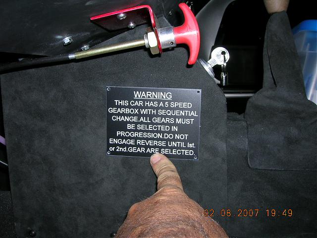

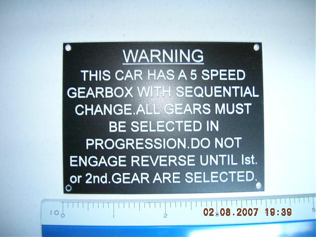

Thanks for the photo. This allowed me to make a plate that (I THINK) is very close to the aspect ratio, font and kerning in the photo. I made this one with white letters on black but nearly any color combo can be made. Does anyone know where these were mounted?

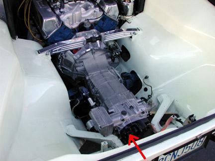

Hey. ive experienced this problem before with a customers car, this happened once and it was a pain in the ass as we couldnt get the backplate off without removing the rear tail cage. So what we did was drill and tap a hole for a bolt concentrically to the rod so we could simply remove the bolt and push the rod back into position if it ever happened again. Maybe this is something you guys could try it if its a reacurring problem! You could also fit a hard spring, as i think has already been suggested, to help push it back into place once you have moved it out of reverse.
This is the best picture i can find, but you can see the black casing at the end of the gbox, this bolt was drilled n tapped in the same direction as the arrow, concentrically over the idler shaft, once the bolt was removed you simply inserted a punch or a small rod in the hole and pushed the idler shaft back into place and then reinserted the bolt.
This is a good quick fix.
