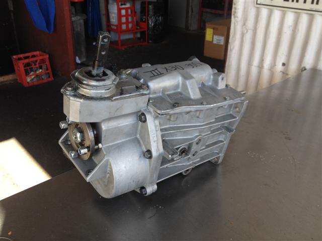

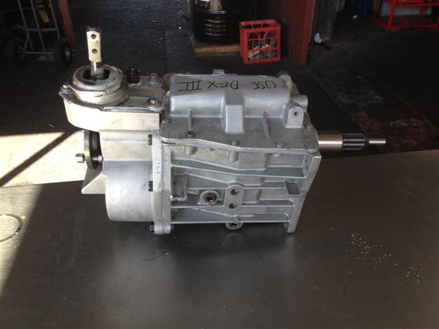

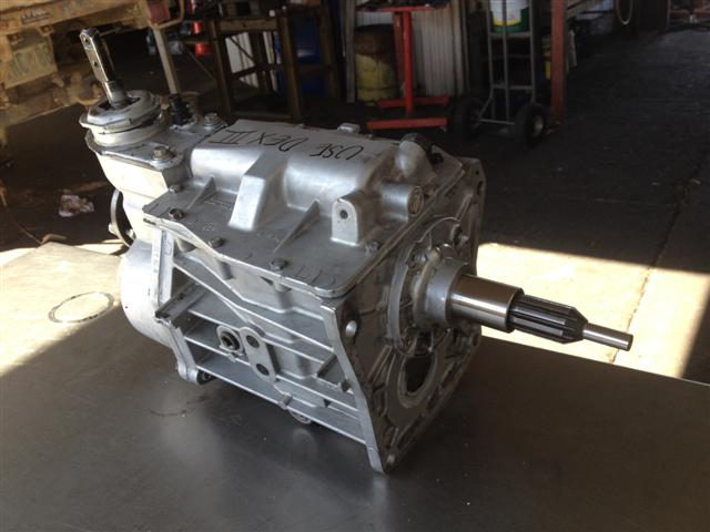

D type T5 --any body ?

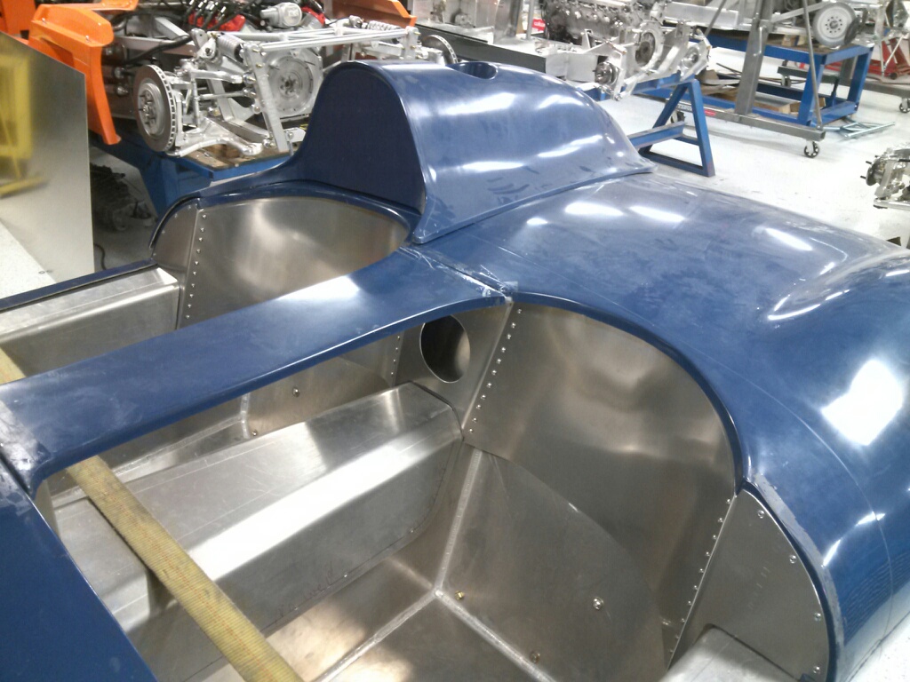

Jag D Type Update, December 2014
The D Type is coming along nicely. The details Fran is developing are impressive.
Aluminum panels under the front clip – a nice original touch.
Note the contour of the seat backs – like the original. Cushions were held in place with big snaps. This provides the foundation for seating similar to the original. And that hole between the seat backs can be seen on the prototype!
The original was essentially an aluminum monocoque airplane on wheels. Lots of rivets. All those rivets on Fran’s D Type add to the look.
I like that aluminum instrument panel. It would look nice with black crinkle paint while the remainder of the interior remains bare aluminum.

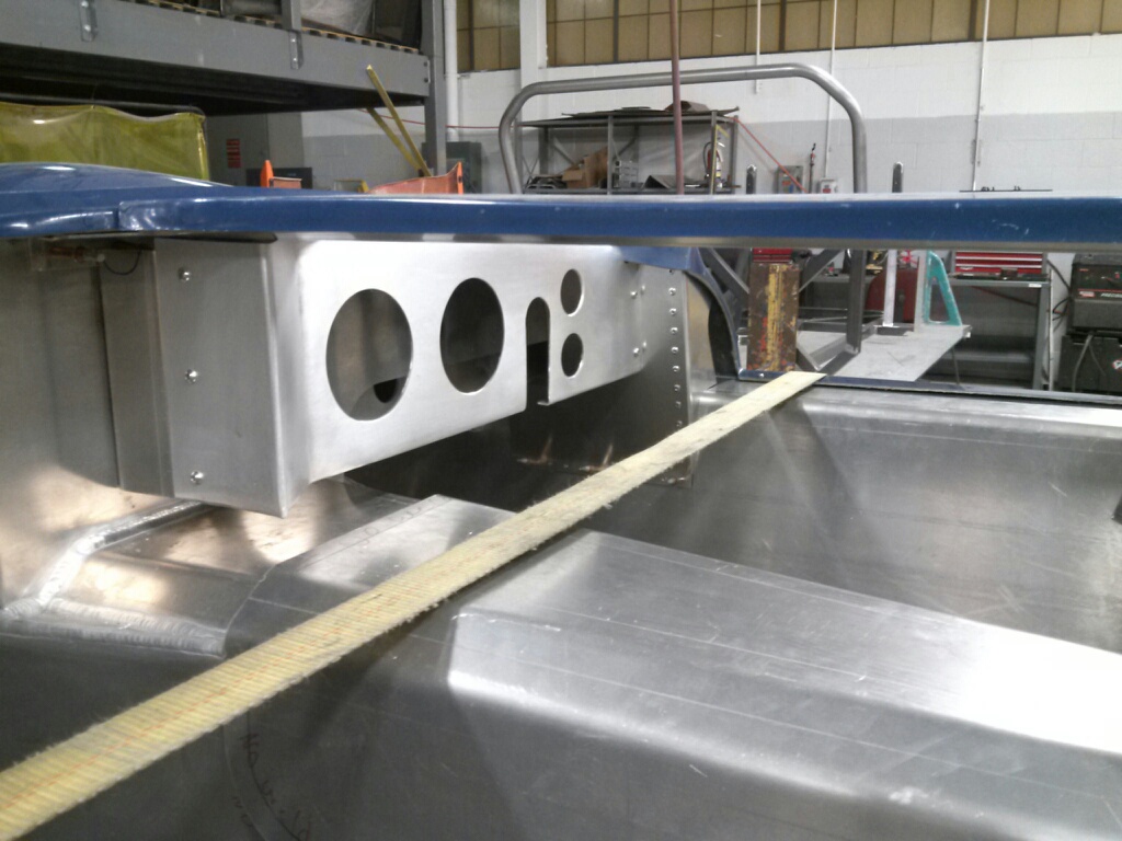

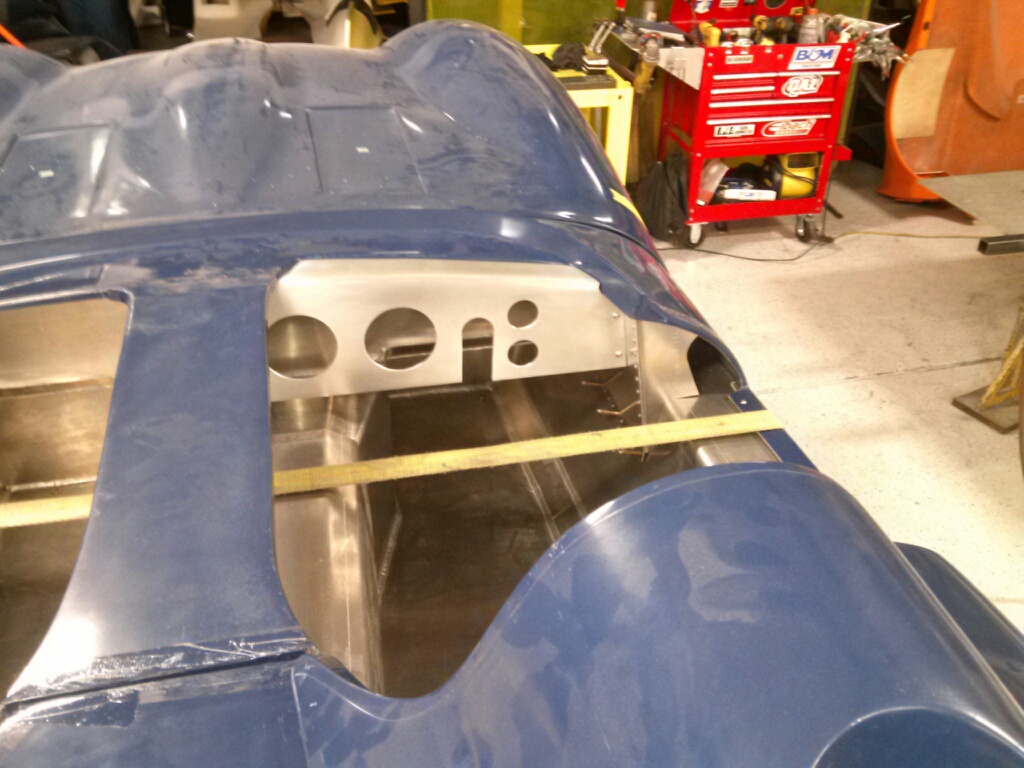

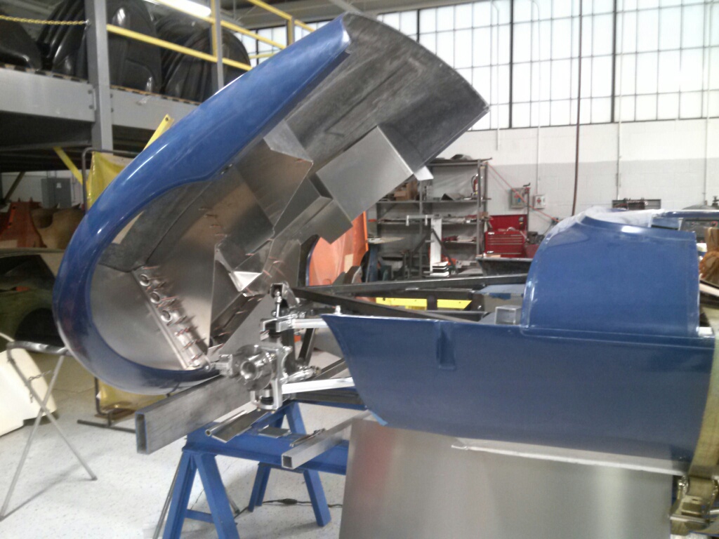

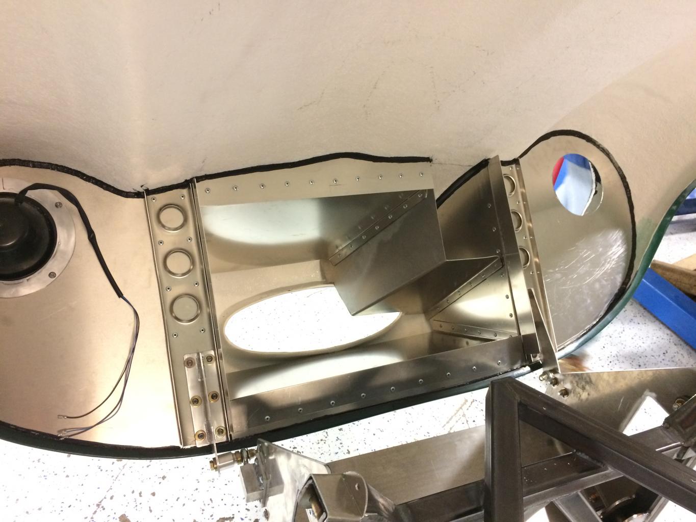

Jag D Type Update, January 2015

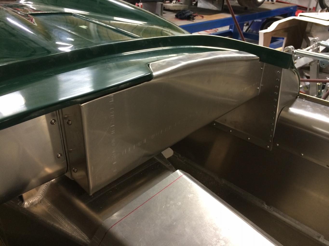

Ryan stopped by Fran’s shop last week and snapped some pictures of the progress on the D Type.
Looks like a lot of design and construction has been completed on the front clip inside panels. I was pleased to see them being made from aluminum, adding to the original look.
Note the box tube on the right side. That is to direct air cool outside air directly to the carburetors, like the original.
The front suspension really looks good.
The aluminum instrument pod has been extended further toward the center line, providing an area for the ignition and other switches, like the original. I am glad to see the instrument pod being fabricated from aluminum.
Too bad there is an airplane filling up my garage.

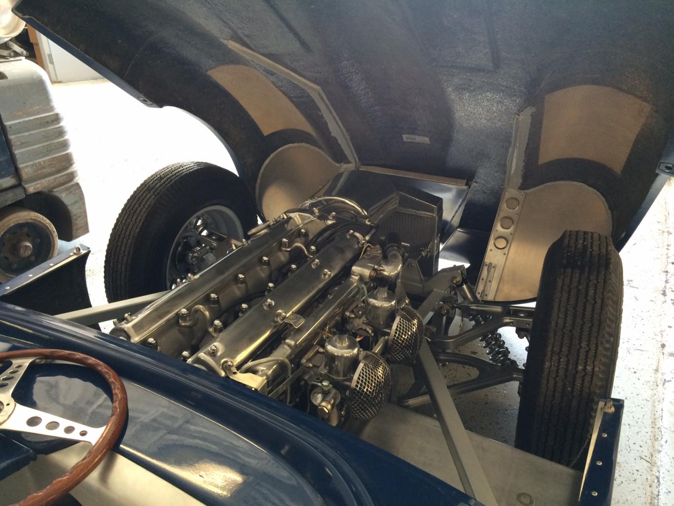

Jag D Type Update, May 2015

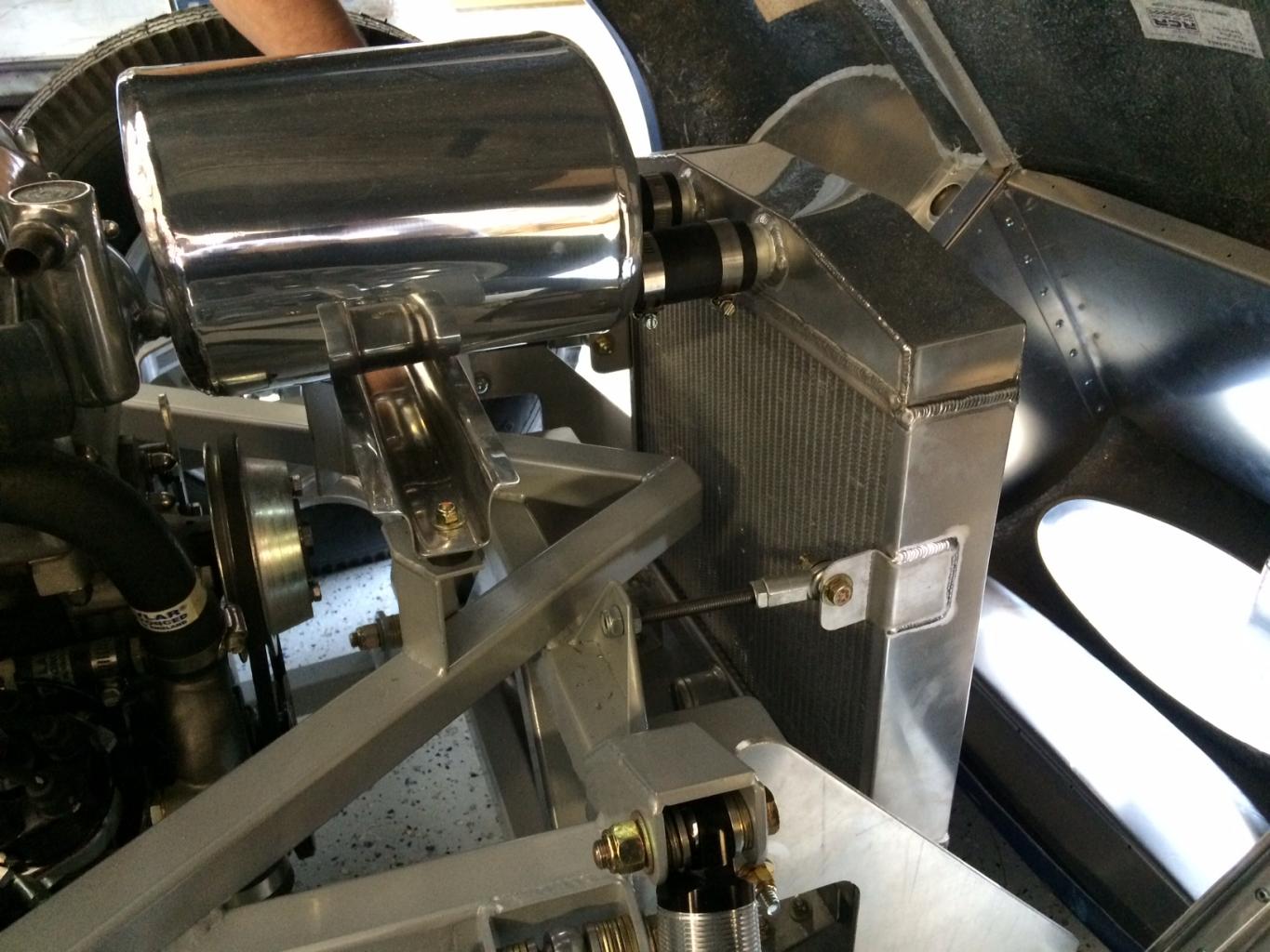

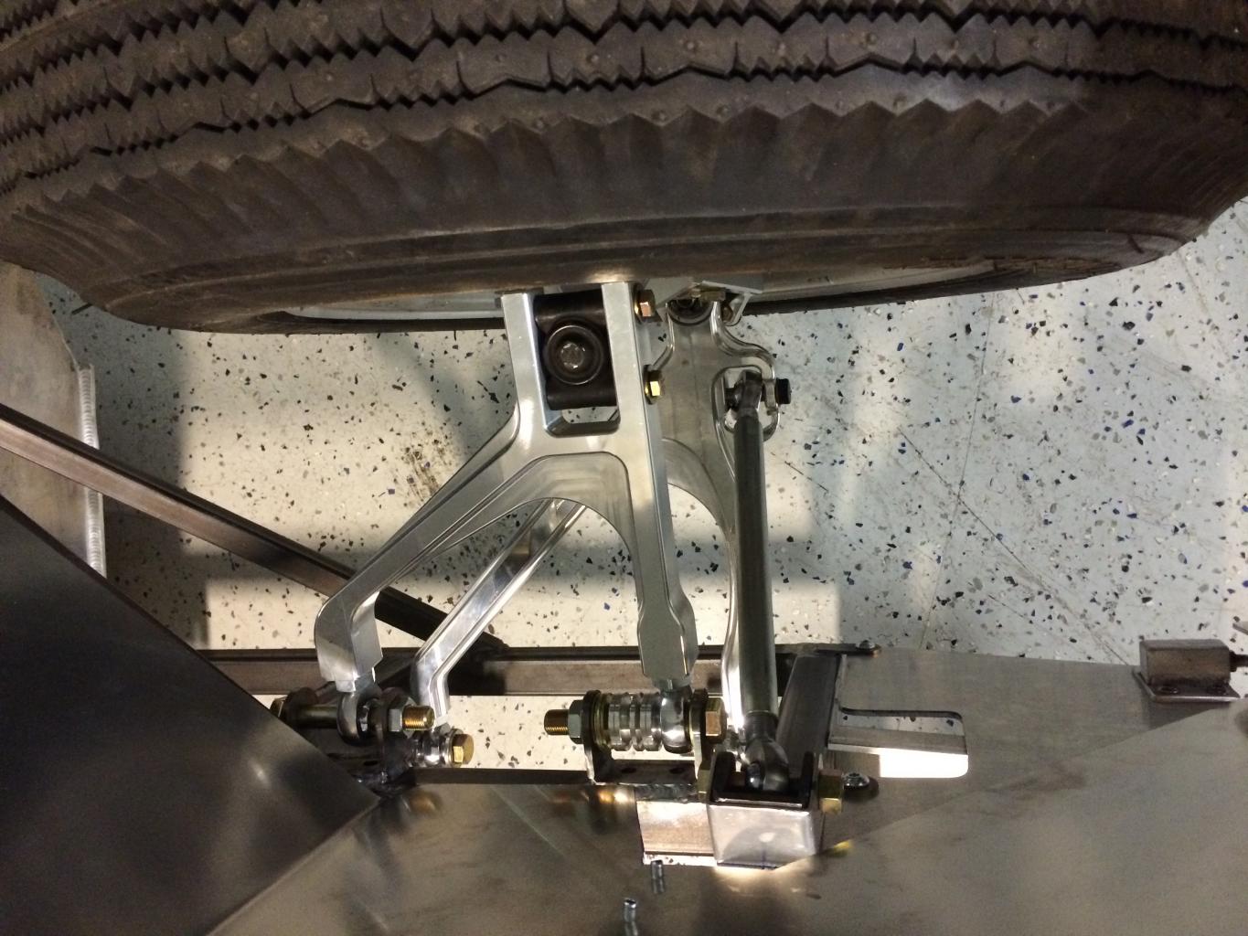

Paid a visit to RCR to check on the progress of the D Type.
Front sub frame was powder coated to match the aluminum. The color is right and will convey the impression of the original.
The front suspension pieces look good. RCR is fabricating the upright, upper and lower A arms. Unlike using original Jag components, the RCR suspension will have adjustability. Although they don’t look exactly like original pieces, they will be hidden behind the wheel and the advantages of the new components outweigh using antique parts on a new car.

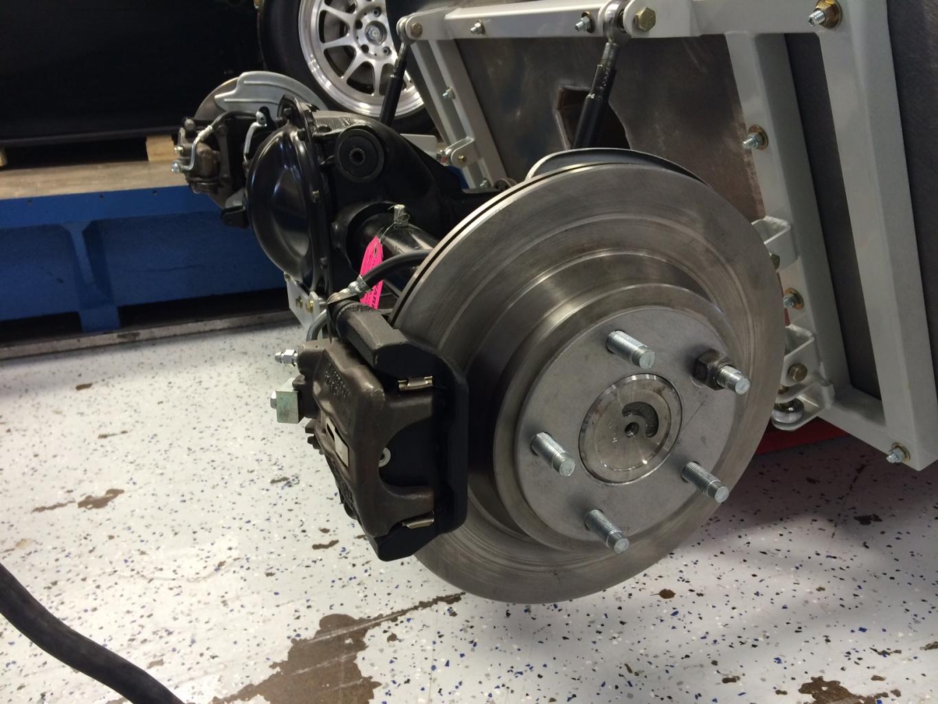

The rear suspension, brake rotors and calipers were in place. The rear calipers include a parking brake connection, which is a requirement in some states in order register the car.
Looking at Fran’s prototype, an engine was in place along with the radiator and the expansion tank. The expansion tank is a dominant item that sits between the radiator and the engine, important to the look of the engine bay on this reproduction. Although it needs to have a filler cap and other refinements added to be complete, it looks very good.
The radiator is offset to the left, as per the original, so that an oil cooler can be added in the space on the right.

2-In the pics above, the suspension arms are machined. Is this going to be standard? (They don't look like oem parts)
3-What are the windscreen options? Full width and/or individual for the driver plus a cover over the passenger area?
Fran Hall RCR
GT40s Sponsor
Your head will be above the headrest as you are 6'5" Justin....even sitting on the floor.
A arms are now fully machined and are part of the kit...too many crazies wanted more money for used/junk jaguar parts than we can supply nice new adjustable arms.

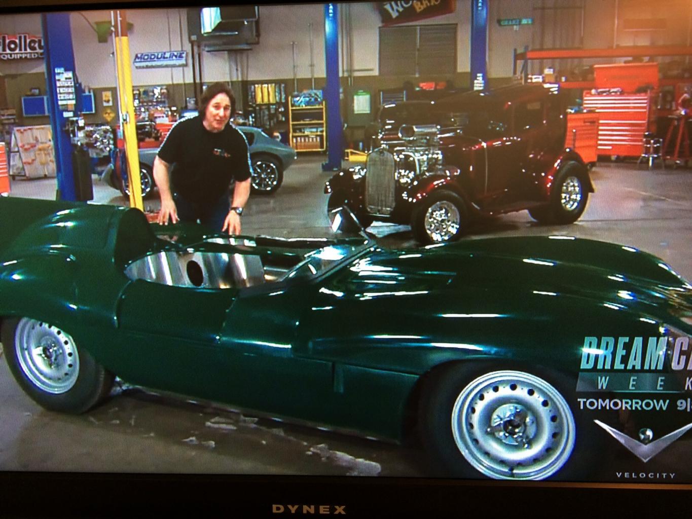

Stacy David did a nice job previewing the RCR D Type this morning. Nice interviews with Fran.
Not so sure about those wire wheels he is contemplating using.
Hope he sticks with it.
The chassis, body, and various bits looked impressive
