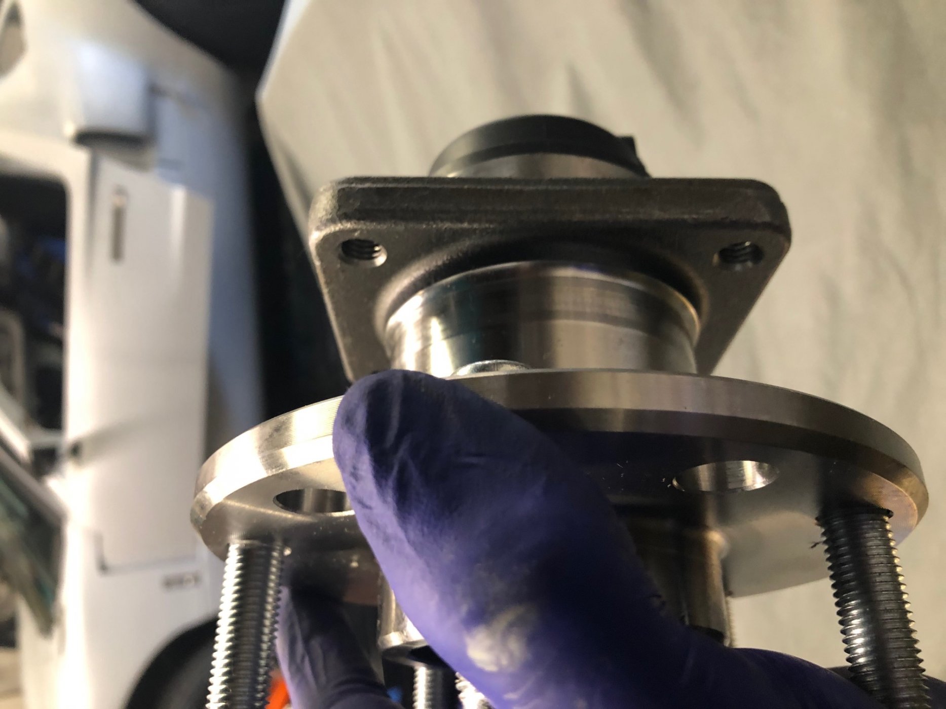

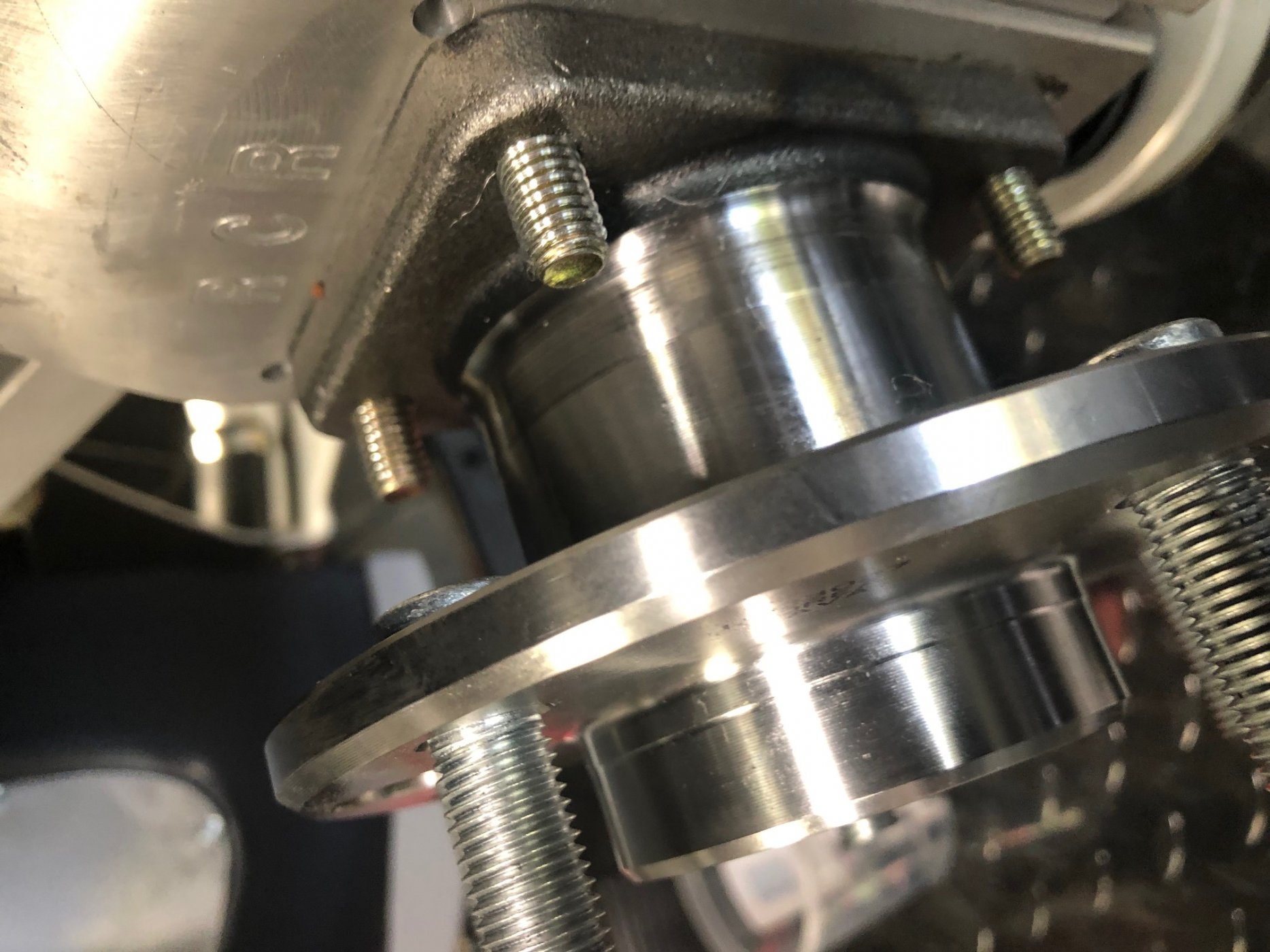

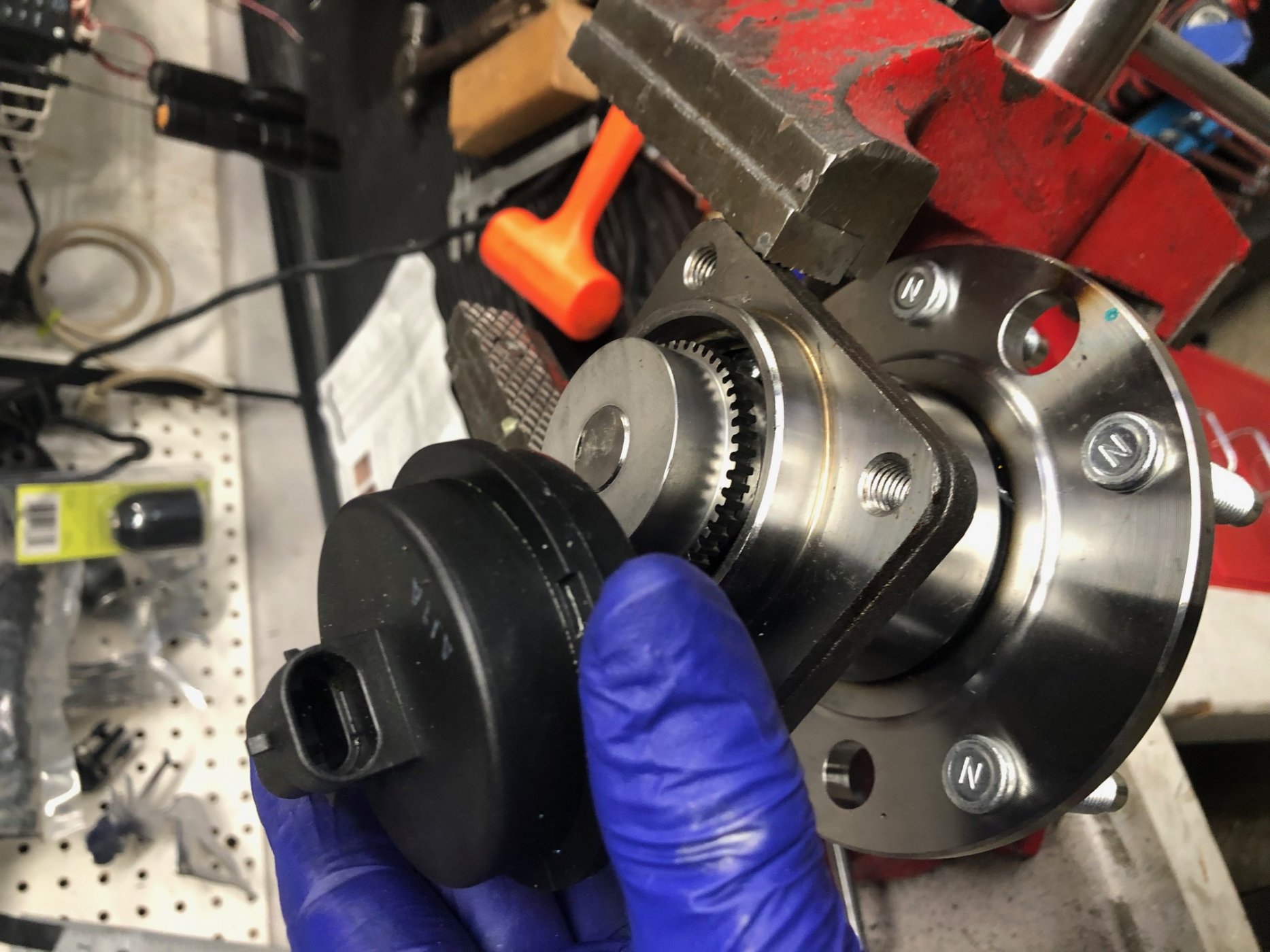

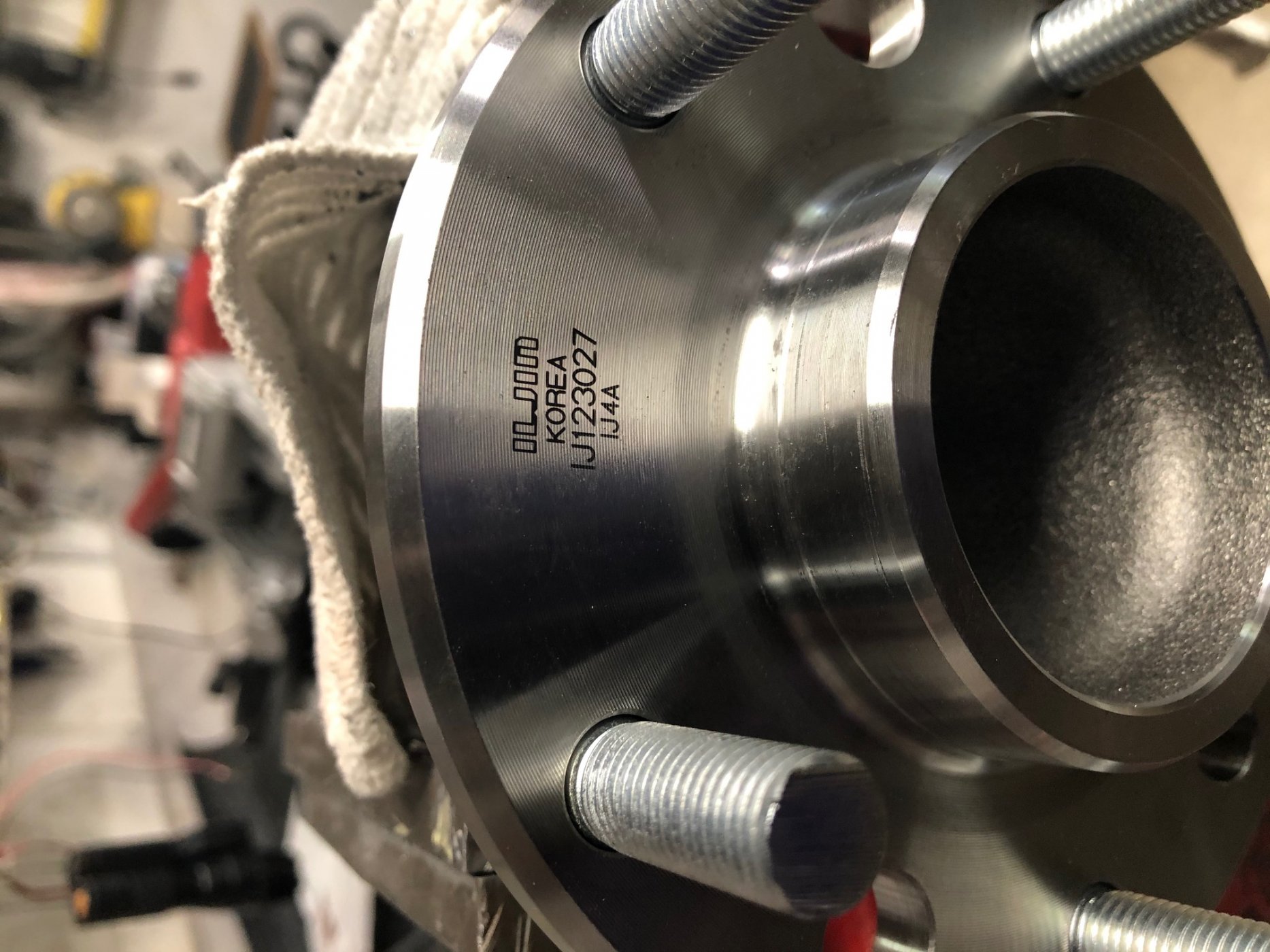

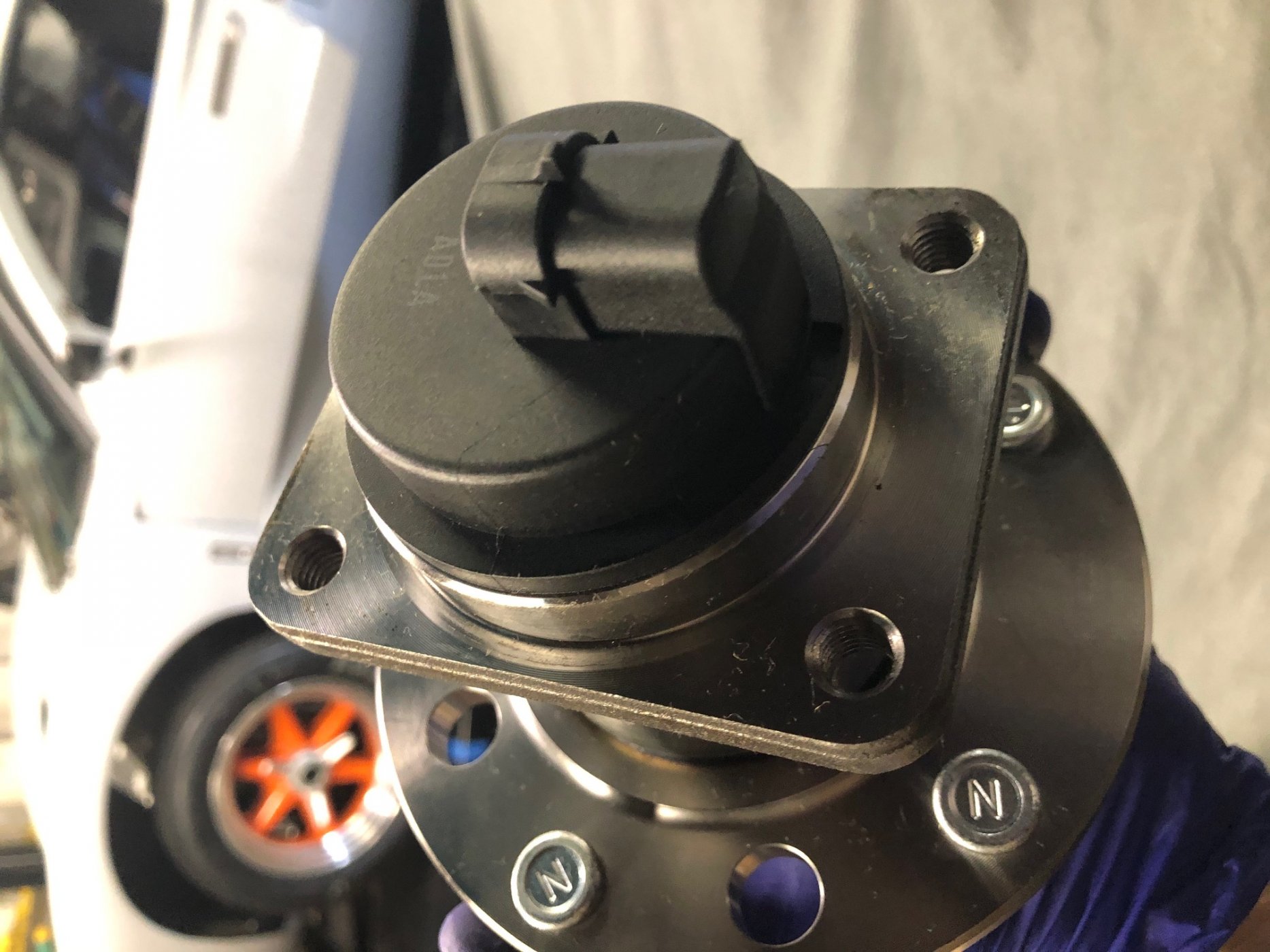

I'm updating this post with some additional info for those that have the C4 front hubs. I purchased the SKF hubs from Summit that Joel suggested that were listed for a Camaro (see above link) and was pleased with what I found. The overall quality looks good, they are stamped as made in Korea which might be of better quality? Far and away better than the hubs supplied with the kit(manufactured in 2007 but not built until now) which had .020 play at the wheel rim with 0 miles on them. The four bolt holes in the flange of the SKF hubs are tapped instead of straight drilled but the hardware from RCR bolts them right into place, a nice snug fit in the cavity in the upright. I had to remove the outer plastic cap for the ABS sensor and I added a little extra grease for good measure. I also used the 3/8" nuts as a safety on the four bolts in the flange just because. The price was $232 shipped for both hubs from Summit. I'll keep an eye on them and test for any play when I get some miles and track time on the car. I'll update here with what I find. I'm pretty optimistic at this point. Thanks again Joel for the great lead.

Regarding differences between SKF BR930023 and SKF BR930186: the latter has studs with an unthreaded tip, the former does not. In Kim's first picture above these tips seem to have been milled off. Am I right? Also, since the previous entry dates back to 2020, has new insight/experience been gained on this issue since?
