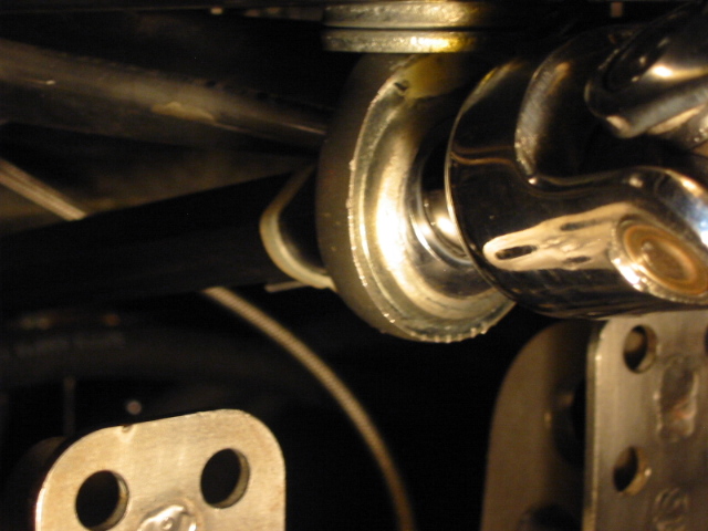

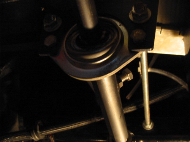

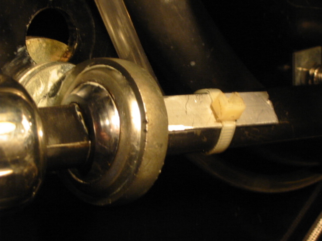

I am guessing the rattle is at the second support bearing under the dash. It does not have a set screw. Try jiggling it. Or hold your hand on the steering shaft while wiggling the steering wheel to see if that is the source of the problem. A fraction of an inch of play can feel like a lot more at the steering wheel. The flattened surfaces on the round steering shaft creates a bit of play.
My solution is not very elegant but seems to work. I made a tiny wedge out a piece of aluminum, jammed in in place along the flat surface of the steering column, and then put a wire tie around it to keep it in place. It solved the problem.

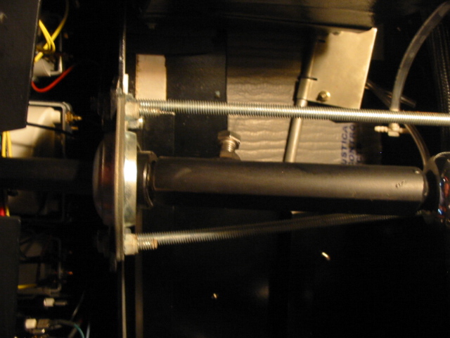

Also note that the first support was reinforced with a pair of threaded rods. Page 44 of the 'Book' has the details.
Pictures are attached. You will probably scratch your head trying to figure out what they show, but if you have spent much time lying under the dash they should make sense.
