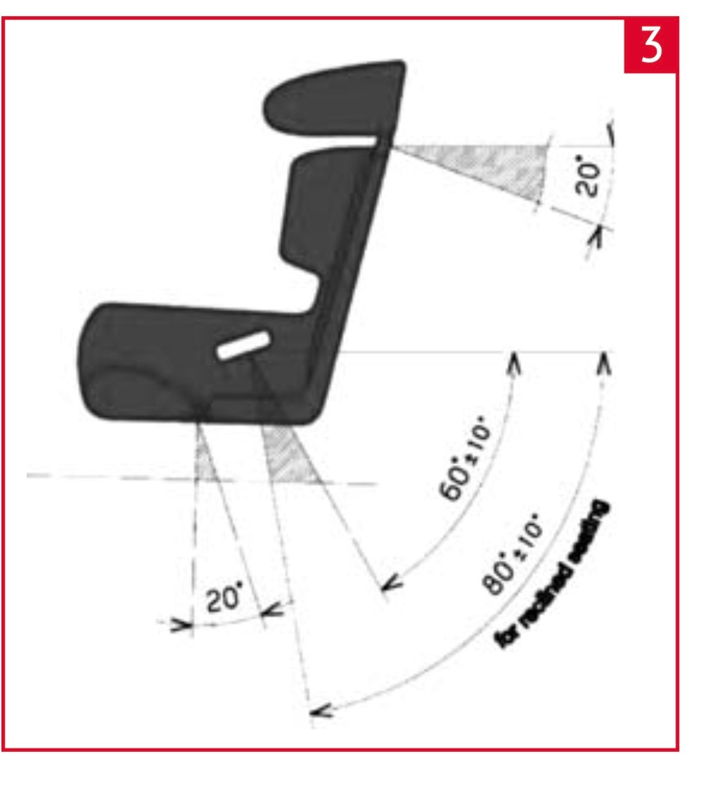

Hi Chris: Can you explain your concern? I suppose it is the angle of the lap belt (which may be less than 60 deg - see diagram from Sabelt)>
Chris, thank you for you input but I don't want to open up a can of worms on the proper installation of belts. There are already threads on the forum that cover this topic.... Sadly with conflicting information. Also I will say that belts need to be fitting based on seat position and drivers body size / type. In the Formula Atlantic Swift cars there is 6" of lap belt anchor points to best fit a given driver. For me with a 30" waist I run the farthest point to the rear of the seat.
Hi Walter, with respect to Brandon, I won't go too far but yes, the threaded points which I have seen used are too far back and too high to properly locate the lap belt.
Chris, thank you for you input but I don't want to open up a can of worms on the proper installation of belts.... I just would like so setup info for those who have built cars to start me off in the right direction on belt specification, anchor type, and brand to avoid making a mistake in ordering the wrong equipment.

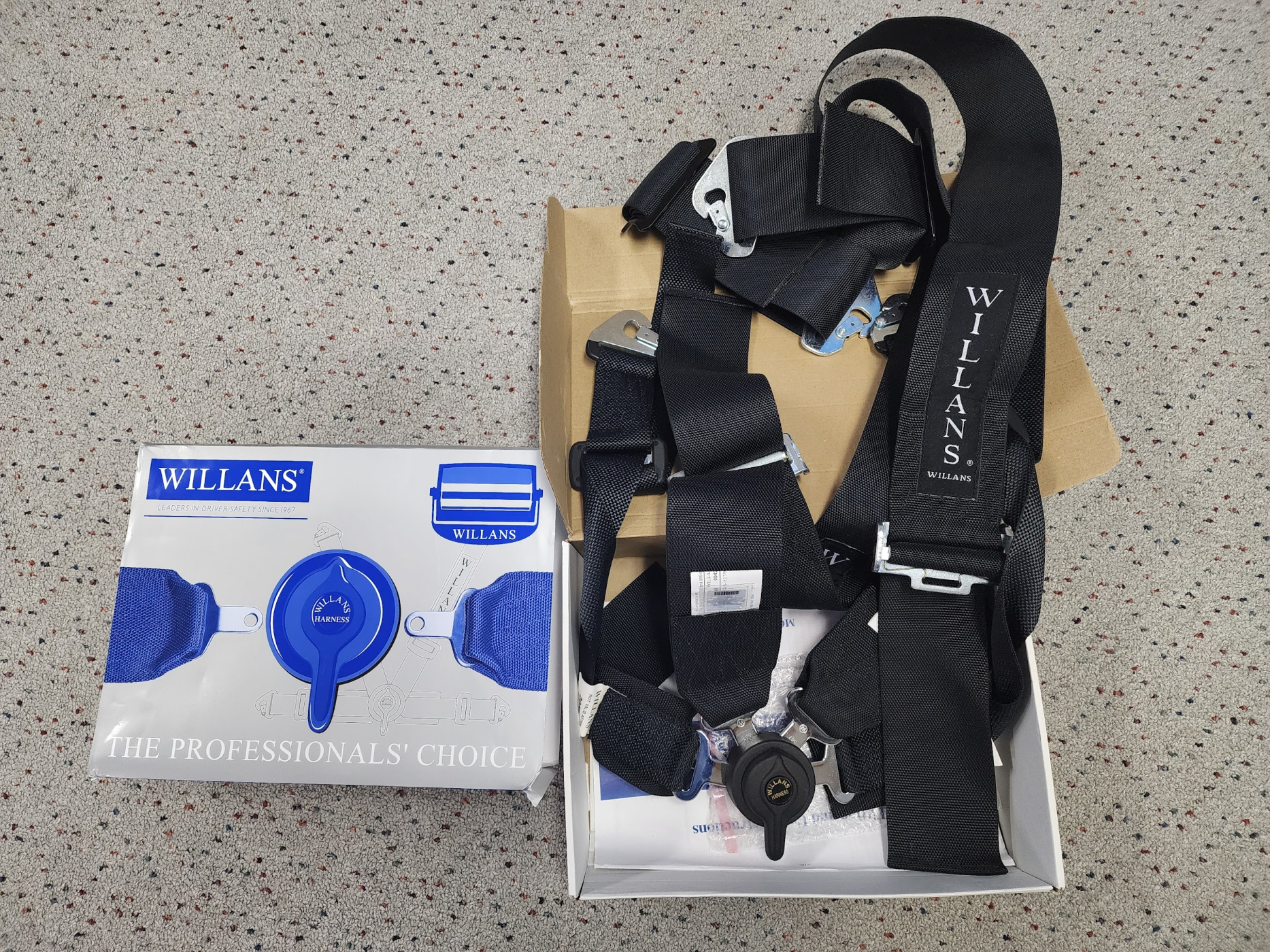

My RCR Deluxe kit came with these Williams:
(My shoulder belts go around the cross bar on my roll hoop and my lap belts are anchored through the floor. <<< DITTO)
