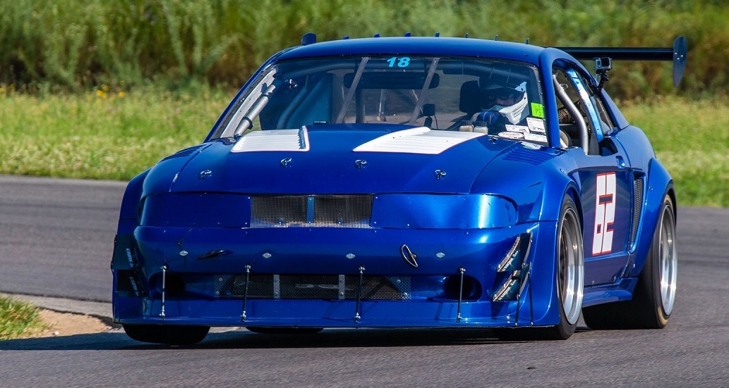

If you like the Pilot Sport A/S, have you looked at the Pilot Sport 4 A/S? They're a lot quieter on the track than the Pilot Sport 3 A/S I used to have on my Mustang.
(I'm not driving at 10/10ths nor am I a tire expert. I'm just having fun driving in circles)
Darius Rudis
