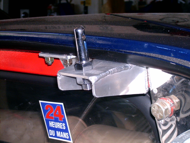

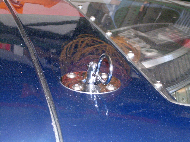

Here's mine
Howard Jones
I made the bracket myself used some standard hardware. The brackets are attached to the roll over hoop with 2, 1/4" bolts into bungs in the square tubing. I have not forgotten to latch them yet. I have sort of aquired a habbit of looking for them as I get into the car. I also always try to put the pins into the shaft when the back is opened up. That way you can't close the cover without removing the pins.
Pretty simple and easy to do. These will keep the bonnet on.
This is a very strong way to insure the rear deck will not come off. IF you remember to put the pins in it I cannot see how it would come off even in a heavy shunt.

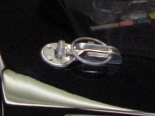

These are the hold downs on a friend's MK-V car . The ring stays with them when latched and it all stays nice and "stowed" looking to me , latched or unlatched. Not for the person that wants something in his way or on the seat though. Does anyone know where they are available from ? I havnt talked to him yet about them, if he knows where you can aquire them.

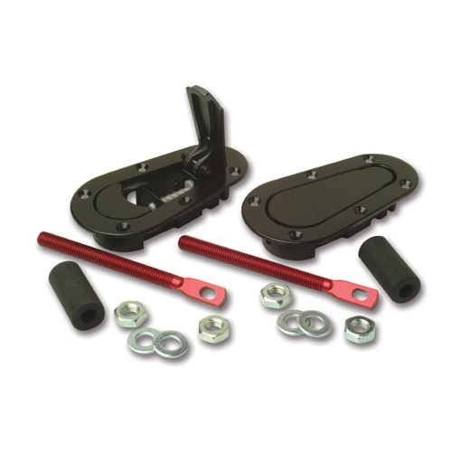

Several people in the UK have been using Aero Catches. Not original equipment I know but they are secure.
