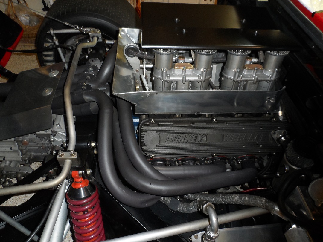

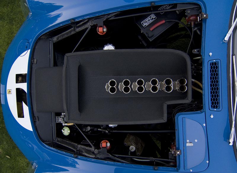

The main purpose for the smaller cut out is to block the intake air from coming from the hot engine area and letting it all come through the air inlet vents on the sides of the body. Some cars build a box around the carburetors to seal the intakes from the engine heat. That smaller opening helps with the stiffness of the rear body section as well.
Here is a photo of my buddy's P1083.
-Bob Woods

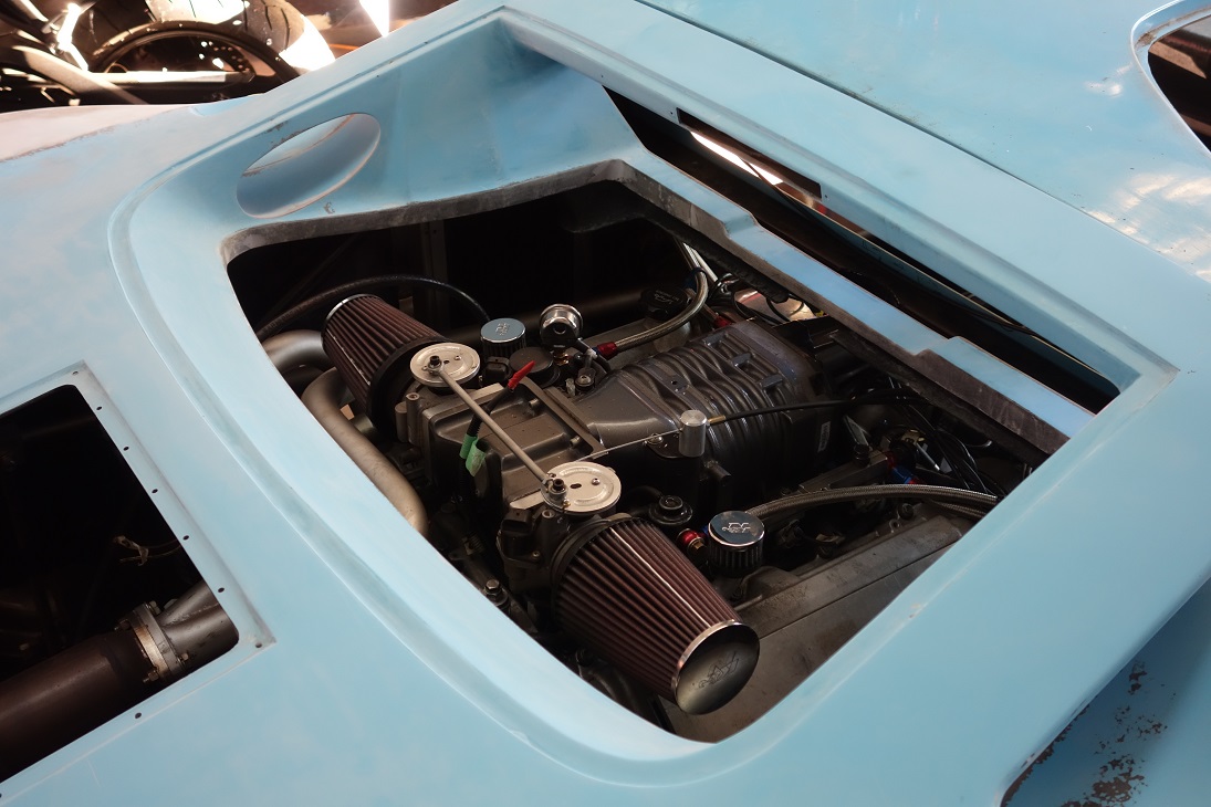

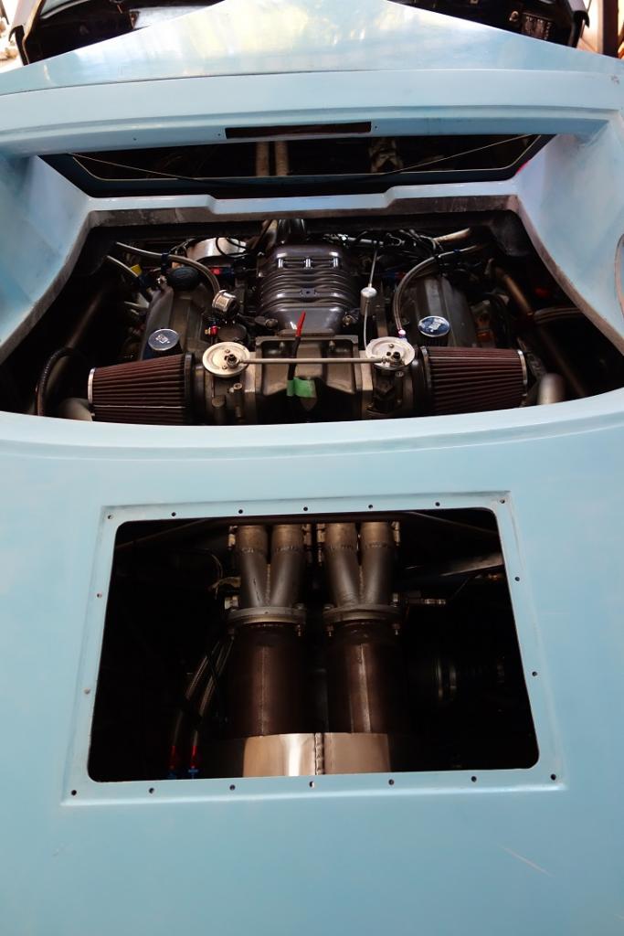

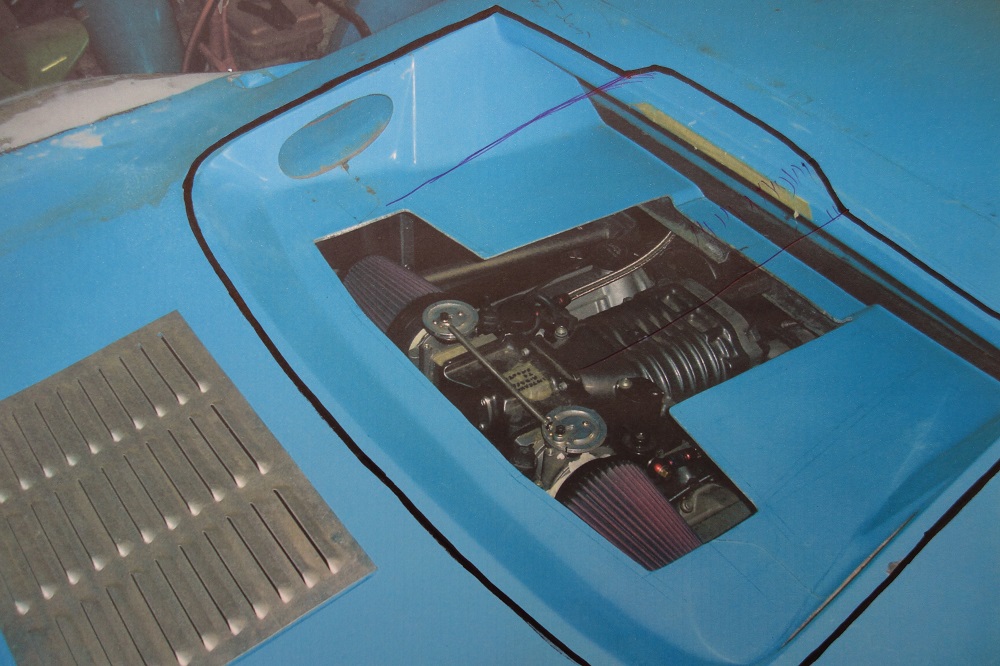

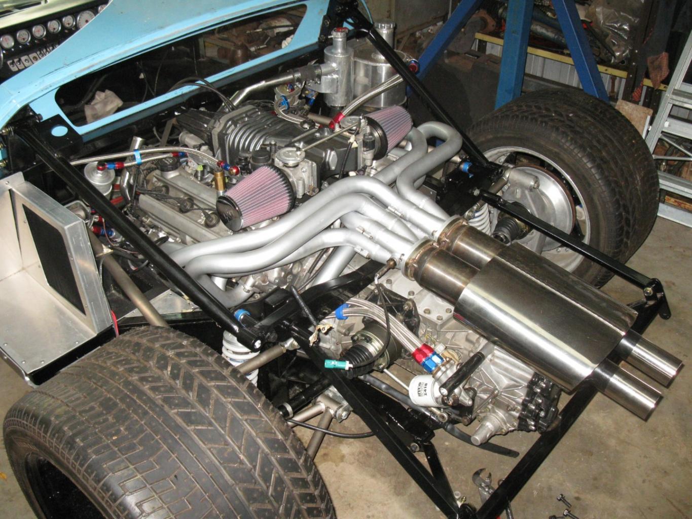

Yes, I can stiffen up the clip as required. In my case (not typical, I think?), my clip retains a cross brace at the front, so will be quite strong anyway (refer image), even with the larger opening.
Yes, air in and engine heat out. I’ve given a lot of thought to that. Initially, I was planning to shroud around the T-shaped opening to separate the intakes from the engine bay. If I open this area up, I will still provide shrouding for this purpose. Some cars go to great lengths in this regard.

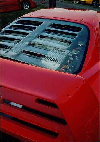

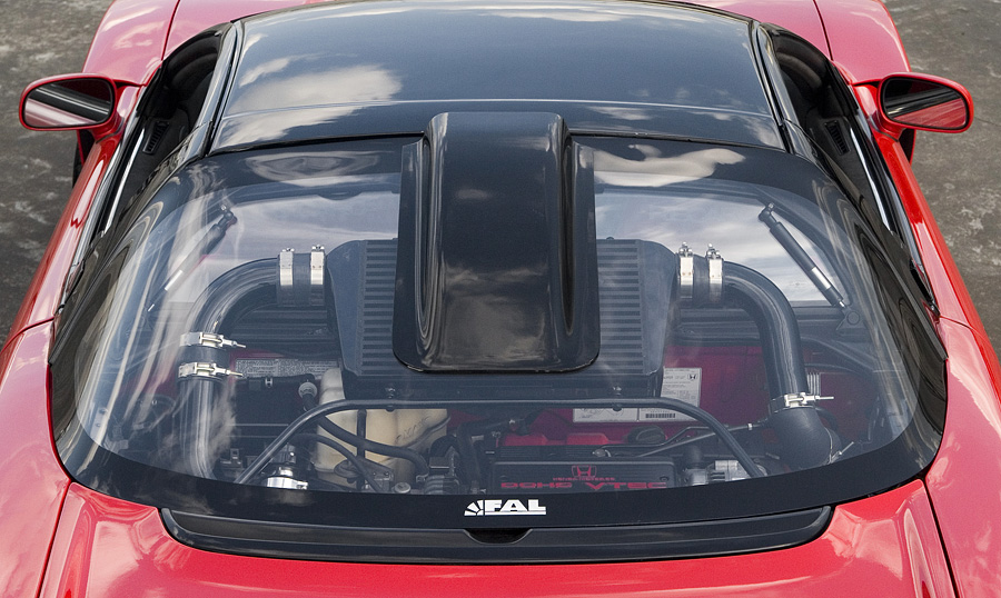

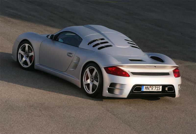

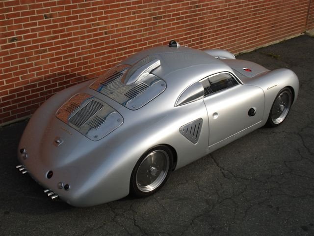

I’m also looking at doing something with the rear window in this context. Cosi has an F40 type rear window in his, which looks great. I’m considering having a window moulded with a scoop built into it (refer image). Hopefully, this will pull cold air in and allow heat loss while standing, but still retain what rear visibility exists.
These rooftop scoops are the flavour of the month at the moment, however, many cars, including the MkIIs, seem to go to a lot of trouble to draw in cold air, even to the point of not bothering about rear vision sometimes. It’s actually a look I like (that Porsche speedster must be one of the best looking cars of all time), but I don’t see it working on a GT40 myself.

One thing you might give a thought to is to add engine bay cooling fans. I have two 5" fans on either side of the bay that for now are manually operated and help keep the temps down by keeping the air flow to the rear. They are controlled with a "run on" relay timer(after shut down) that allows them to run from a few seconds to 10 minutes(I have mine set at 3 minutes) from Wayteck. I will eventually hook it to a thermostat.

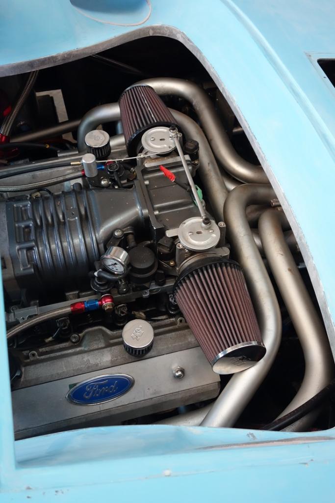

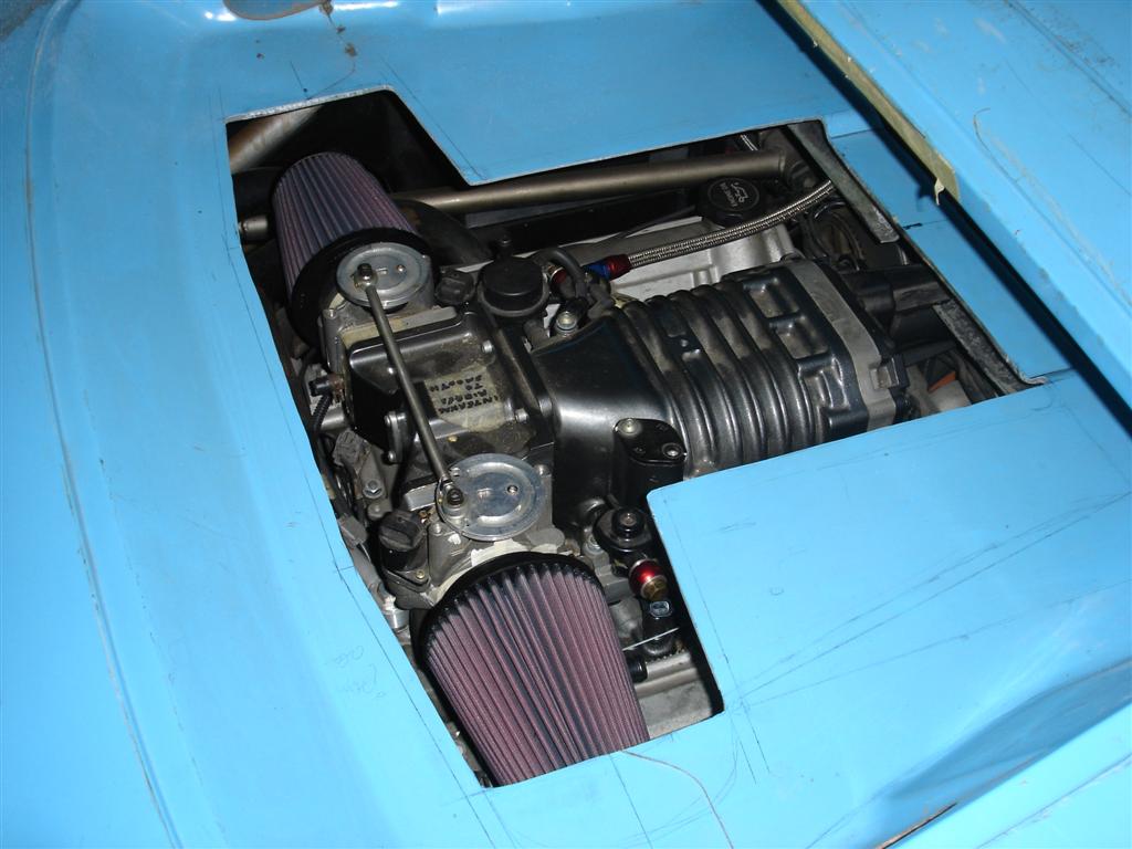

I decided to cut out this area. I've built in a return edge to stiffen it. I like the look. A lot of interesting things to see. Don't worry, I'll be ditching these filters and arranging some cool air for the engine.
Cheers,
Lance
