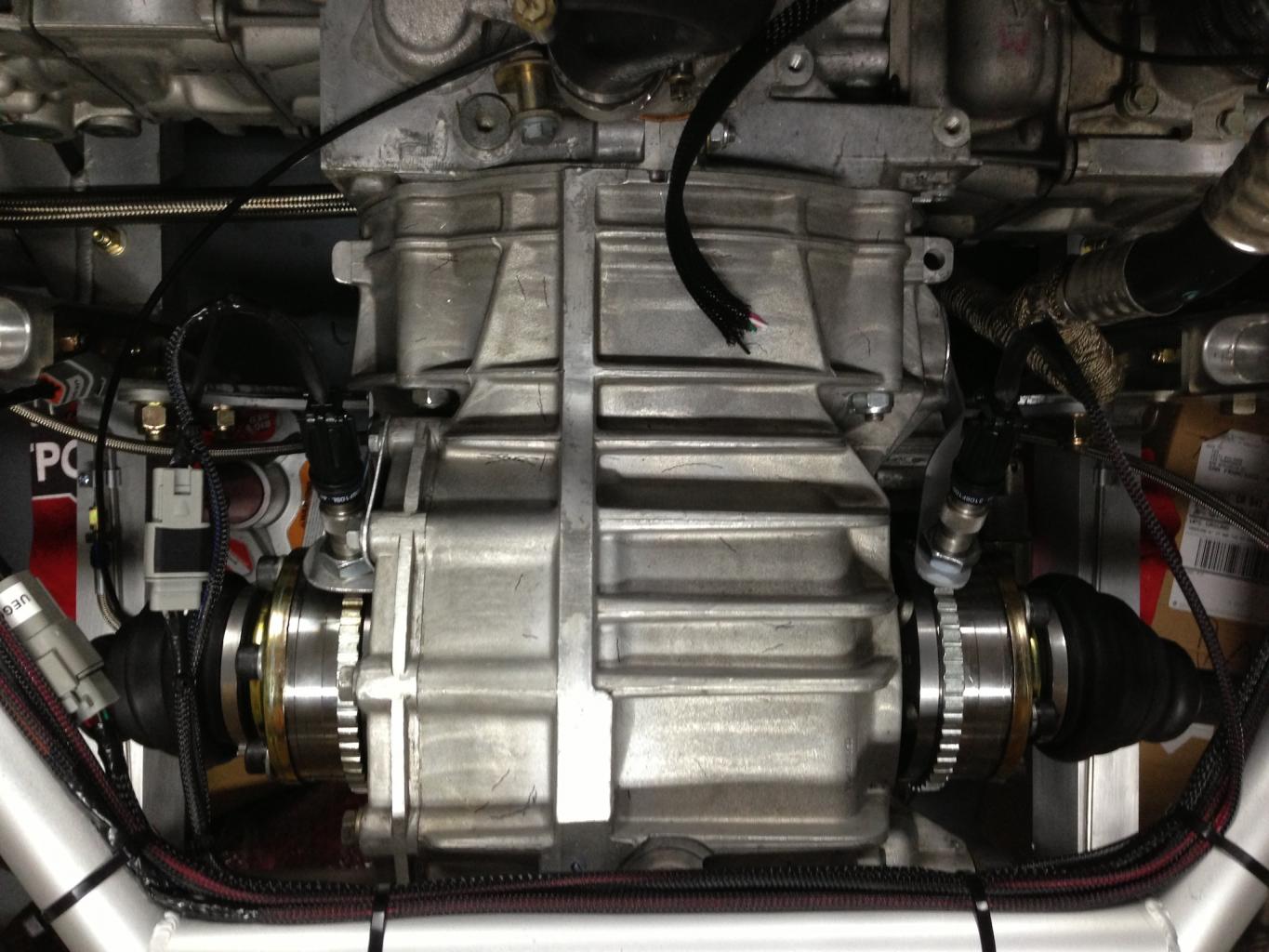

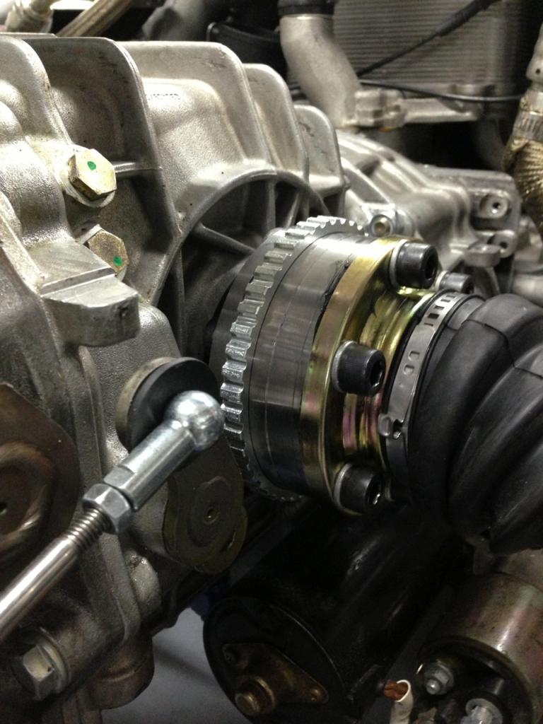

Call you the Drive Shaft Shop - supplier of the axles. They can sell you toothed wheels which fit on the hub. Easy to hammer on if you heat them up a little (I used our stove at 200F). I then fabricated a mount for the speed sensor on each side of the transmission (G96). My system is ECU-based using Honeywell 3010 VR sensors.

It's probably obvious, but I should clarify that I used the transmission-side hubs, not the wheel-side ones. Attached is a crappy iPhone pic...

Driveshaft Shop sells the "ABS" sprockets for $80 each, a lot less expensive than the hubs for sure! That's the path I'm taking.
Tim - looking good. My Racelogic TC is reading off the back wheel studs - but if that ever fails - I will go the ring route. For some reason I thought the rings were less than 100.00 for the pair....??
I think I paid $40 for the pair. Maybe I got a deal 'cause I'm such a nice guy. :D
That's more like it. I have another photo of your install from an older email.
