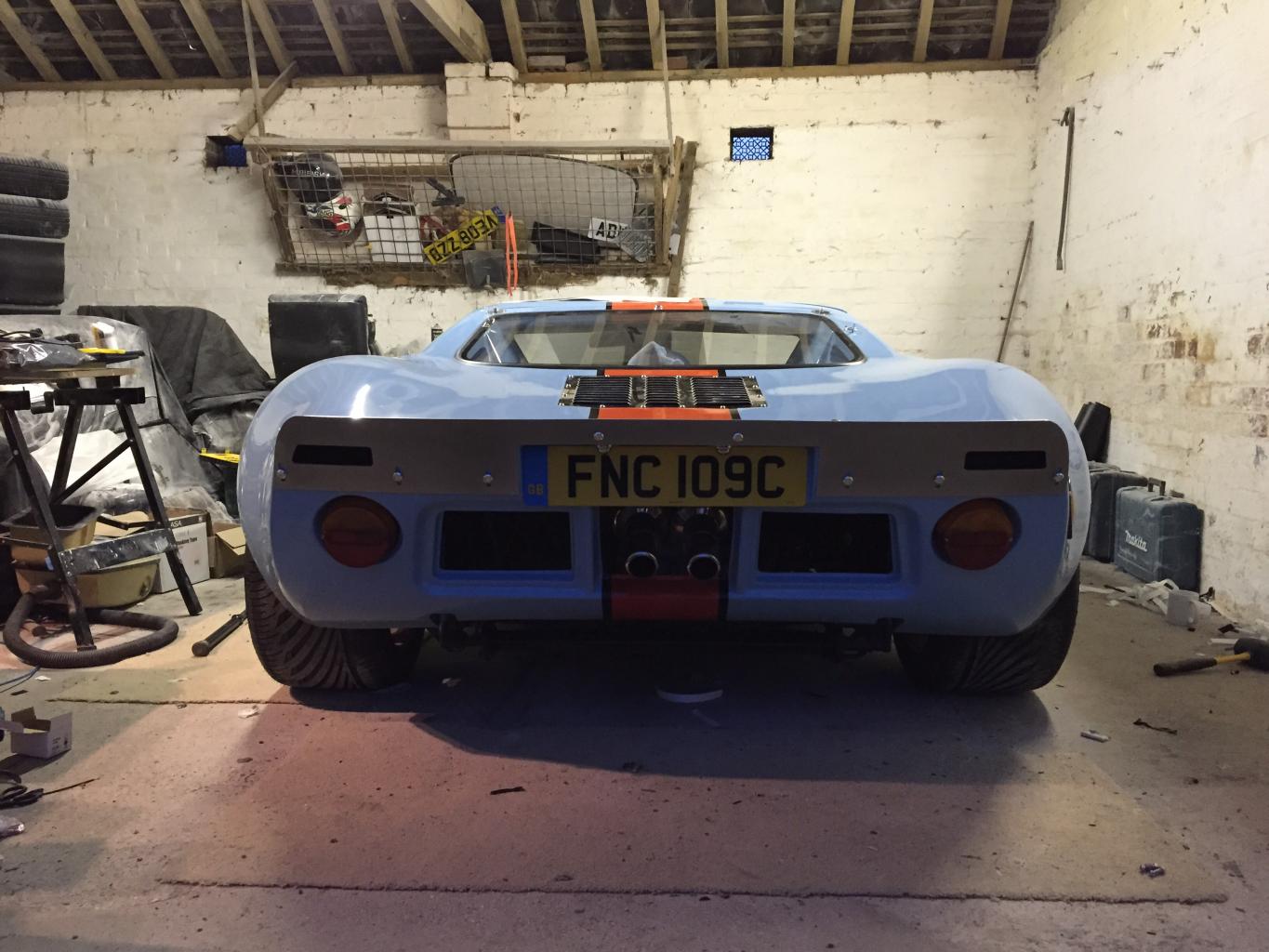

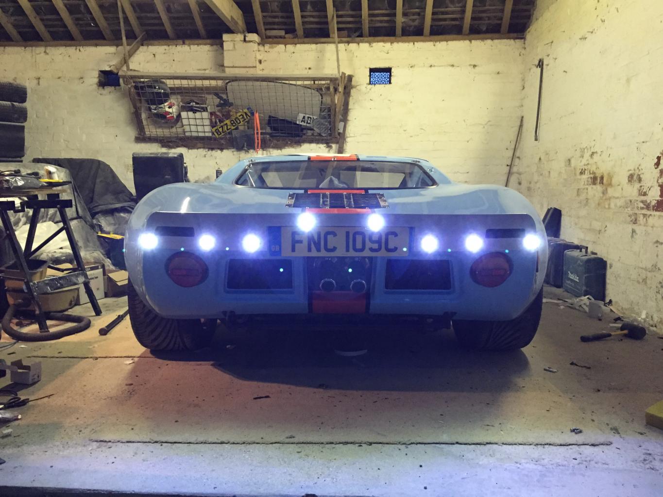

Hi - here's what I did
I used angel eye led bolts to hold on the spoiler. They are lightweight aluminium bolts with small LEDs on the ends. Works well for me as they provide hidden reverse lights

Thank you Markus, they will go on order next week.
