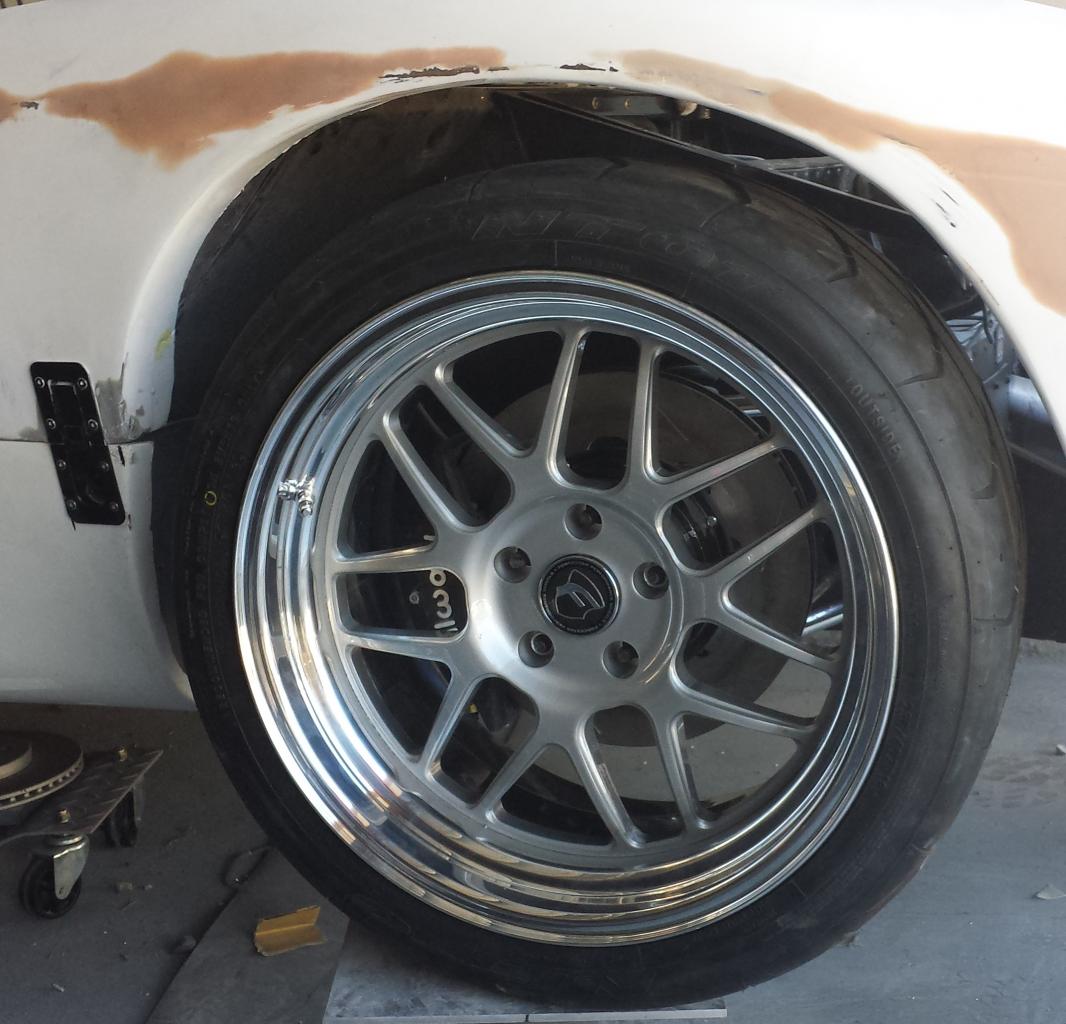

That 24.6" tall up front worries me as the shortest tire I see available for my wheels is 25.39. So, that's .395" per "side" difference. Hopefully that won't be an issue. I'll order in a 235/40/18 and verify as soon as I make sure the rears are good. In reality though, even if the 235/40/18 is a bit too tall, that's the shortest one I can go with without going to a different brand of tire as my wheel is too wide for a 225 (and I really don't want to go that narrow anyway).

I didn't have any problem at all with the 235 and I think the 245 will fit and actually look better with my wheels (9.5" wide). Probably just get two of those in and try to sell the 235 one I mounted. I am ordering a shorter rotor hat though to set them in 3/4" as they do sit out a bit too wide. Not sure why I originally got such a tall hat but glad I did now as this is an easy adjustment.
Thanks for your help.
