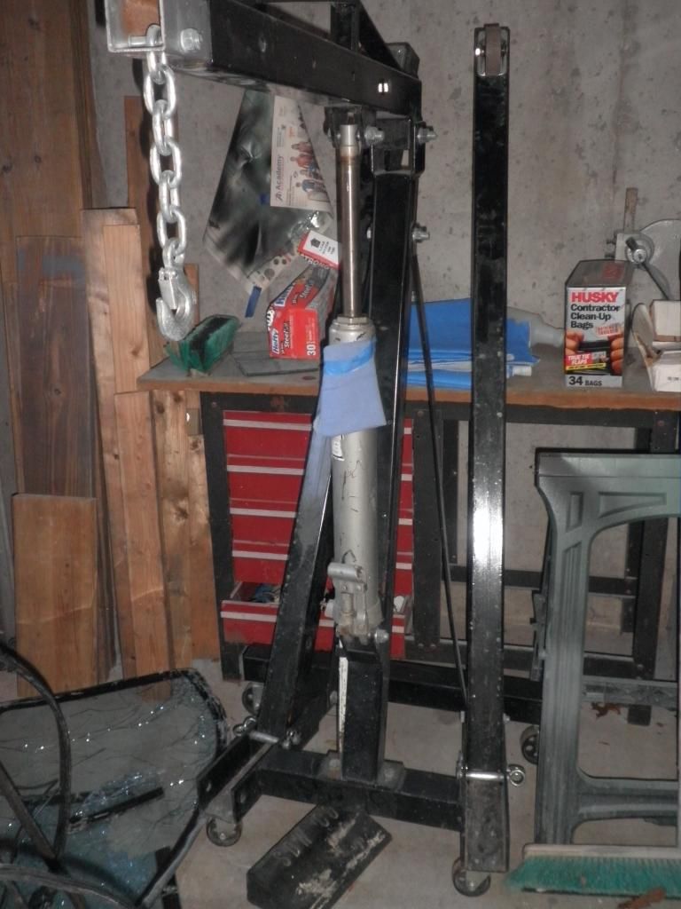

Mine is just the opposite. I have used it for over 15 years and not the first bit of trouble. Other than snug up the bolts occasionally. Even when I forget to store it properly it never has leaked down. The arm remains in the last position used. Still has the bumper pad from the last time I removed the rear clip. As seen here:
As you can see it is well worn. I guess this is a reminder to get into the shop and do a bit of cleaning up!!

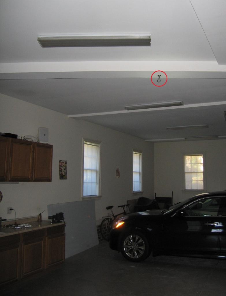

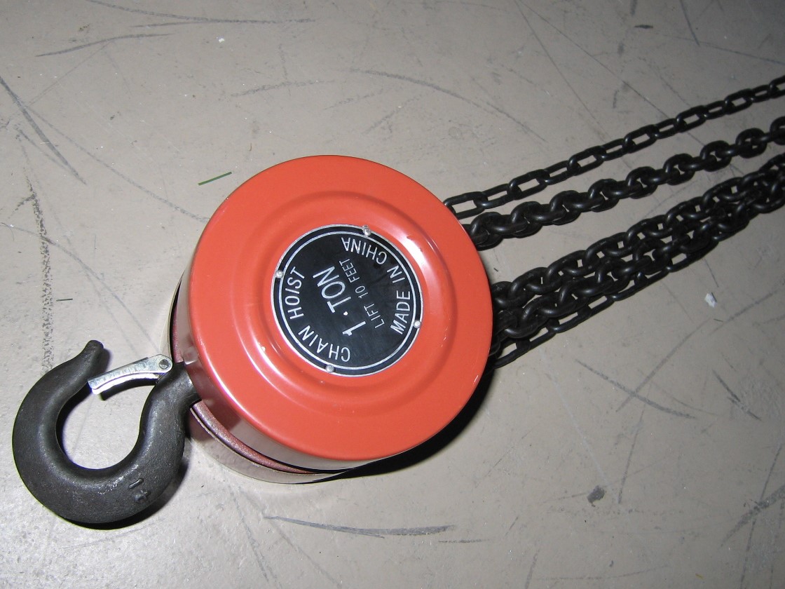

  • Do you have a strong structural member above the garage that can bear the weight of an engine/trans? When I had my home built, I had a steel I-Beam put in the ceiling of my garage. I then installed a 1 Ton Eye-bolt and bought a smallish 1 Ton chain hoist. The combination provides a 2x-3x safety factor when lifting a typical engine/trans. The chain hoist is stored in a cabinet in about the same space as a 12 pack of beer.
