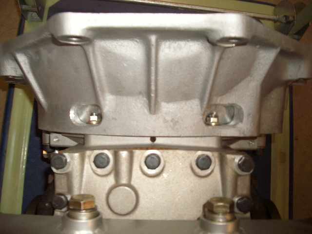

Only if someone has machined holes in the top of the bellhousing to access the two top bolts. There are 5 bolts that come from the outside and 2 that come from inside the bellhousing.
Pat Buckley
Like this

I thought about doing something like that, but since I don't plan to remove the transaxle very often I will deal with the removal like I did it yesterday. We separated the Trans from the block and pulled it back enough to reach into the bellhousing and removed the two bolts with little fuss. Then slipped everything out from under the cross member.
I would most definitely make that modification to the bellhousing if I had a ZF.. If for no other reason than to offer a bit of ventilation for the clutch's heat...
If your going to dial indicate your bell housing to ensure its concentric with the crank & trans...and I strongly recommend that you do, given the comments of others who have had similar issues... the few minutes it would take to drill those holes will make life so much easier as once you have checked / rectified the runout if any you would be best to leave the bell housing on the engine & simply bolt the trans up by itself.

Like others have stated, cutting the holes is worth it. It cuts removal and replacement time gobs! The other trick I learned from John Schriver is taking long bolts cutting the hex heads off and using them for alignment pins in the bell housing to reinstall the ZF more easily.
This trick works equally well if you have your bellhousing attached to your ZF; you just thread those long pins into the holes in the back of the block, hang the ZF on the pins, slide it forward, and with perhaps a tiny amount of turning the output flanges, the input shaft slides right into place, no muss, no fuss. :thumbsup:
