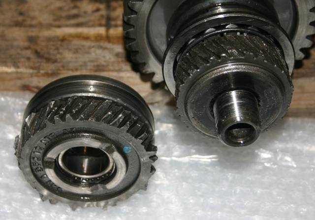

I am looking for a long .76 fifth gear set for my UN1 gearbox.
Does anyone (preferably in UK) have a pair of gears that they want to sell? If so, how much?
These any good? /ubbthreads/images/graemlins/grin.gif
No - Then I guess we need another set too! - (doh!) /ubbthreads/images/graemlins/frown.gif
Try Chris Cole of Mach-1 transmissions too - he sells 'long 5th gear sets' - 01952 222155.
Also - if anyone knows whether a longer set (than .76) is available - please speak up.
Hi Bud - too much I guess! - /ubbthreads/images/graemlins/grin.gif
Seriously though I'm not too sure - We were last using the car at the trackday Malcolm arranged at Goodwood last November and noticed we had no 5th on the day, but thought it was possibly just a selector problem. (will be more cautious in future).

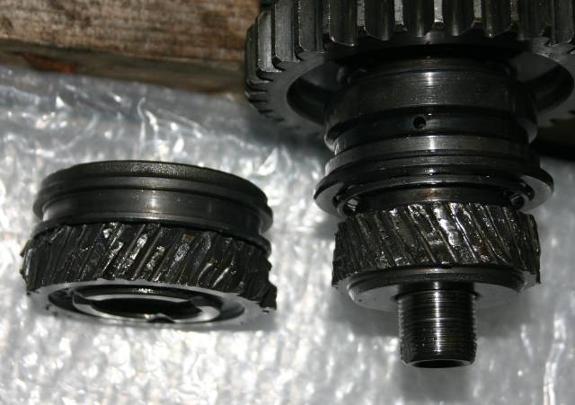

Another view.
With that kind of power your only hope is pressurized oiling to the gears. Charlie Seabrook was runnining a high HP windsor stroker some years ago. His fifth gear was good for about three laps when he ran on the Pocano road course, which has one turn on the high speed banking. He ended up with a ZF in a Safir and retired his GTD to street duty.
Funny you should say that Bud - Roy was thinking of modding the box to 'oil' the gears and diff individually by fitting external scavenge pump, feed pipes etc etc. Inspired possibly by the Porsche conversion previously shown elsewhere on the forum.
