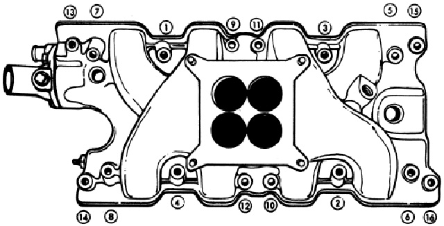

I agree with the RTV end seal method with just a little around the water crossovers at the rear. Torque in correct sequence. All around to 1/2 spec then the other half. I use 22 ft/lbs. first 12 then 10 more. The range of everybody else online seams to be from 18-27 or so.
Here's the install PDF from edelbrock
http://www.edelbrock.com/automotive/misc/tech-center/install/7000/7121.pdf
