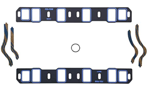

In the past I have used Fel-pro 1262 S3 ("Printoseal") and been pretty pleased - no leaks. I've tended to use a very light smear of RTV on both faces of the gasket, and this seems to hvae worked well.....however, it's a drag removing the RTV next time around when the manifold next needs to come off for some reason.
Do folks recommend installing the Fel-pro gasket with RTV or dry or ?? Prefer to install dry, but don't want a bunch of sealing problems.
Thanks in advance

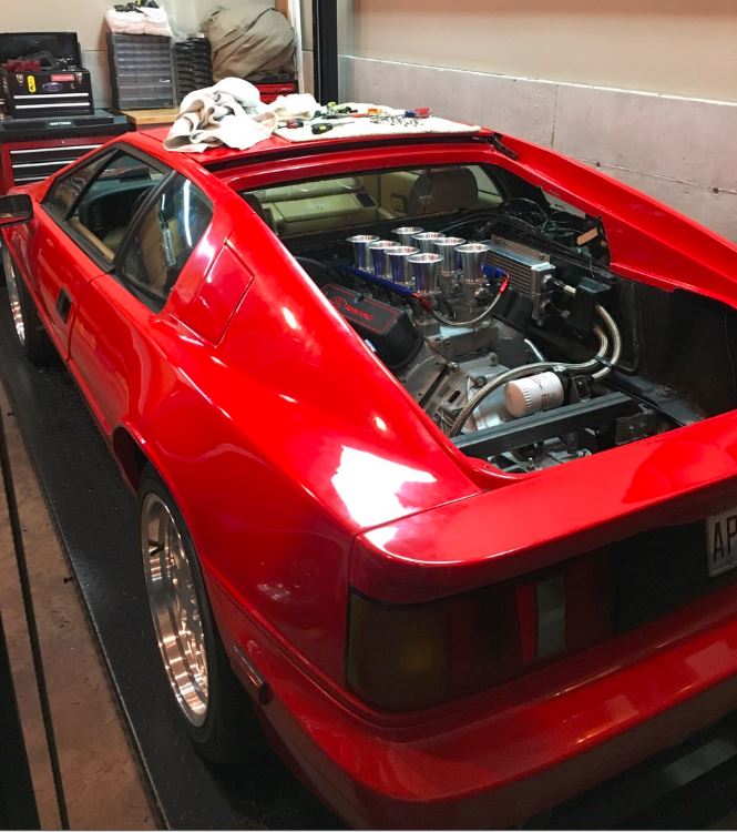

Neil - good suggestion.....I actually did ask Fel-pro and they said put them on dry other than a dab of RTV in the corner by the front/rear end rails. Just a little concerned about leaks if installed dry...hence the question/thread here. My car has 8 stack EFI and it's a real pain to remove the manifold if there's leaks....
