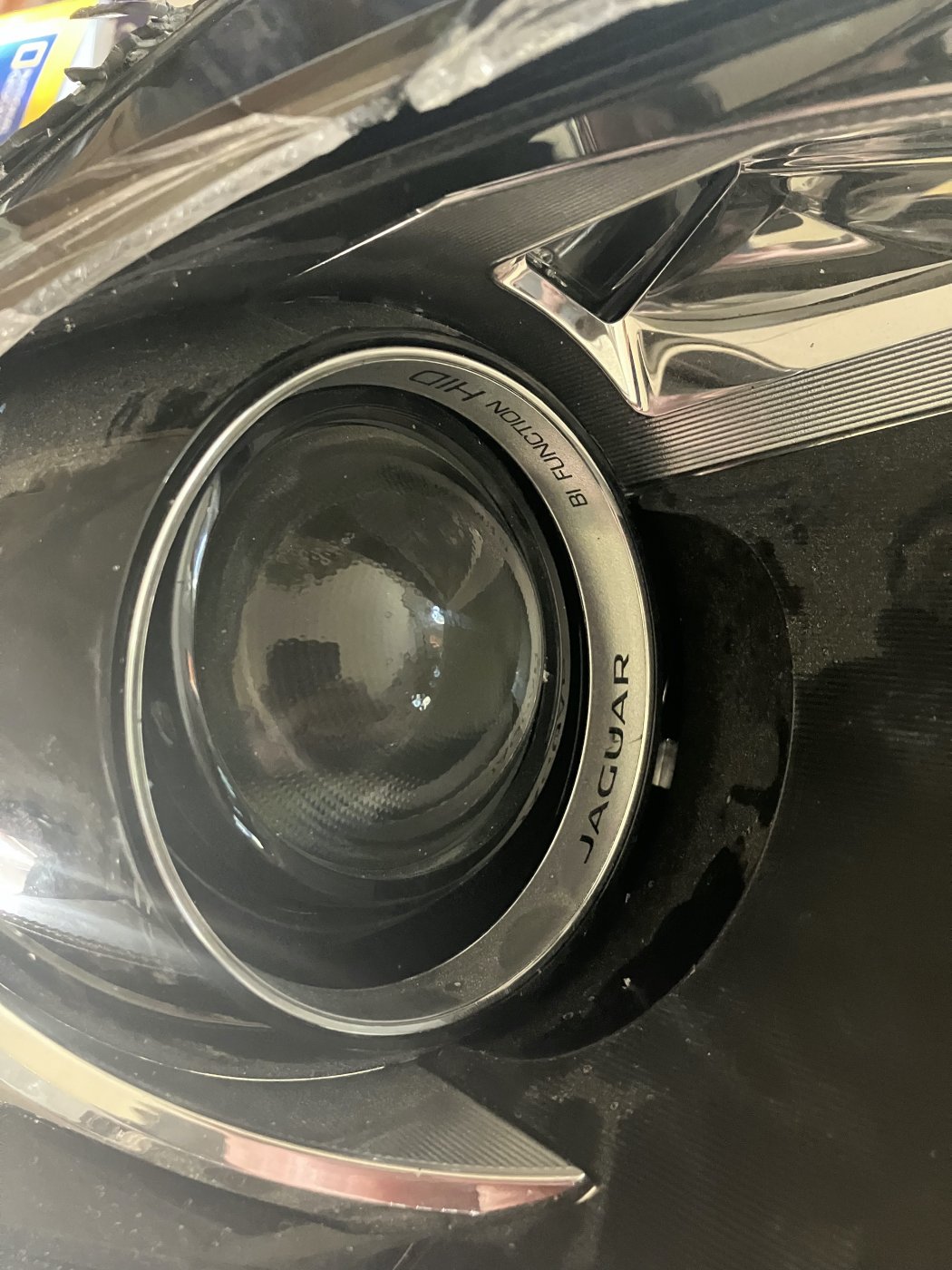

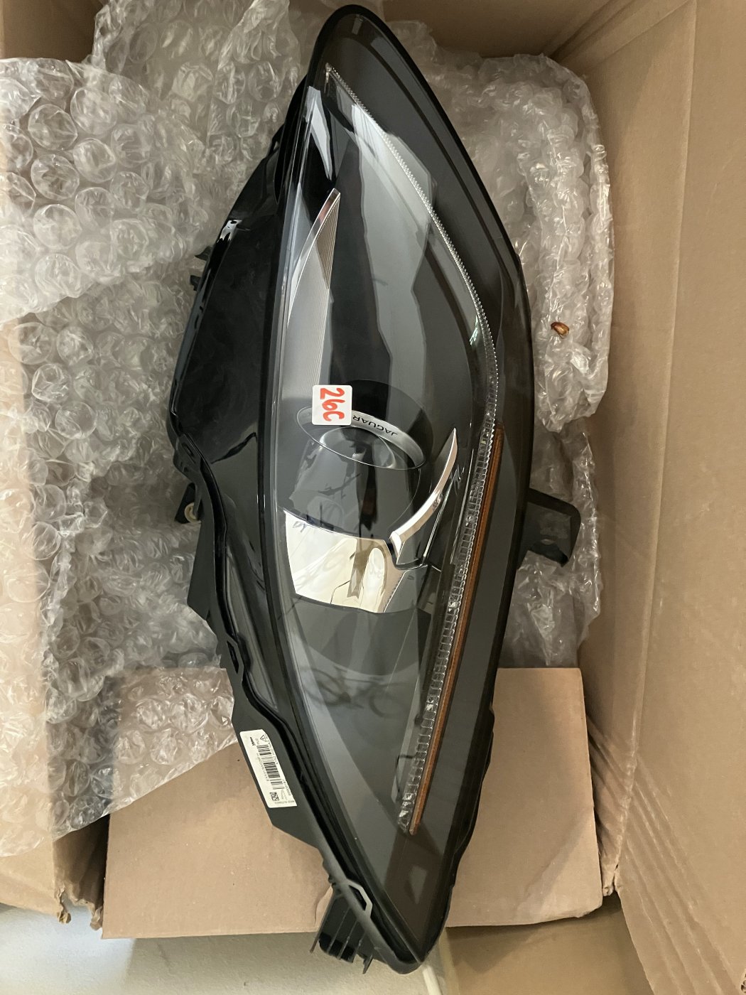

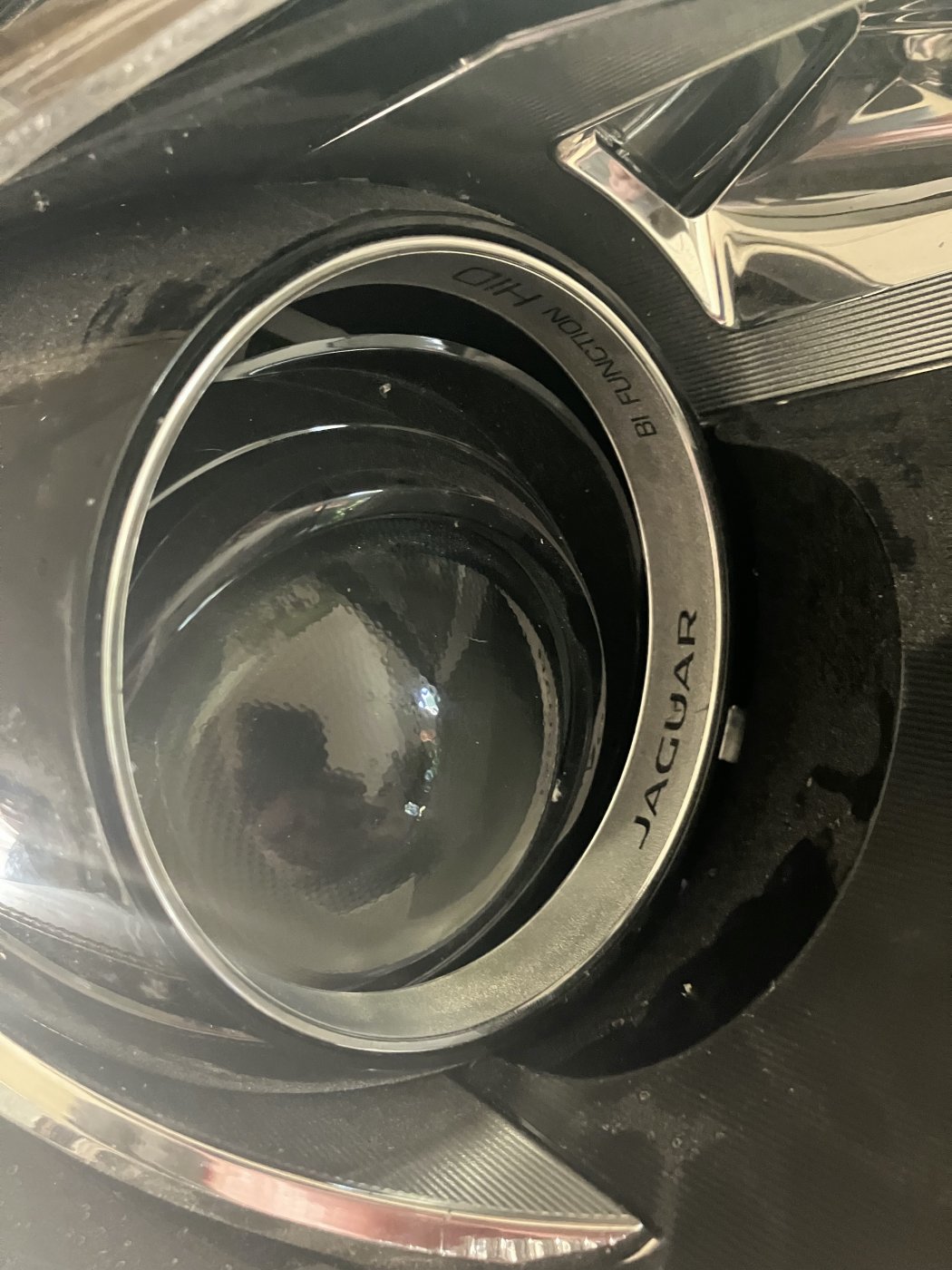

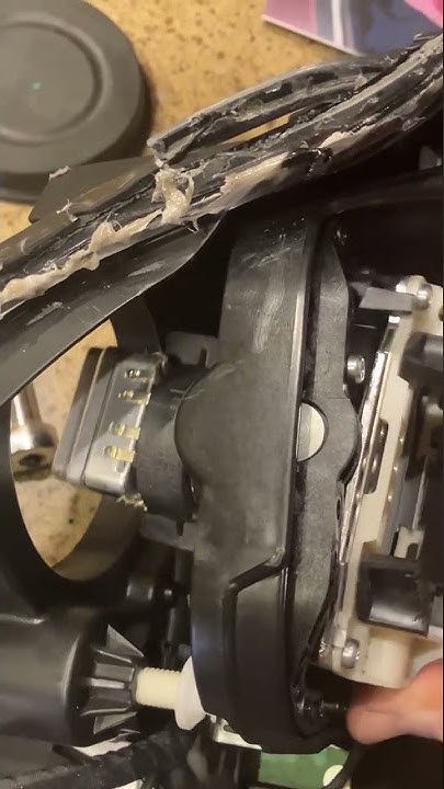

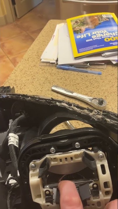

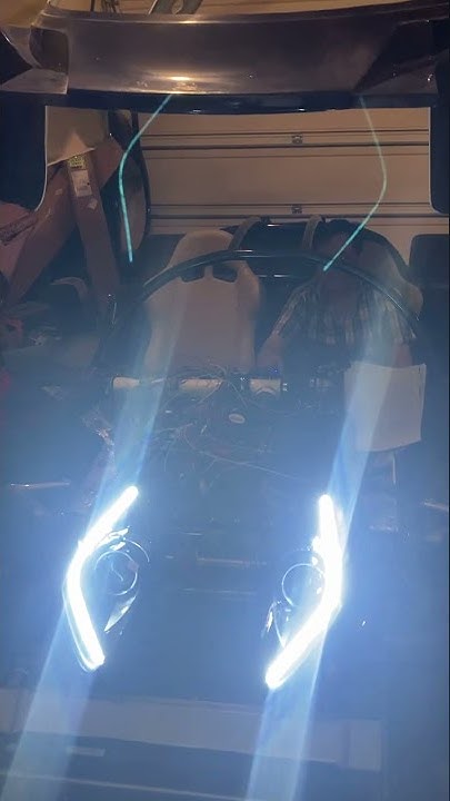

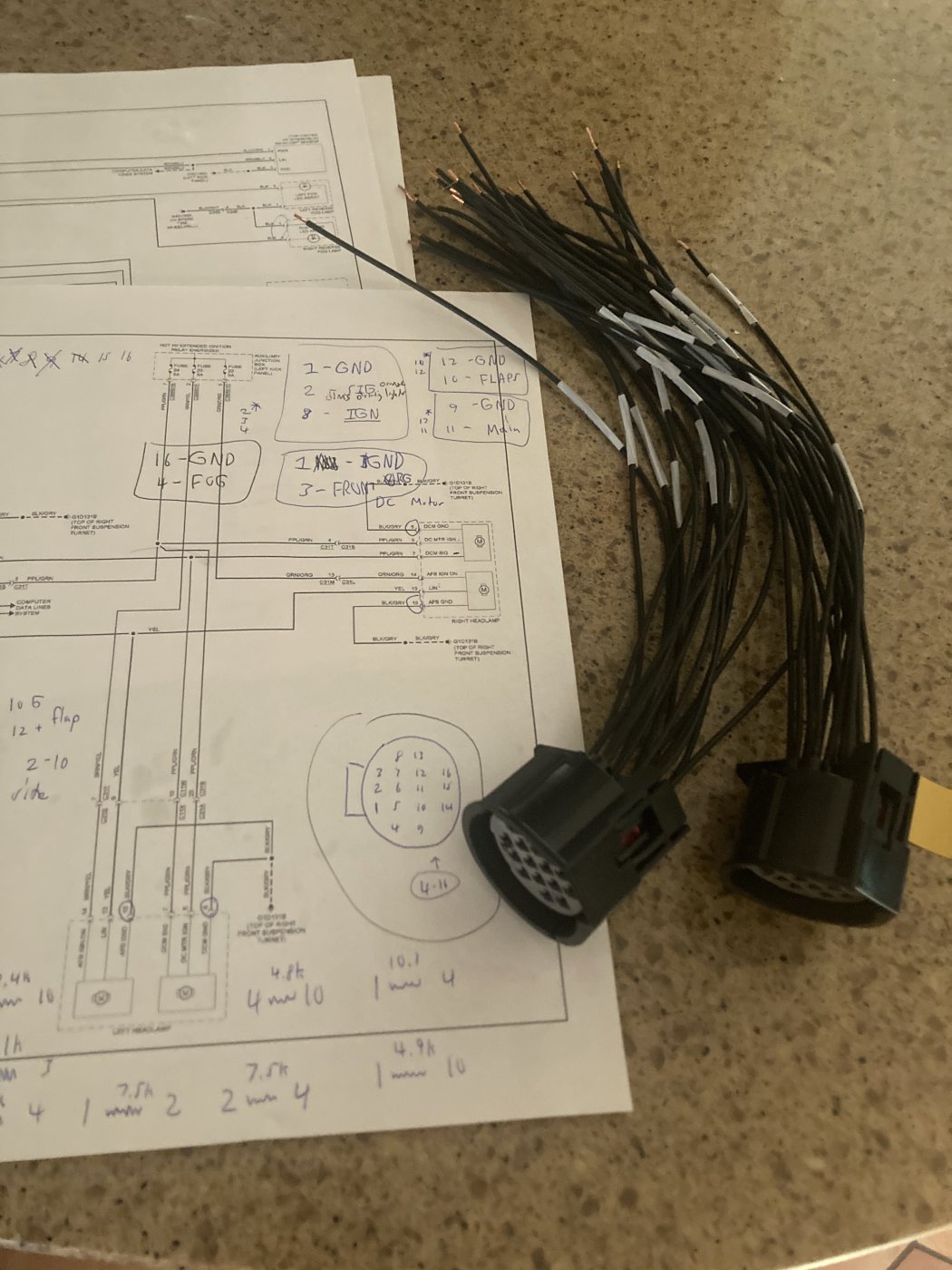

And finally you guys are completely updated on my progress. this weekend Miguel and I spent mapping out the jaguar F type 2014-17 pigtails. I have a wiring diagram, but I could not find the pig tail wire order anywhere , it took a while but Miguel figured out the correct numbering of the pig tail vs the wiring diagram. they are adaptive and have a motor that turns them when you turn , so there are 16 wires to figure out .
Scott did extensive work on these headlights and the bottom line was that the lights point much lower mounted on the SLC than on the jaguar .
However I figured out that the interior assembly has a massive amount of adjustment (I have a cheap broken one that I took apart ) and I think I can make it work, it will be at the limits though, fingers crossed

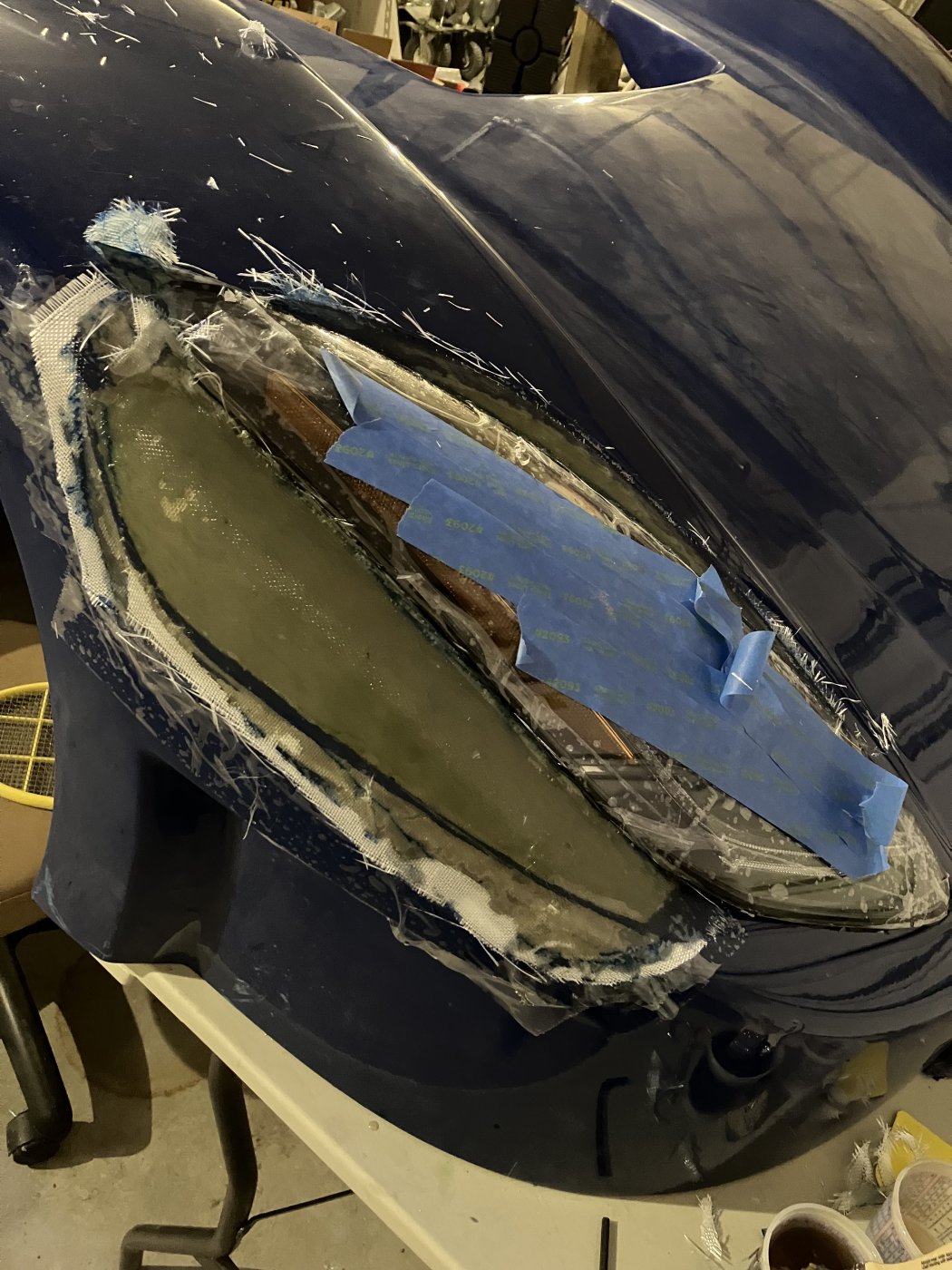

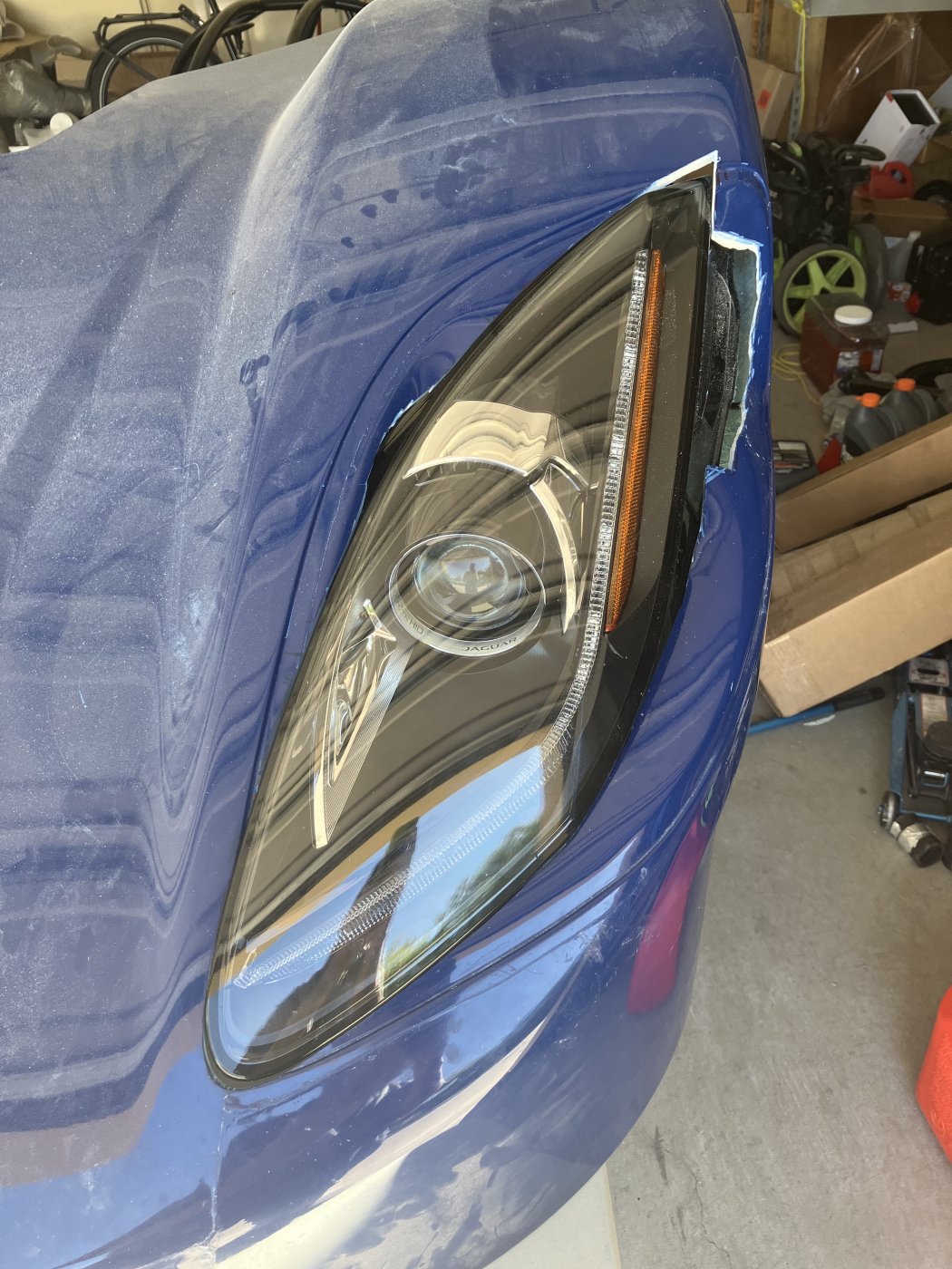

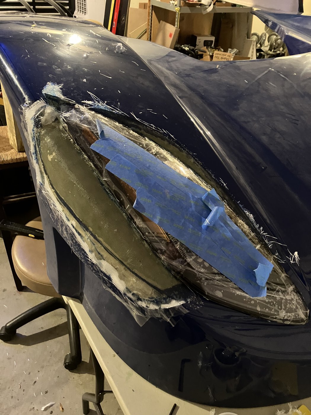

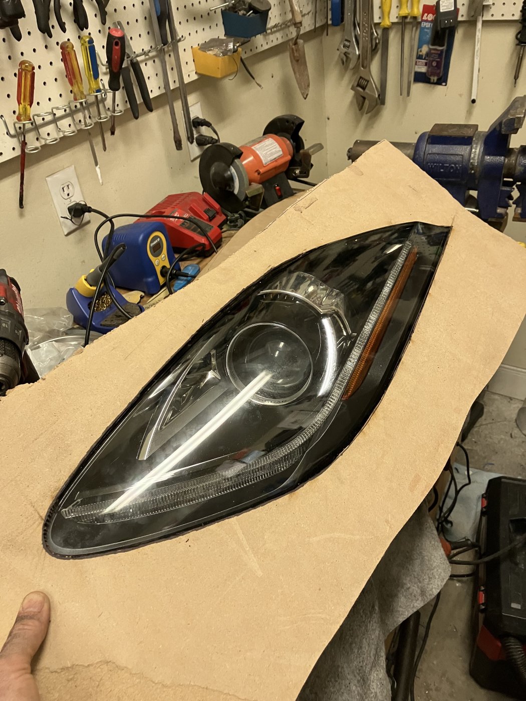

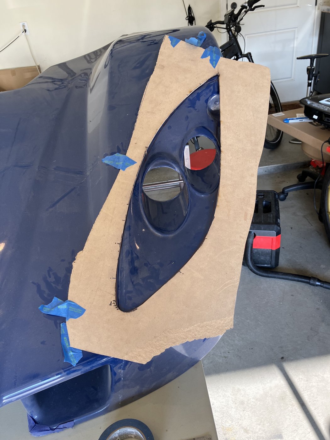

Well, finally finished the headlights . It took much more work than I imagined , but very happy with the final result . Here is a chronological detail of the work best I can remember.

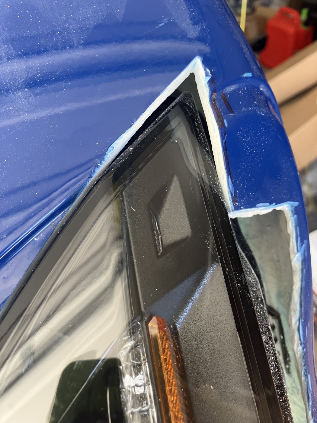

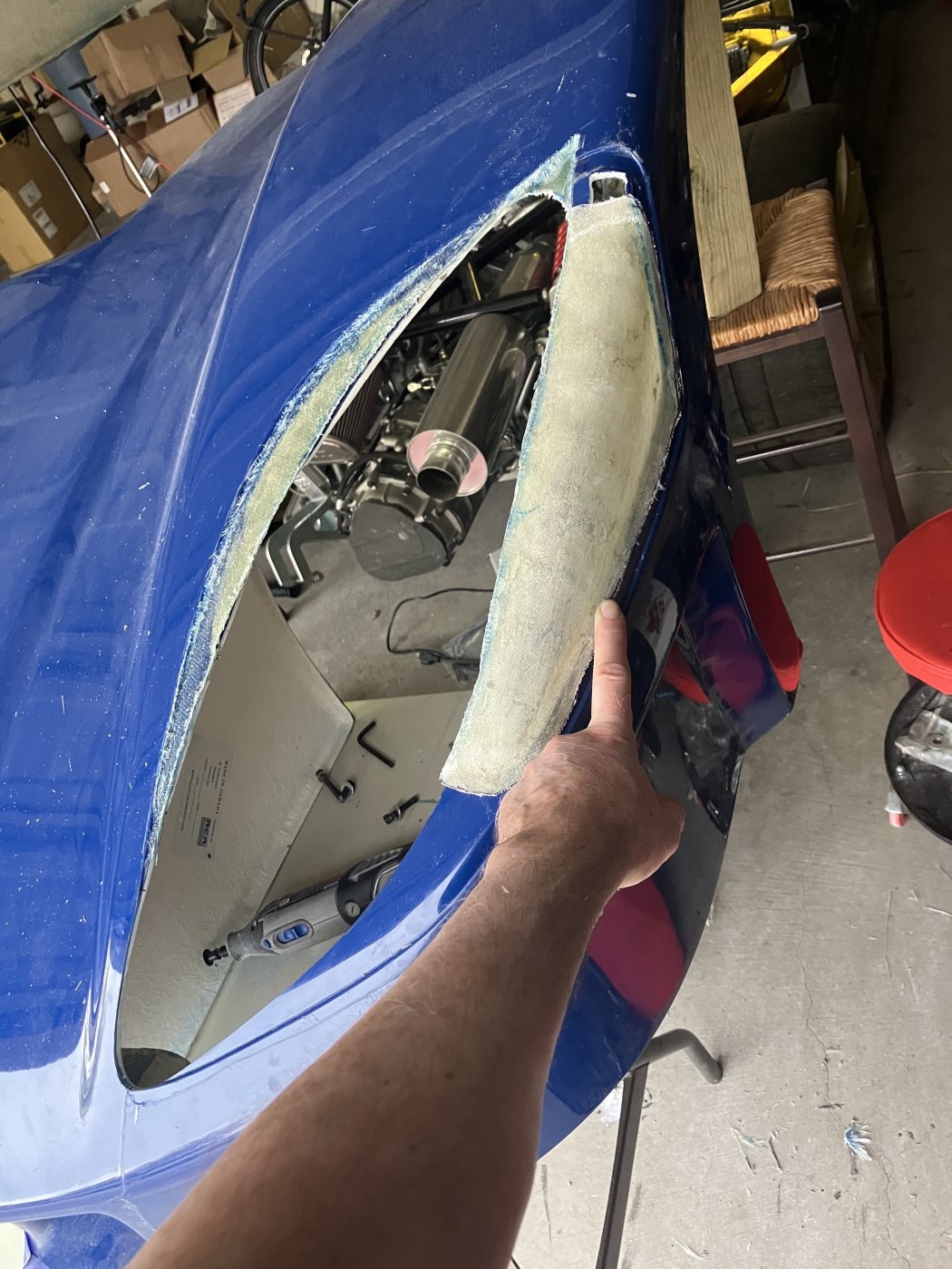

1. got a one plane contour of the headlights in order to cut the front clam, I had already figured out the right orientation, and the fact that the contour fit very very close to the original headlights. No turning back at this point :) . Do or do not, there is no try -Yoda

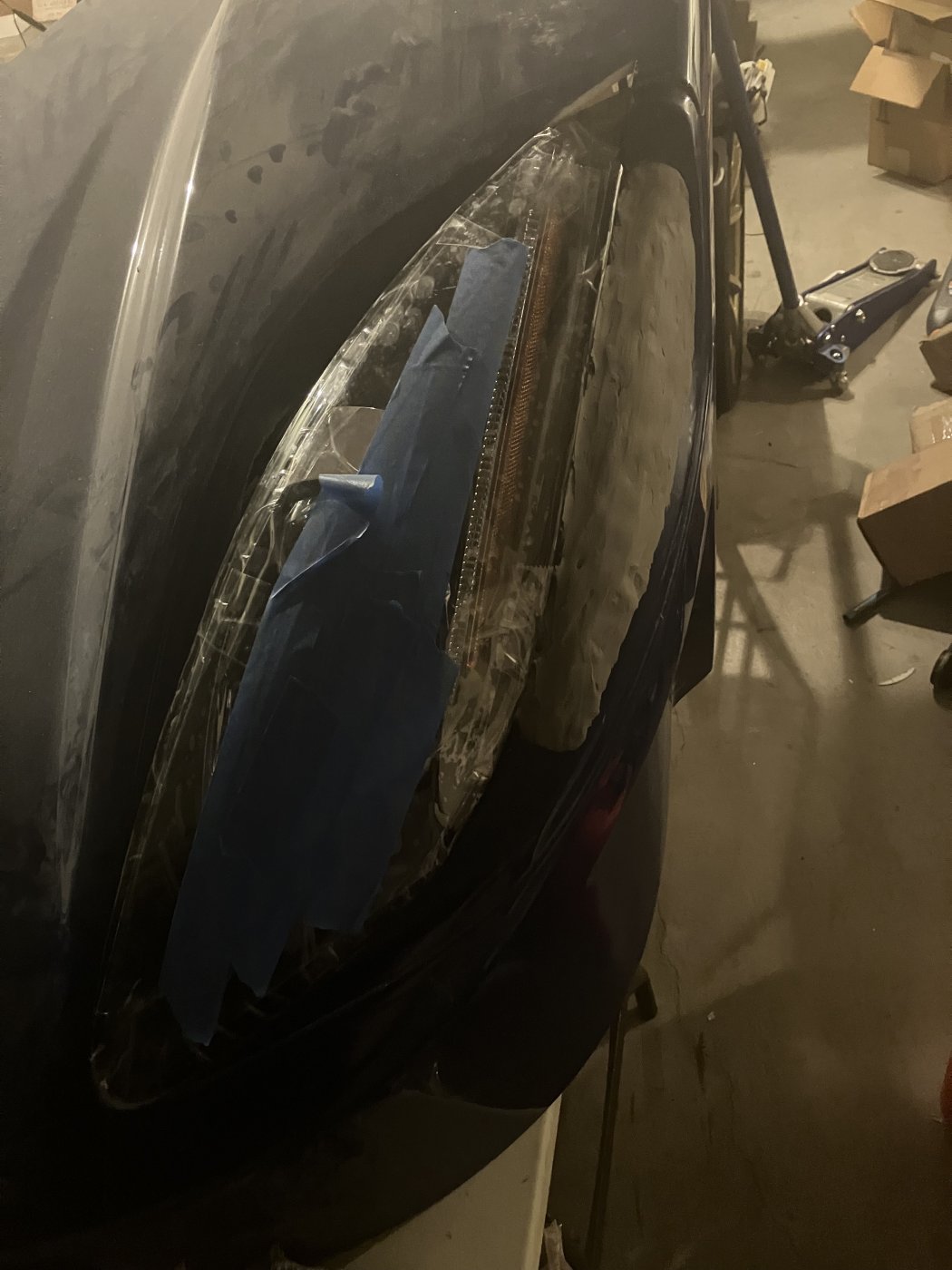

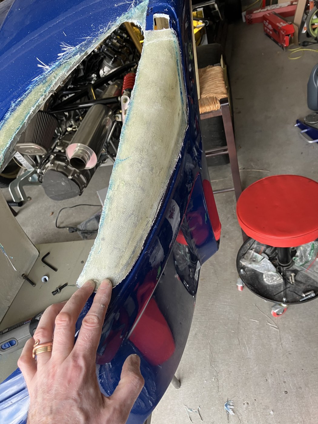

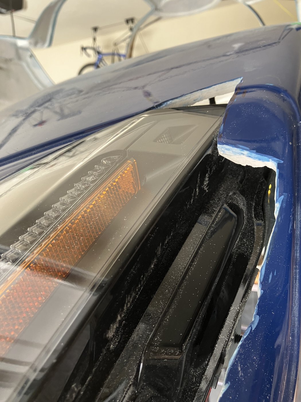

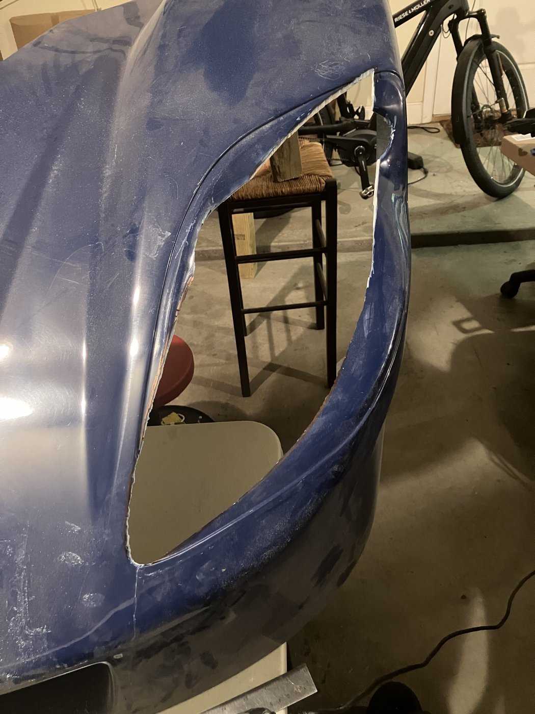

The challenges ahead were laid out at this point, had t cut off more than I anticipated in order to make the large headlight housing fit, so, the entire outside corner would have to be redesigned and built, blending curves and contours, not a trivial task at all . Some compromising had to be done. a little recess would present at the top, and a small step was created, Also on the middle contour, I followed the contour and built up the side, first with fiberglass, then finished with Bondo. I choose to add a small vent to make it blend nicely . It is very hard to describe with words and pictures don't do 3D perspectives justice. I hope you can see it in person sometime.
A big thank you to Joel for sharing a picture of a yellow Noble with C7 headlights that had a similar recess on top and a Ferrari with vents around the headlights. Both were invaluable in coming up with the final design

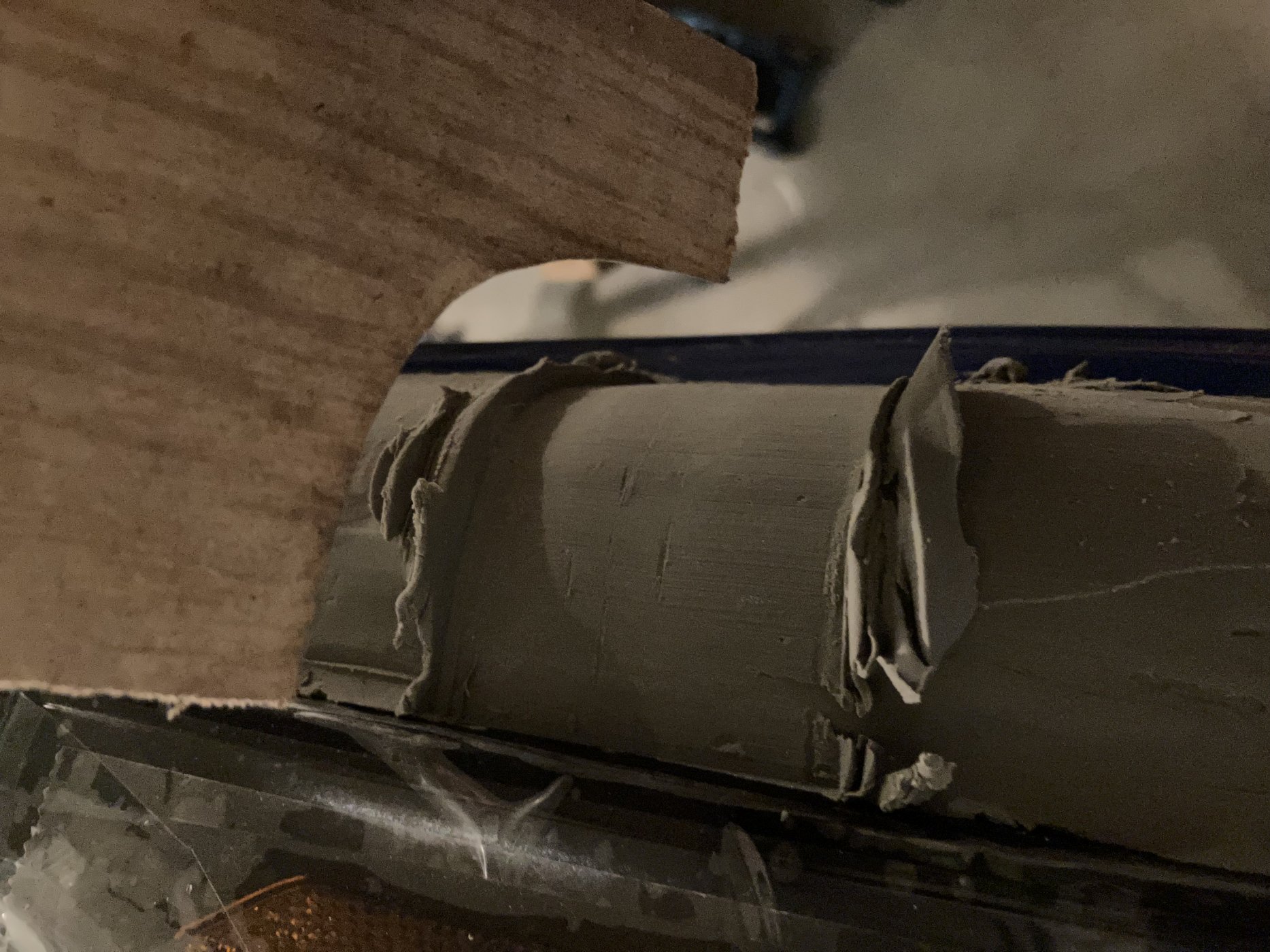

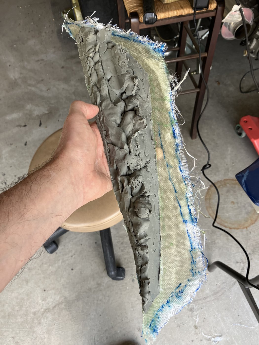

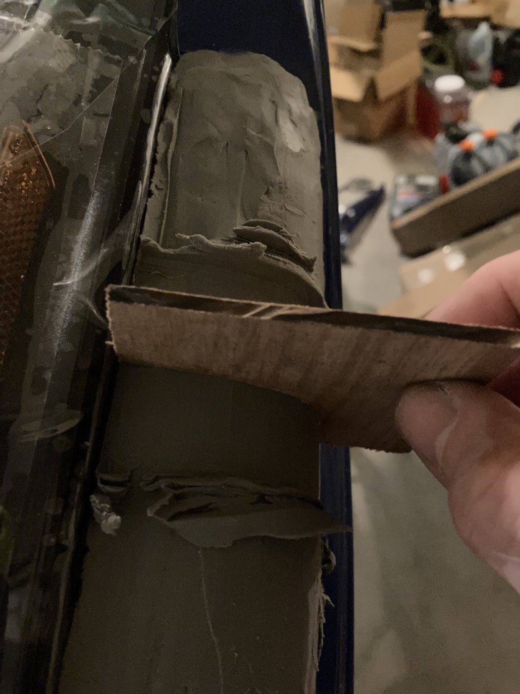

Next step was to create the final contours on the outside corner and the middle using clay. I created a plywood template using the outside corner of the clam above the headlight as the guide, then slide the template through the clay to create the final shape. then lay down several layers of fiberglass to create the final piece,

Then trim the piece, attach it to the clam and build it up with more layers of cloth to match the thickness and strength of the clam and to creat a final shape that would need a small layer of Bondo .

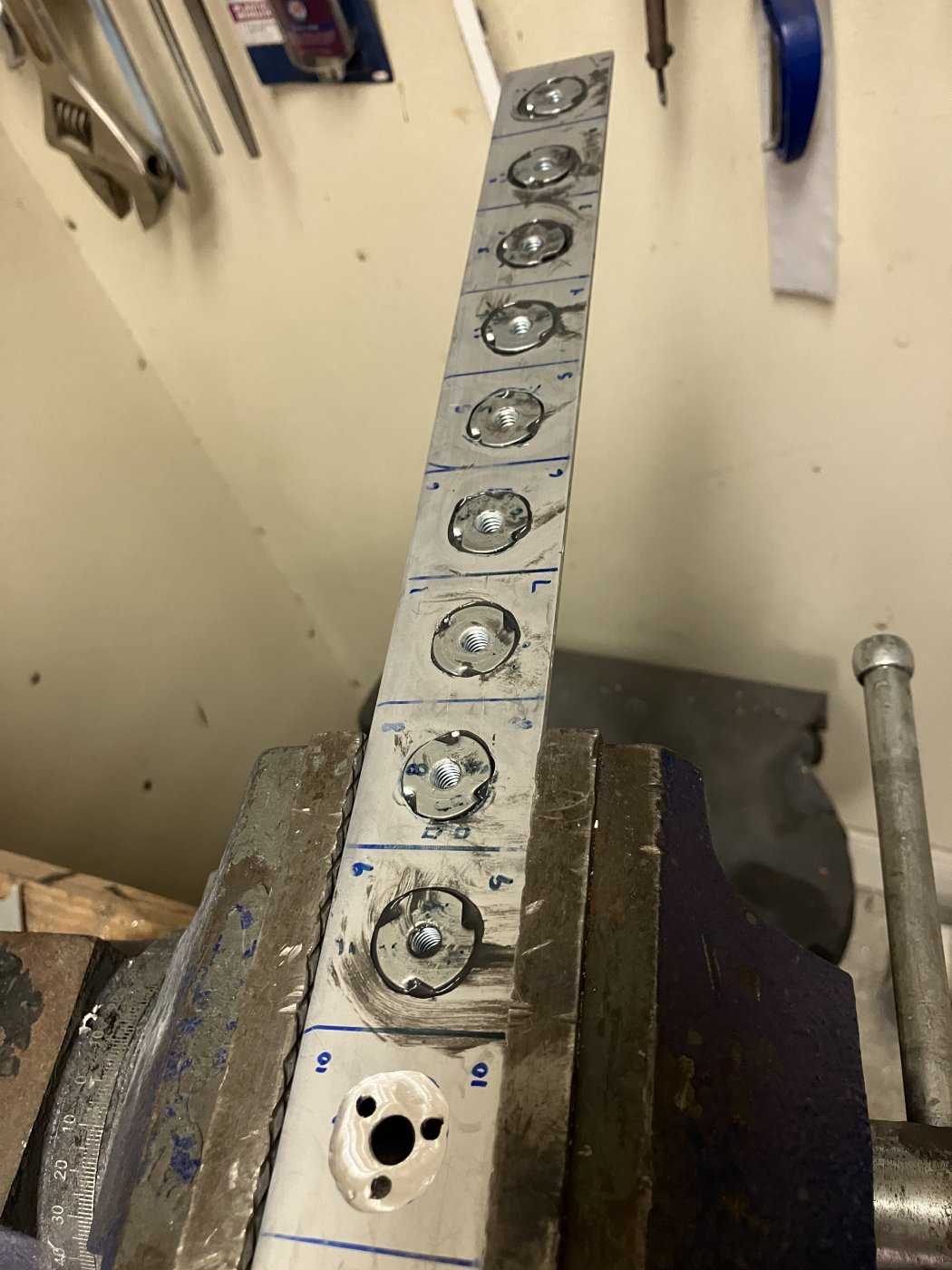

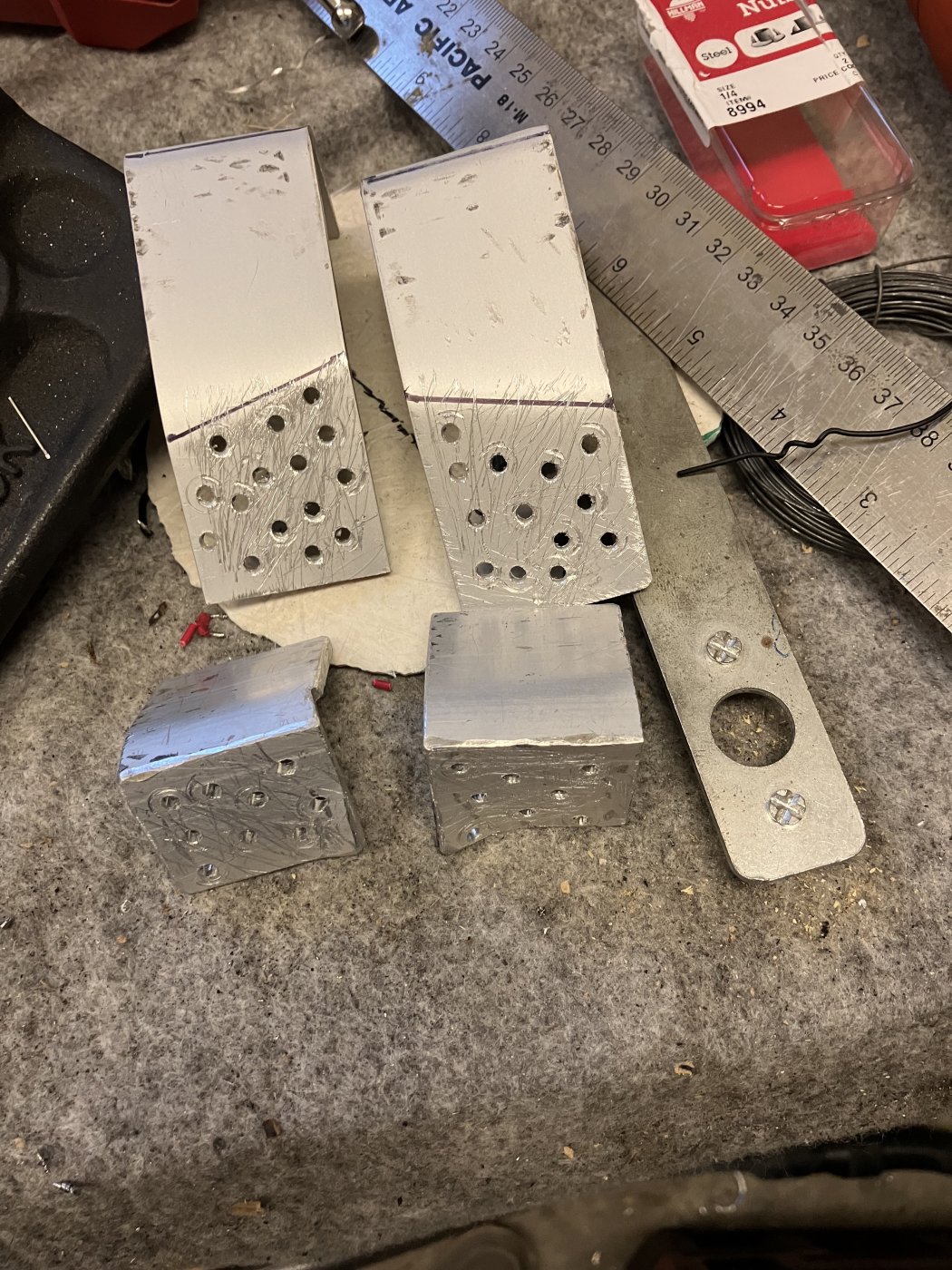

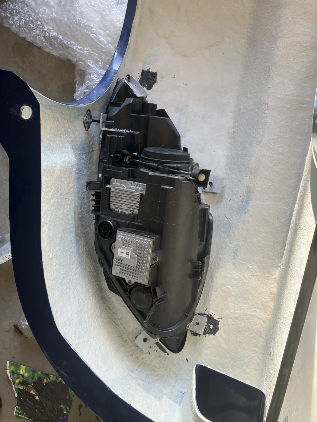

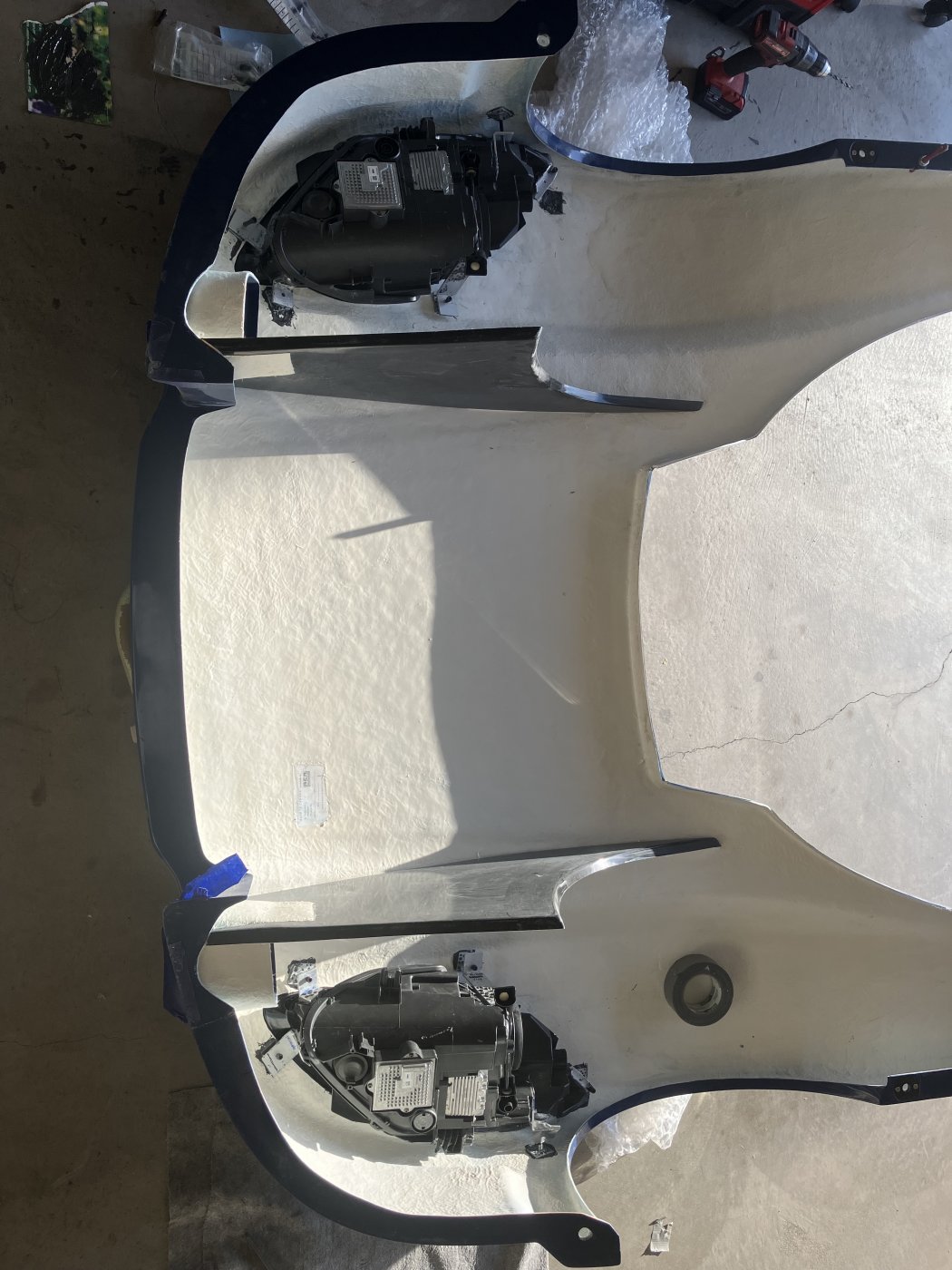

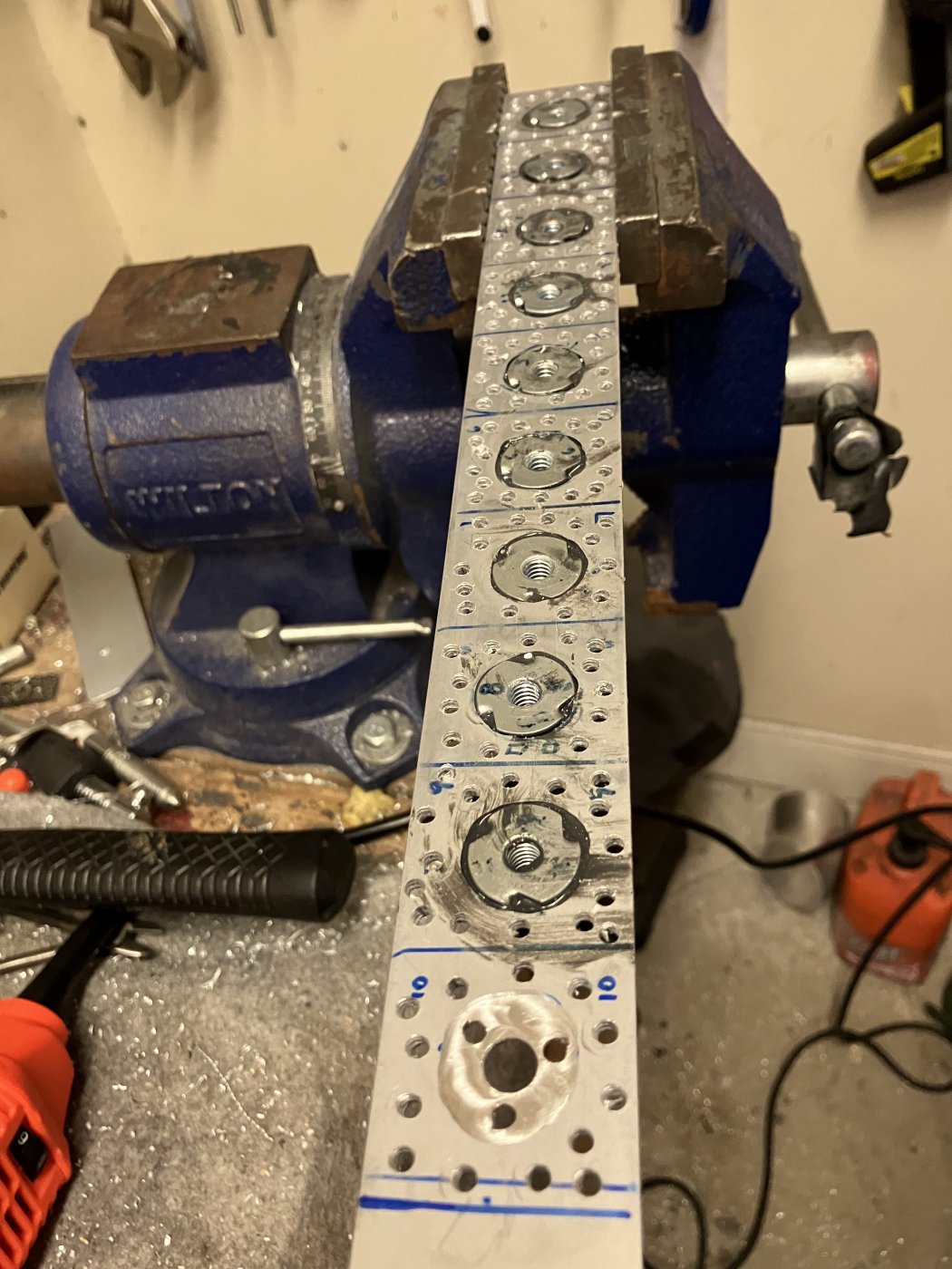

Next I had to figure out how I was going to attach the headlight to the clam. after some trial and error and some testing I settled with T nuts attached to a square aluminum plate, I used a router to create a recess where the T nut fit into the aluminum plate, then bonded the T nut to the plate with epoxy . the plate then is bonded to the clam with epoxy as well. . I tested the strength of the bond and I figured 5 tabs would give me enough factor of safety.

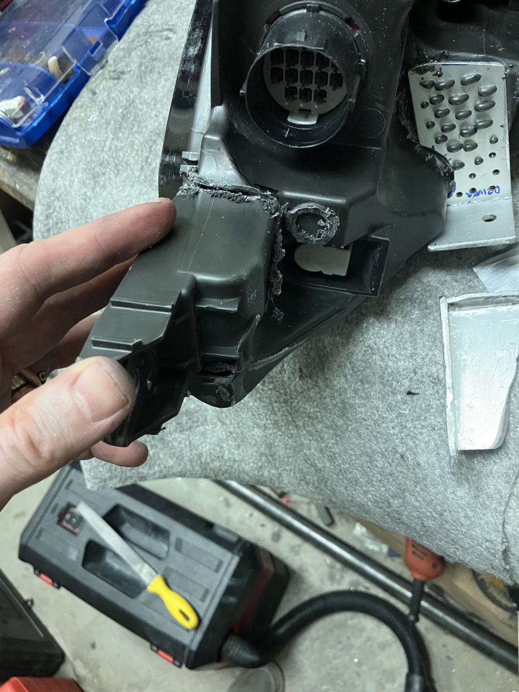

5 aluminum tabs then will be bonded to the headlight assembly. Unfortunately I could not use any of the original tabs, had to be removed.
Obviously the tricky part was to choose the right location for the 5 tabs and to make the assembly fit perfectly on the clam.

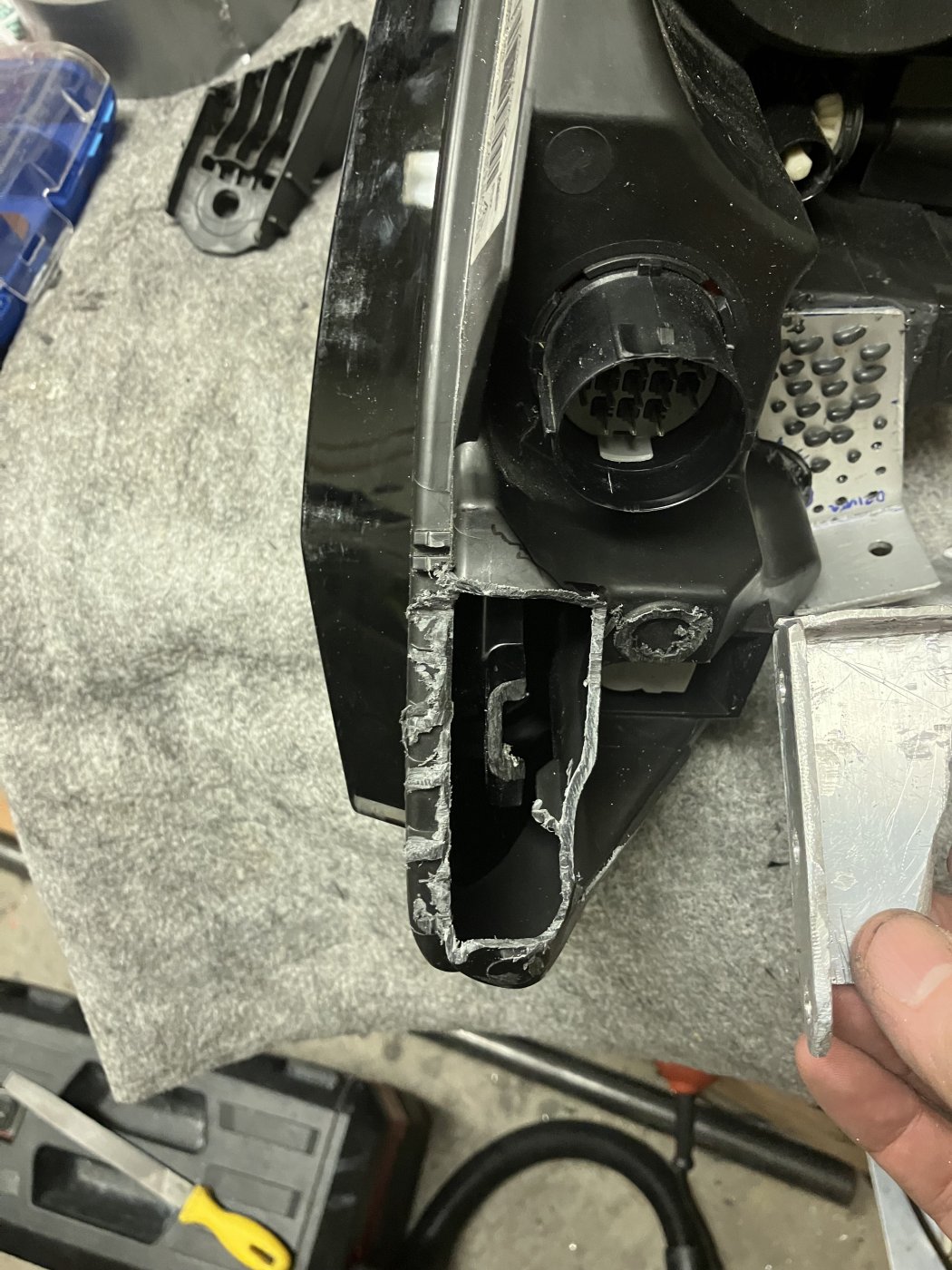

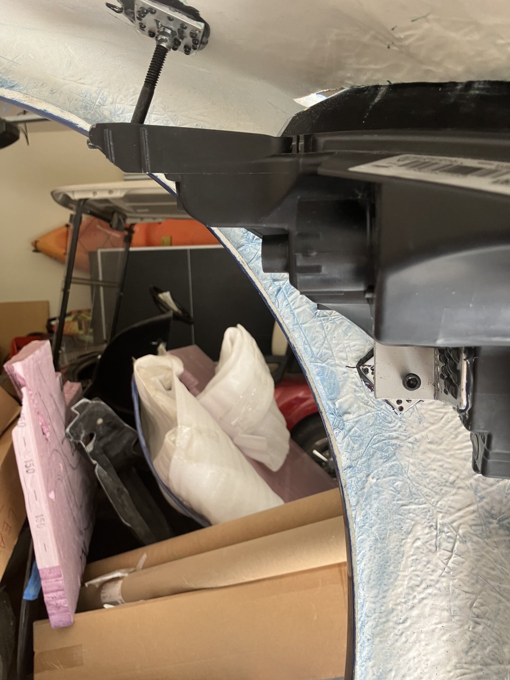

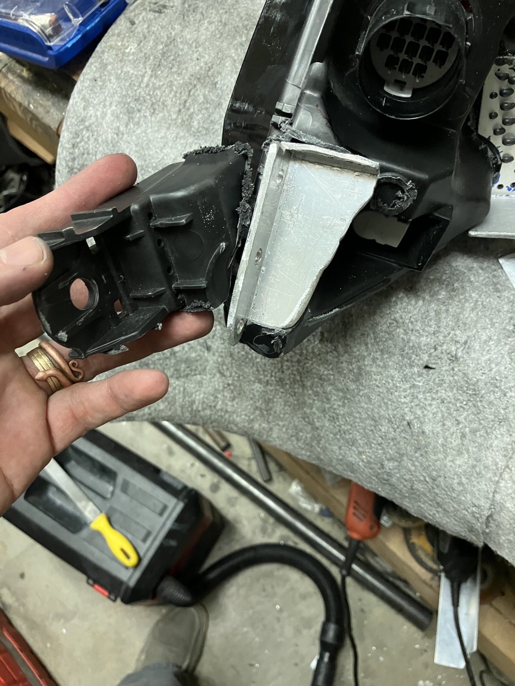

Well everything was coming along nicely until I noticed that the assembly was probably going to rub on the tire, or at a minimum interfere with the liner above the tire. so I had to cut off the assembly and make an aluminum close out plate that will also serve as a mounting tab . I got barely enough room. Dodged a massive bullet there
