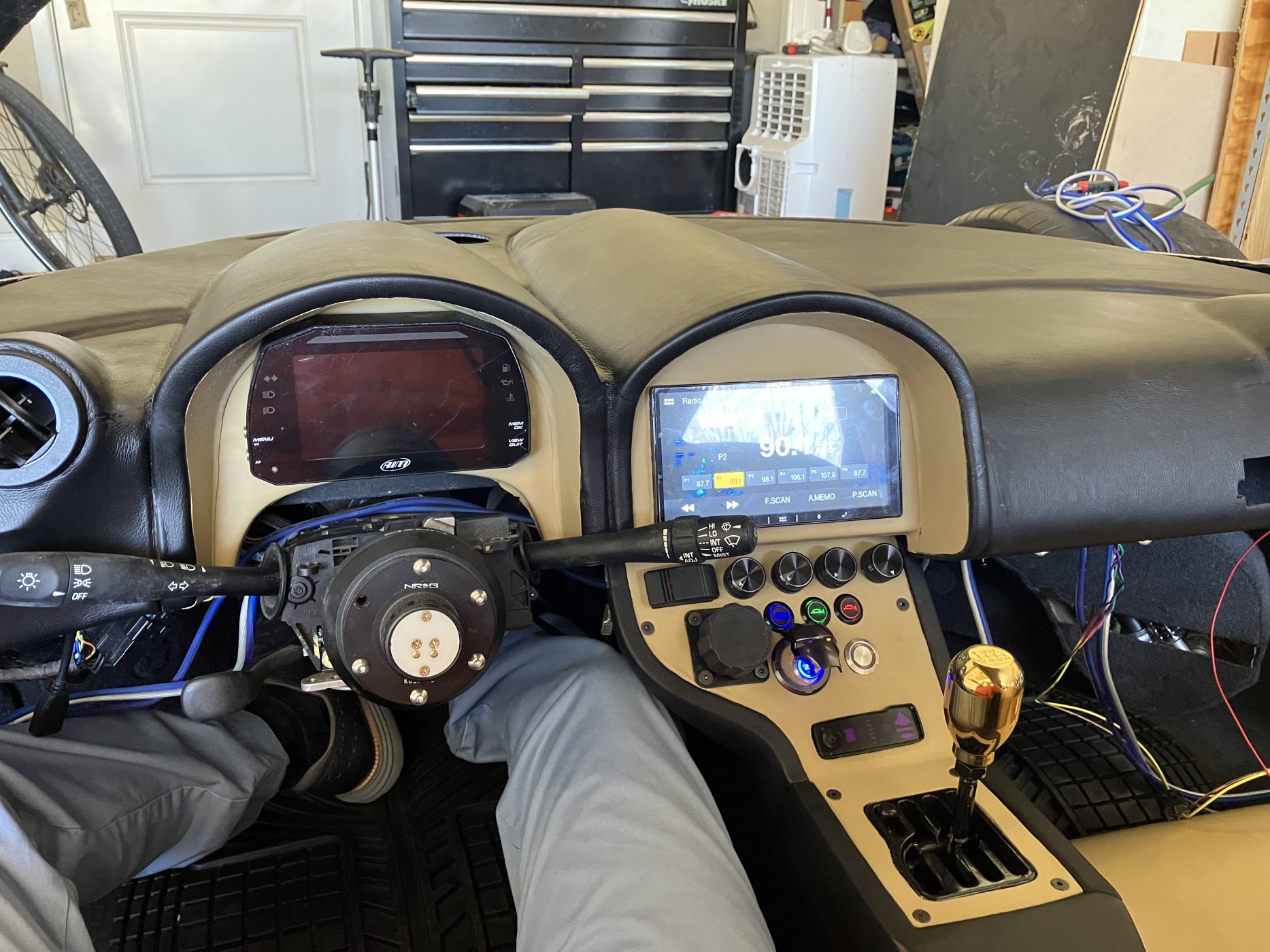

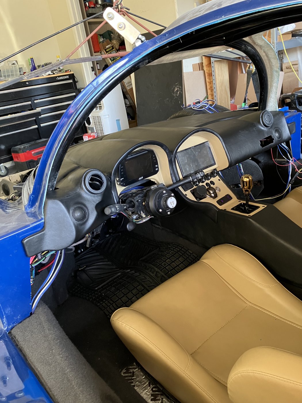

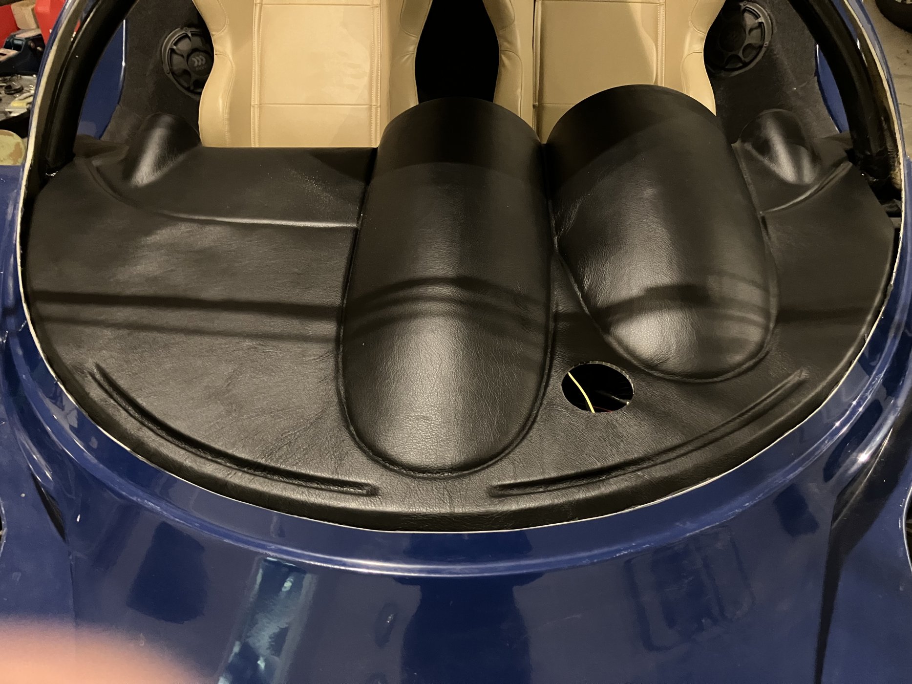

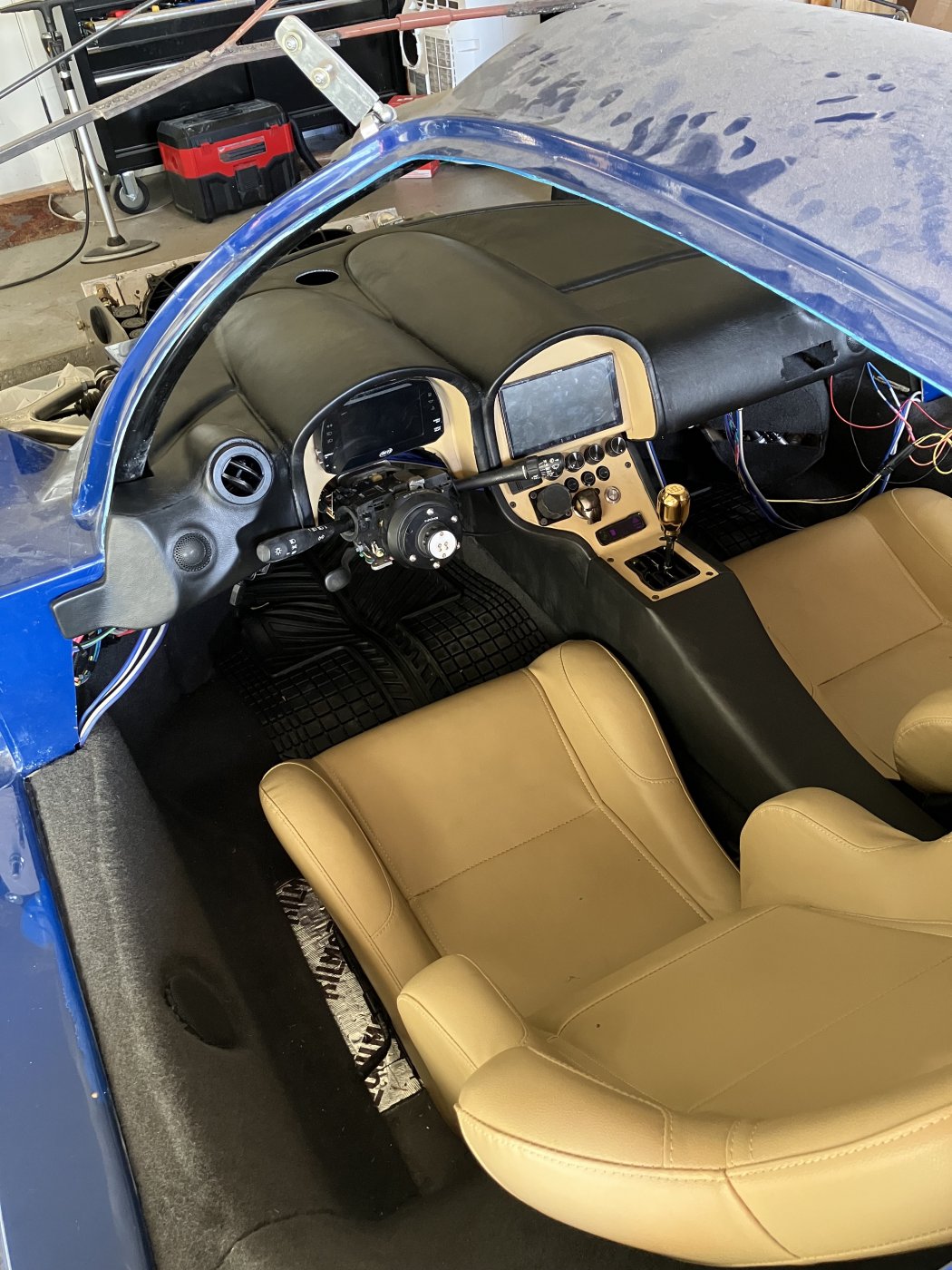

And finally , everything comes together for a nice looking interior , I believe . I am super happy with the final product and I learned a lot.

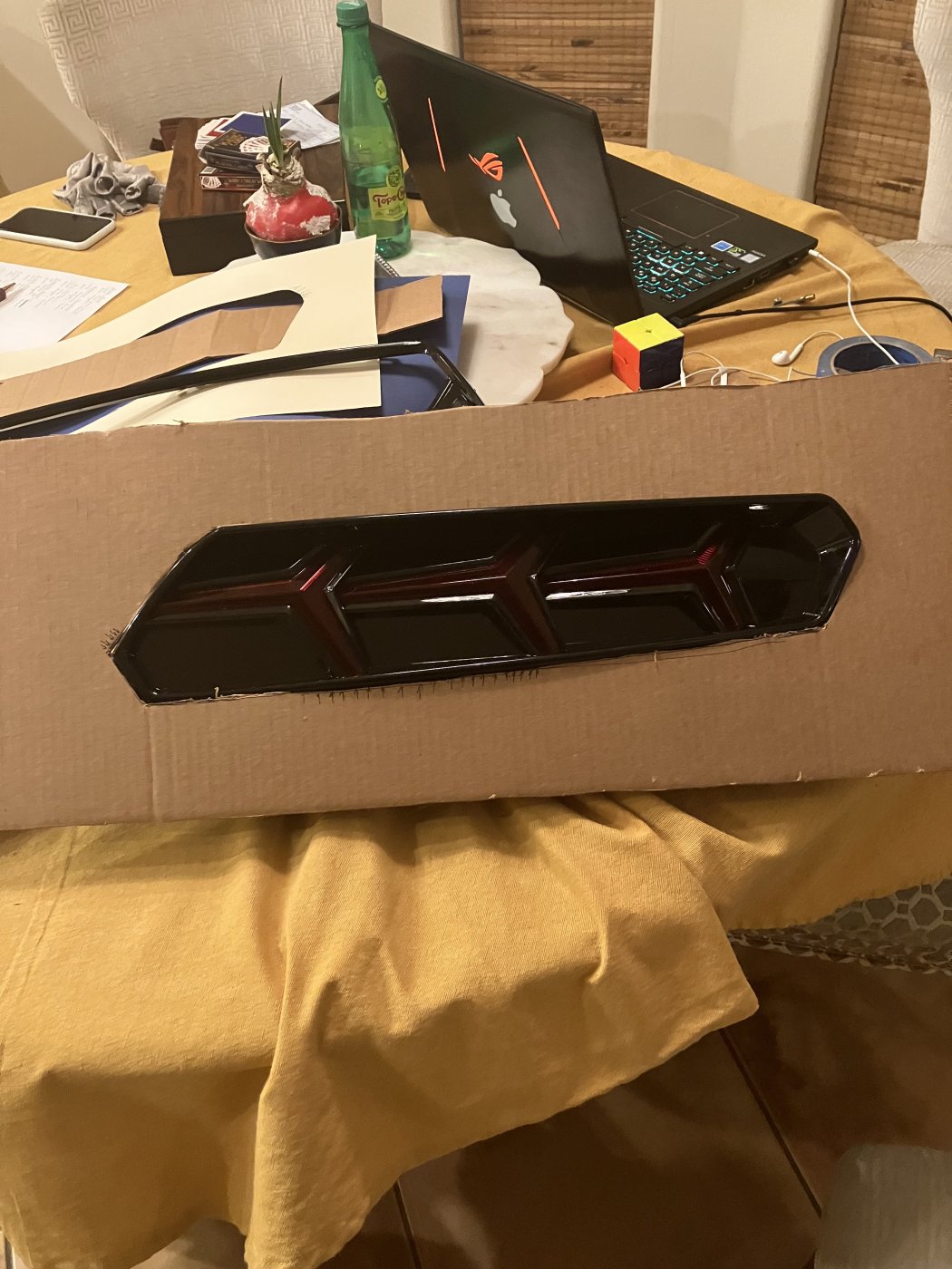

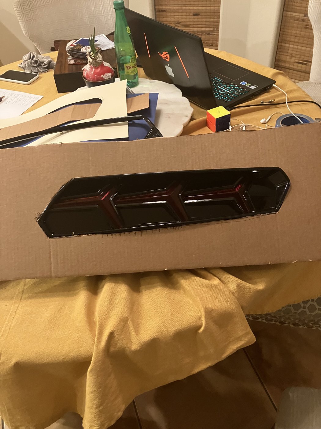

And to keep things going, just started the tail light project. It certainly is going to be interesting .... Morimoto lambo style C7 sequential tail lights . Lights are a bit curved, which is not a big deal, the length on the other hand is going to be a serious challenge... so here I go again . So hopefully this will not take as long as the headlights and the dashboard.

I painted the gated shifter and the shifter shaft black since the aluminum finish did not match my black and gold theme, however the paint is not going to hold out well, if anyone has any tips on how to black anodize the gate please let me know, otherwise I will to continuously touch it up, but I like the black finish a lot better.
Nice mega update! You don’t mess around. The interior looks terrific!

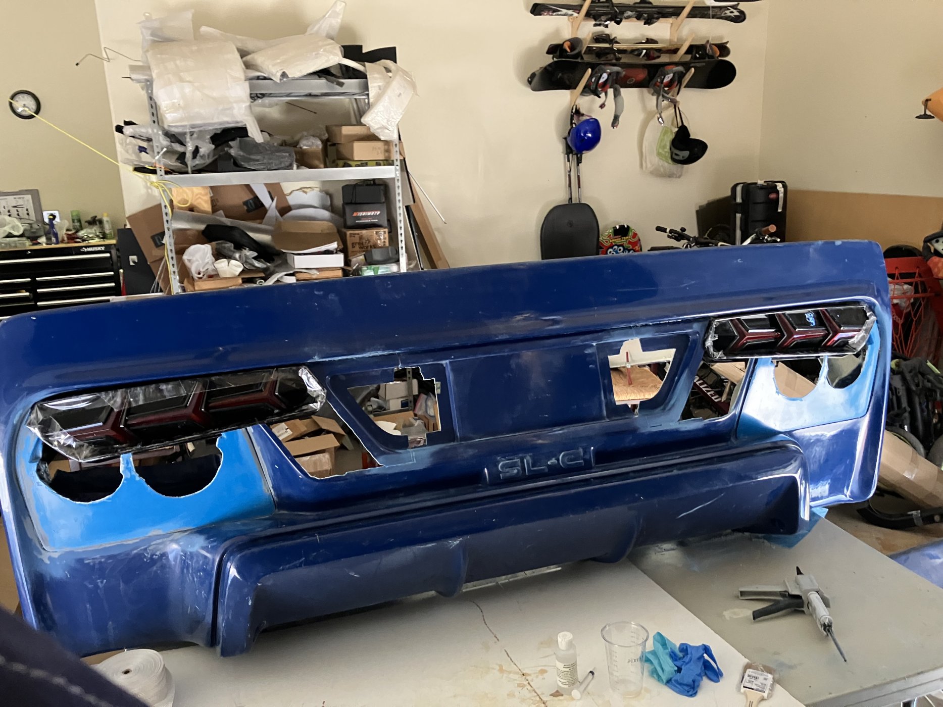

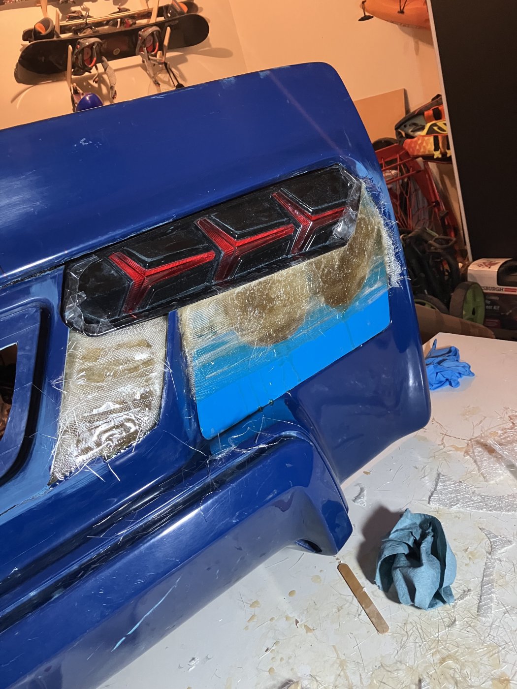

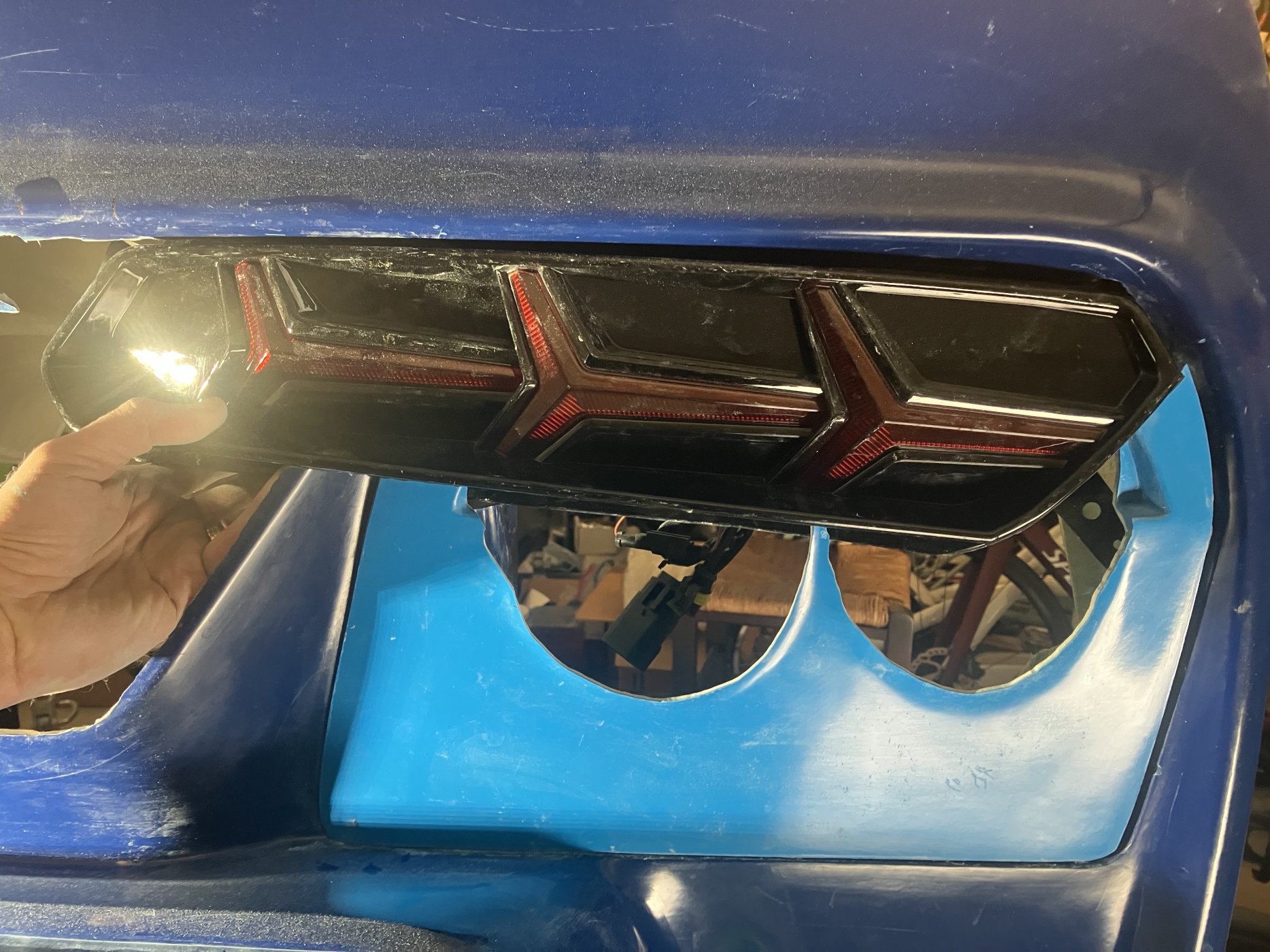

Well it has been almost a year since my last post, sorry, just busy. Working full time and tackling this project is a bit crazy . I will try to catch up in the next few weeks

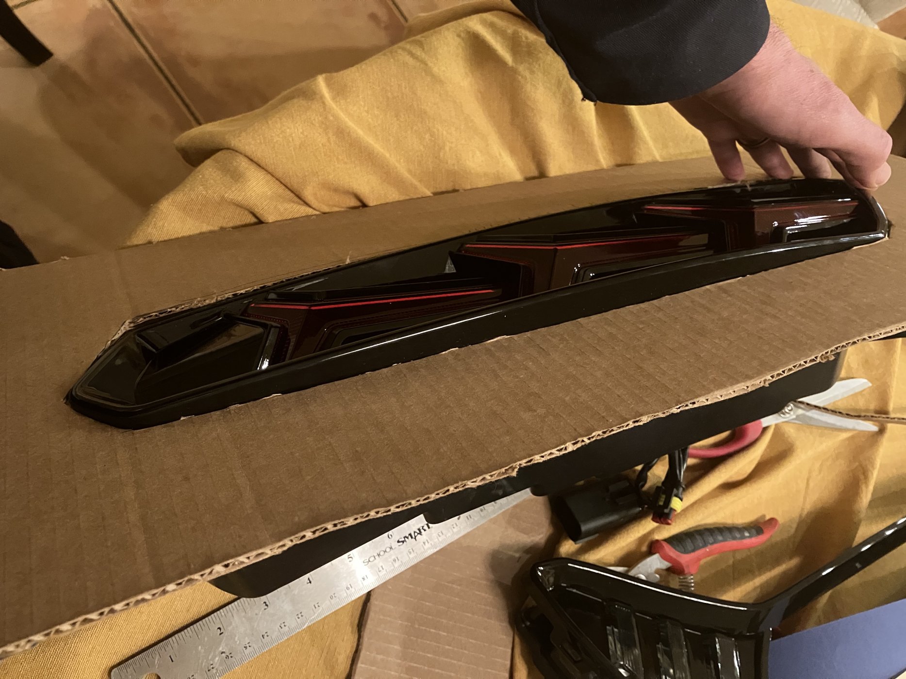

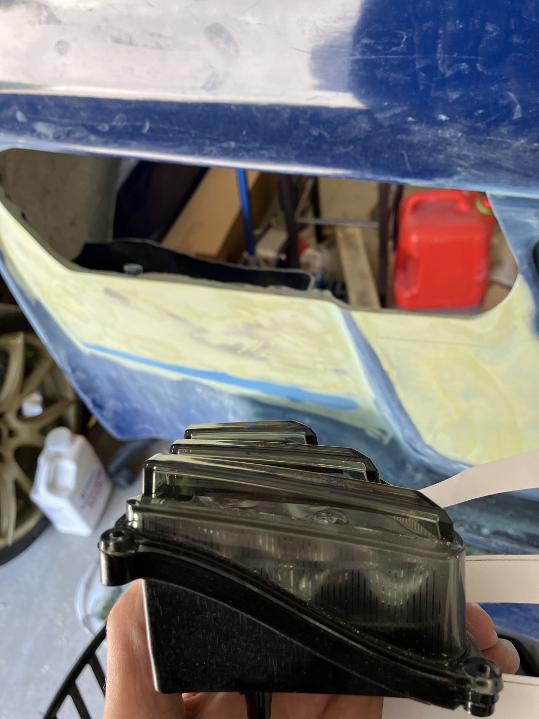

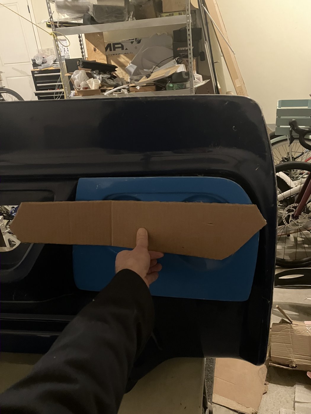

I was wrong again, the tail light project was not faster or easier than the headlight project , it was slow and super time consuming , but at the end I like how it all turned out .

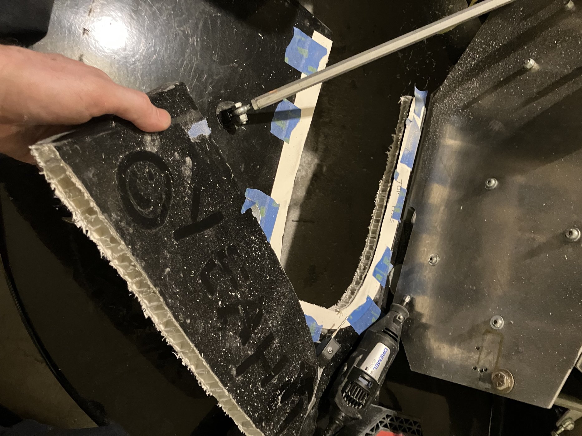

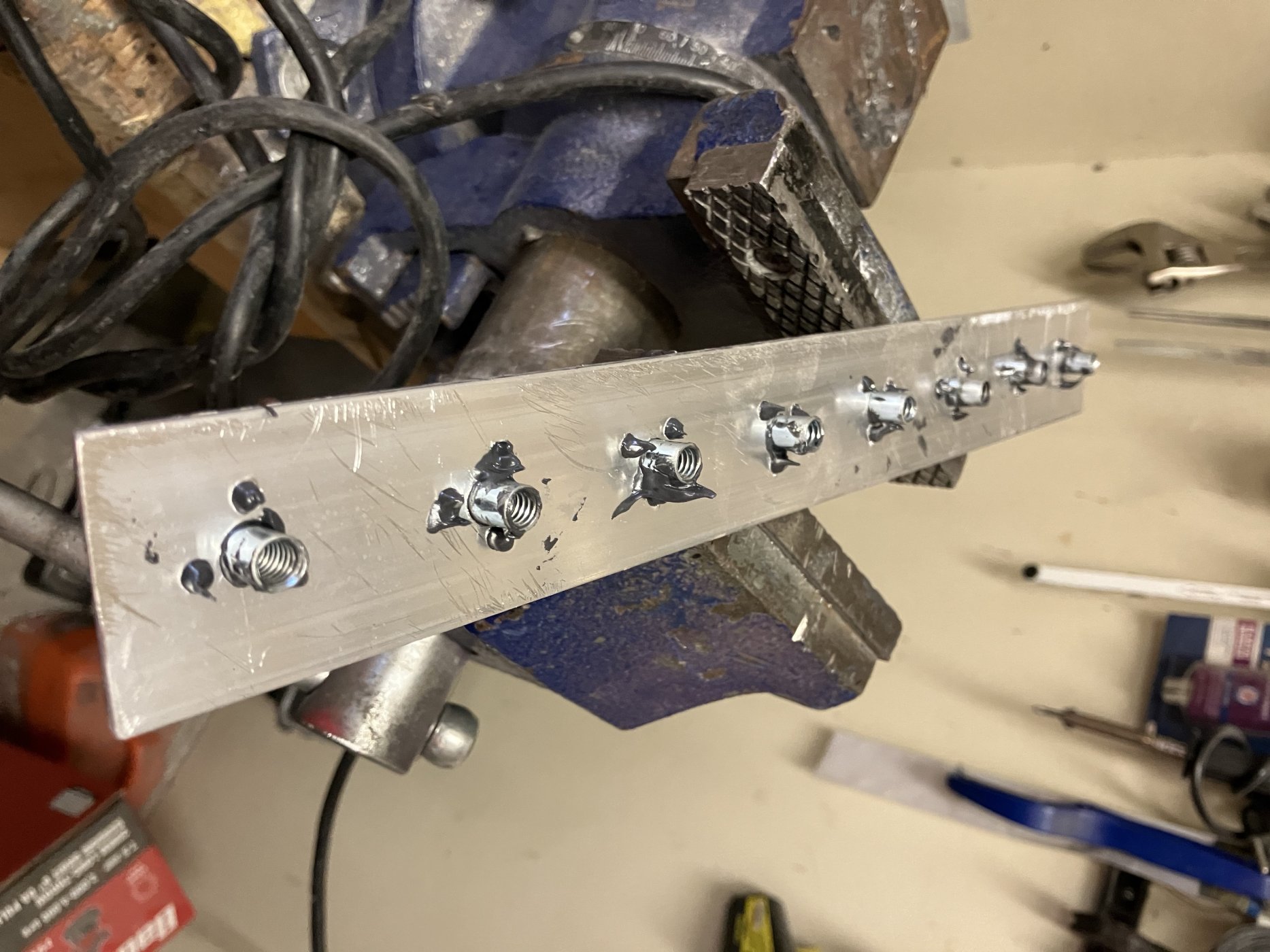

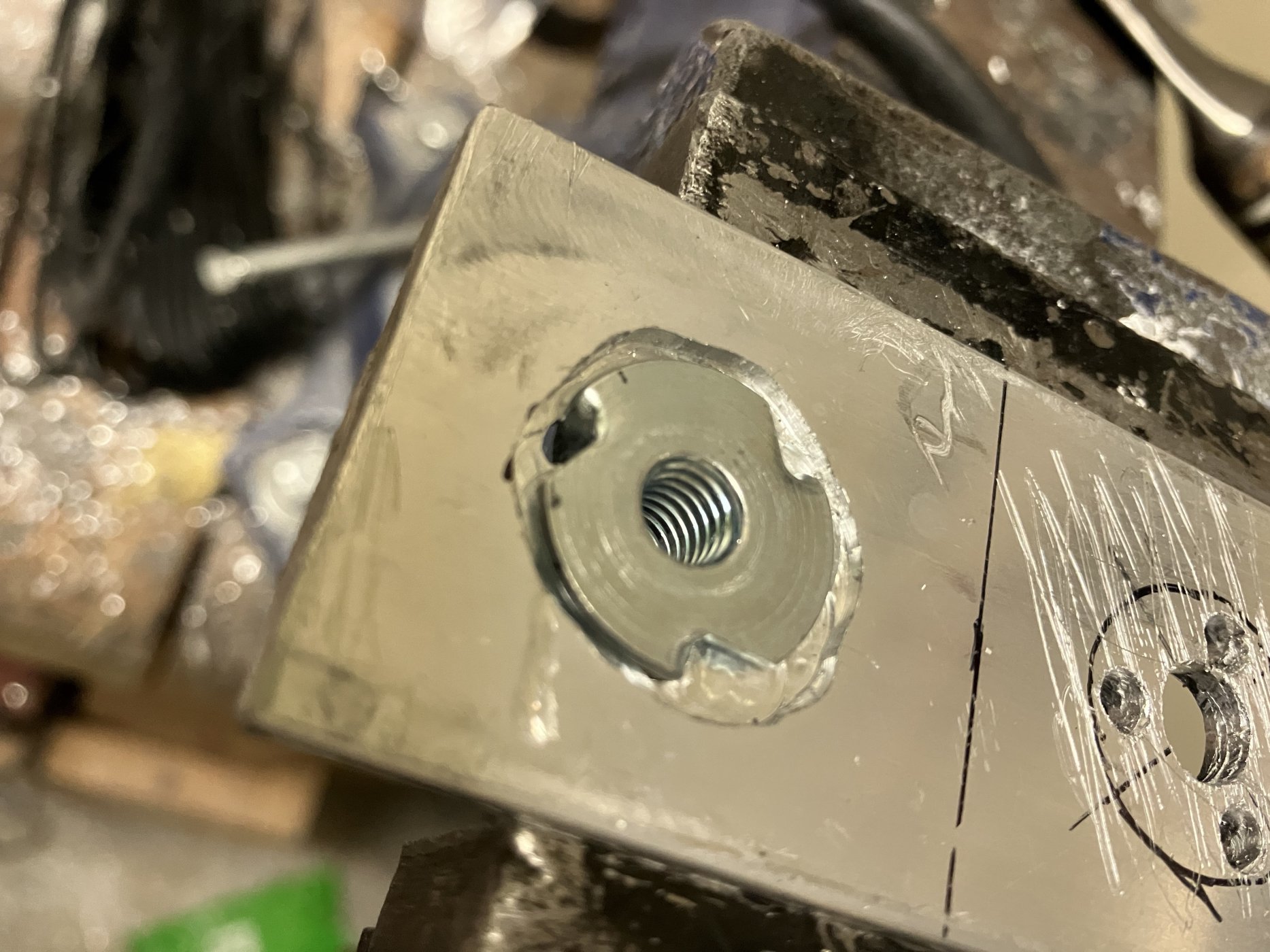

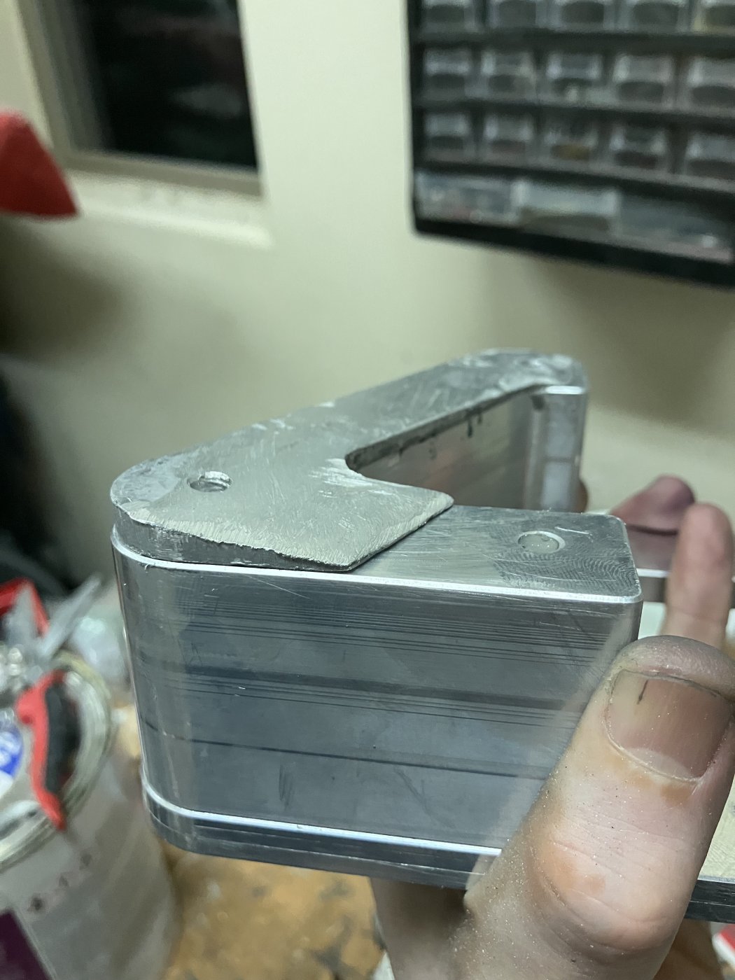

So roughly this is how it happened: Cut holes to size , used the same mounting technique by mounting Tee nuts to aluminum plates then epoxy them to the fiberglass and use the existing mounting tabs. I used the mounting plates for the dodge lights , just cut them and filled the holes .
Since the lights were wider than the area allocated, I had to move the openings for the exhaust tips, kept the same contour, just moved it over a couple of inches. Less room for the exhaust, but no other way to do it.
The backup lights were crazy difficult as they are curved and at different planes but made them fit. not supper happy with them but they are functional .
The third brake light is from a mustang , it is a bit curved , so it will be under a little tension to make it straight, but It works

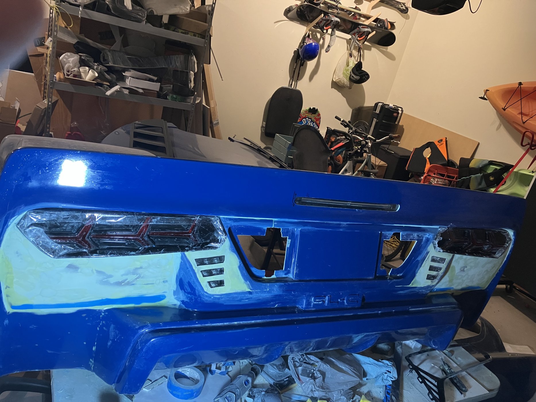

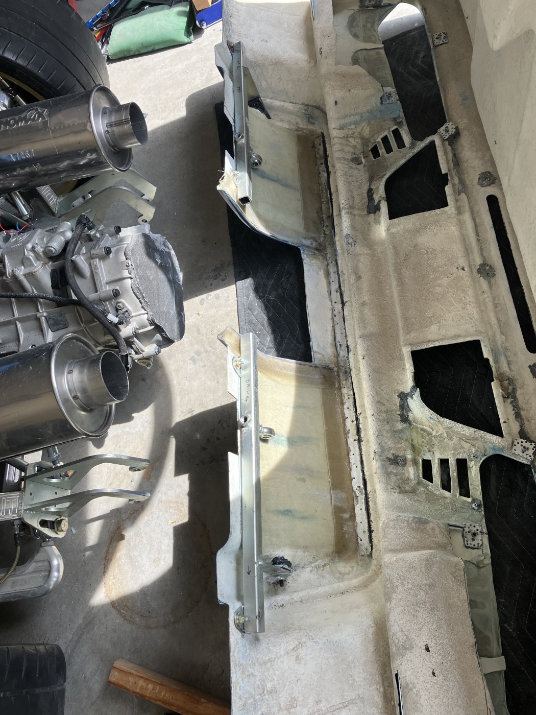

Holly crap, I just realized it took me a month and a half of solid work to do the tail lights back in February and March , no wonder this is taking so long LOL
here is a picture of the back with all the Tee nuts in place . I also cut the rear clam hinge to make room for the transmission when the rear clam is open and reinforced it with aluminum angle plus lots of layers of fiberglass cloth

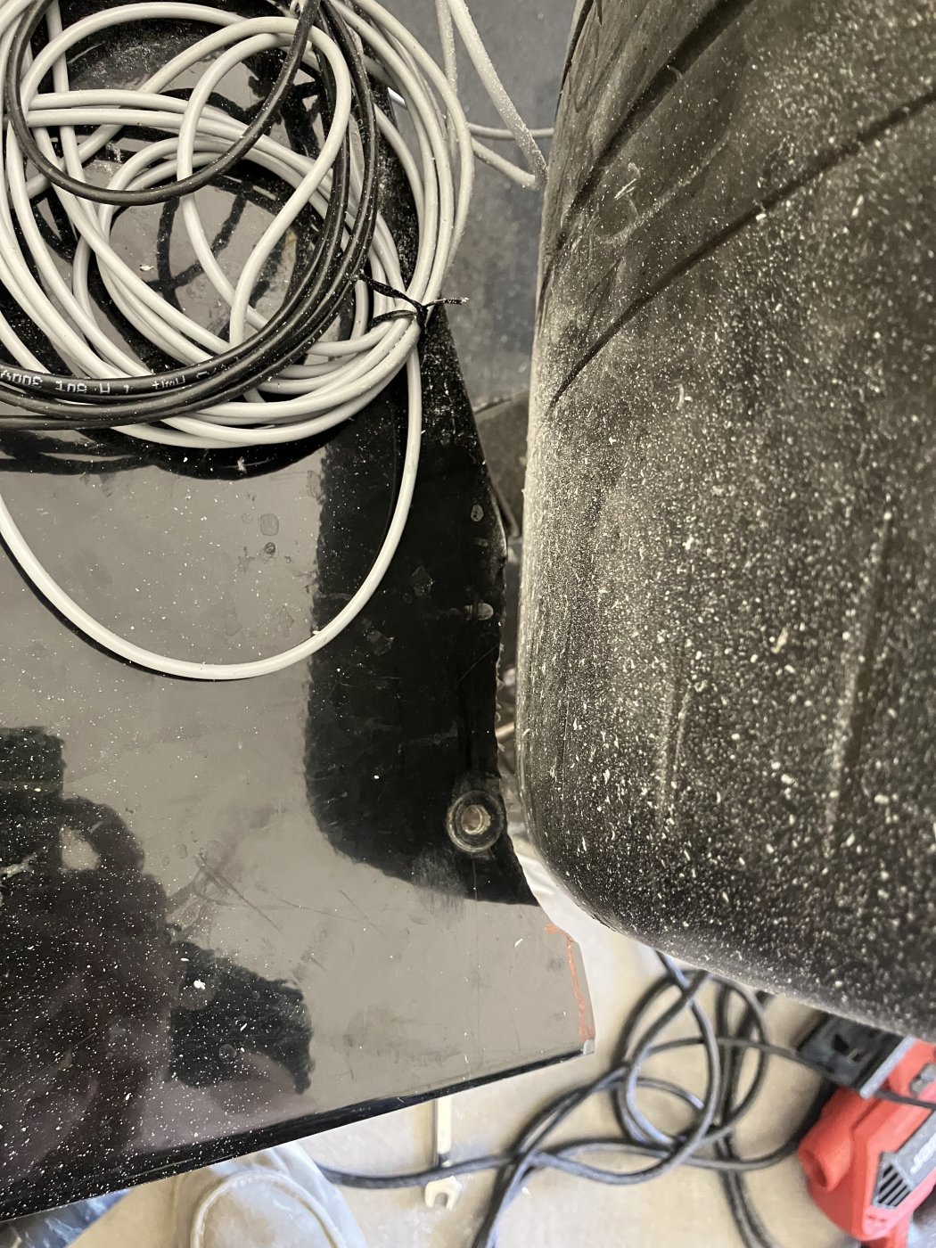

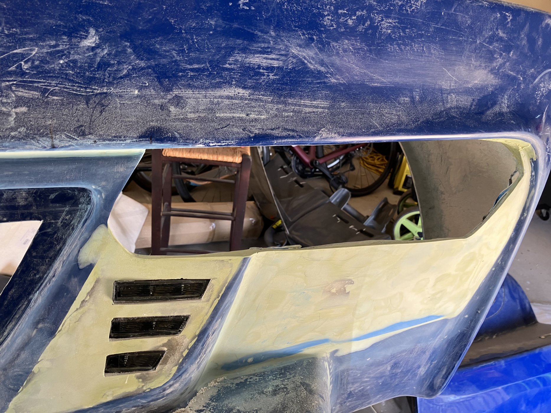

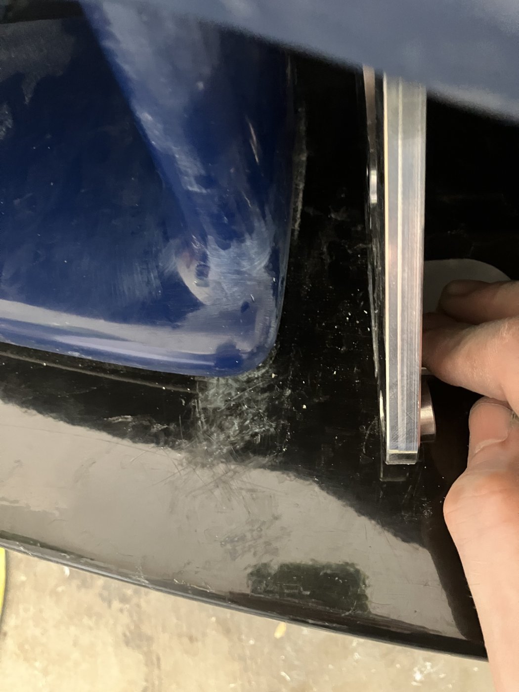

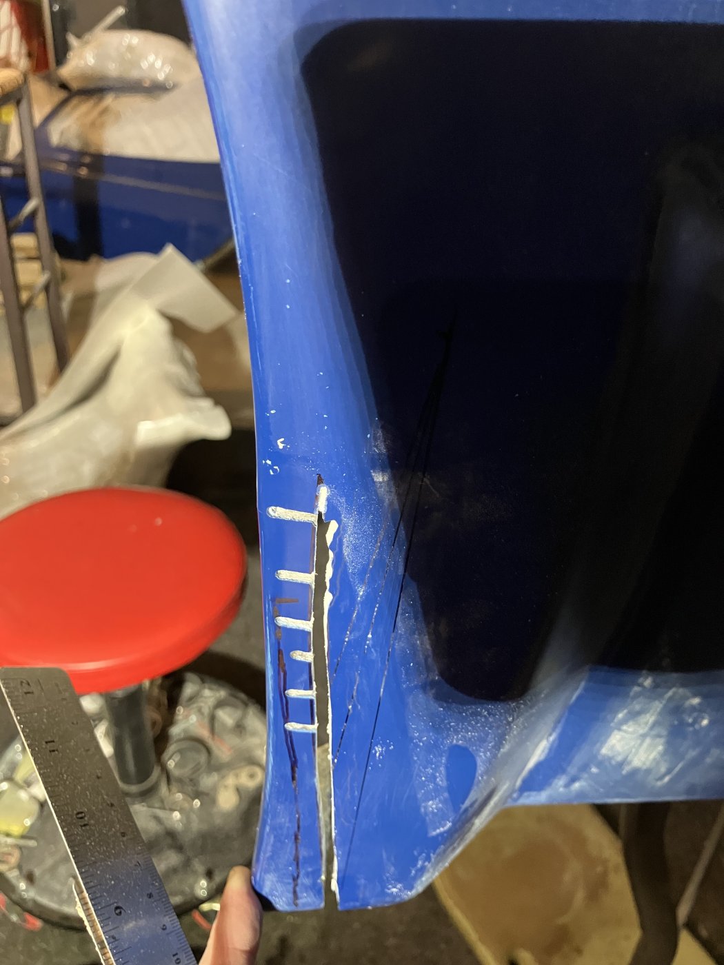

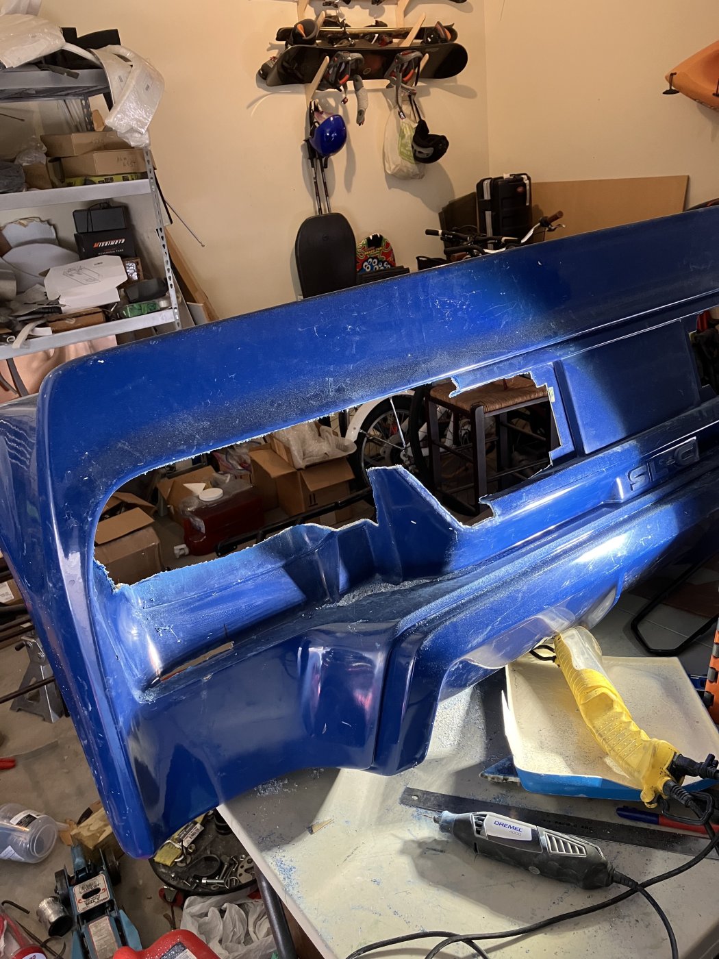

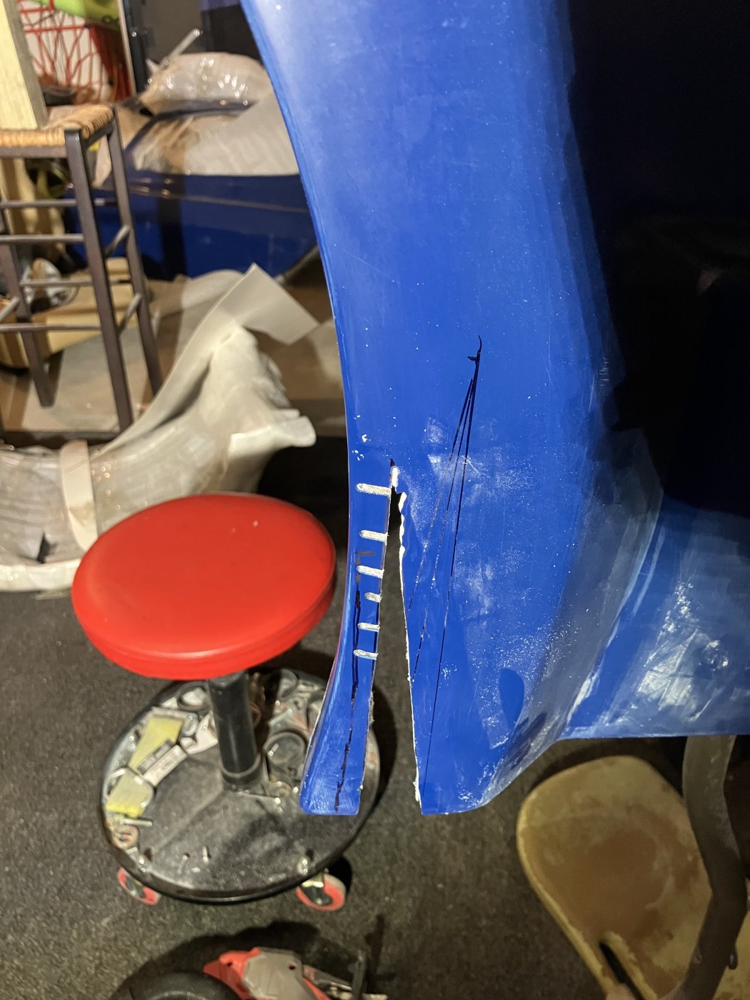

Next I connected the lift system , which is awesome , but quickly discovered that with the front lift up you can't turn the front wheels without rubbing on the front spoiler and the front wheel well, I know that some people choose not to do this mod, but I know I will forget and turn the wheel with lift up and make a mess out of the front clam, so....

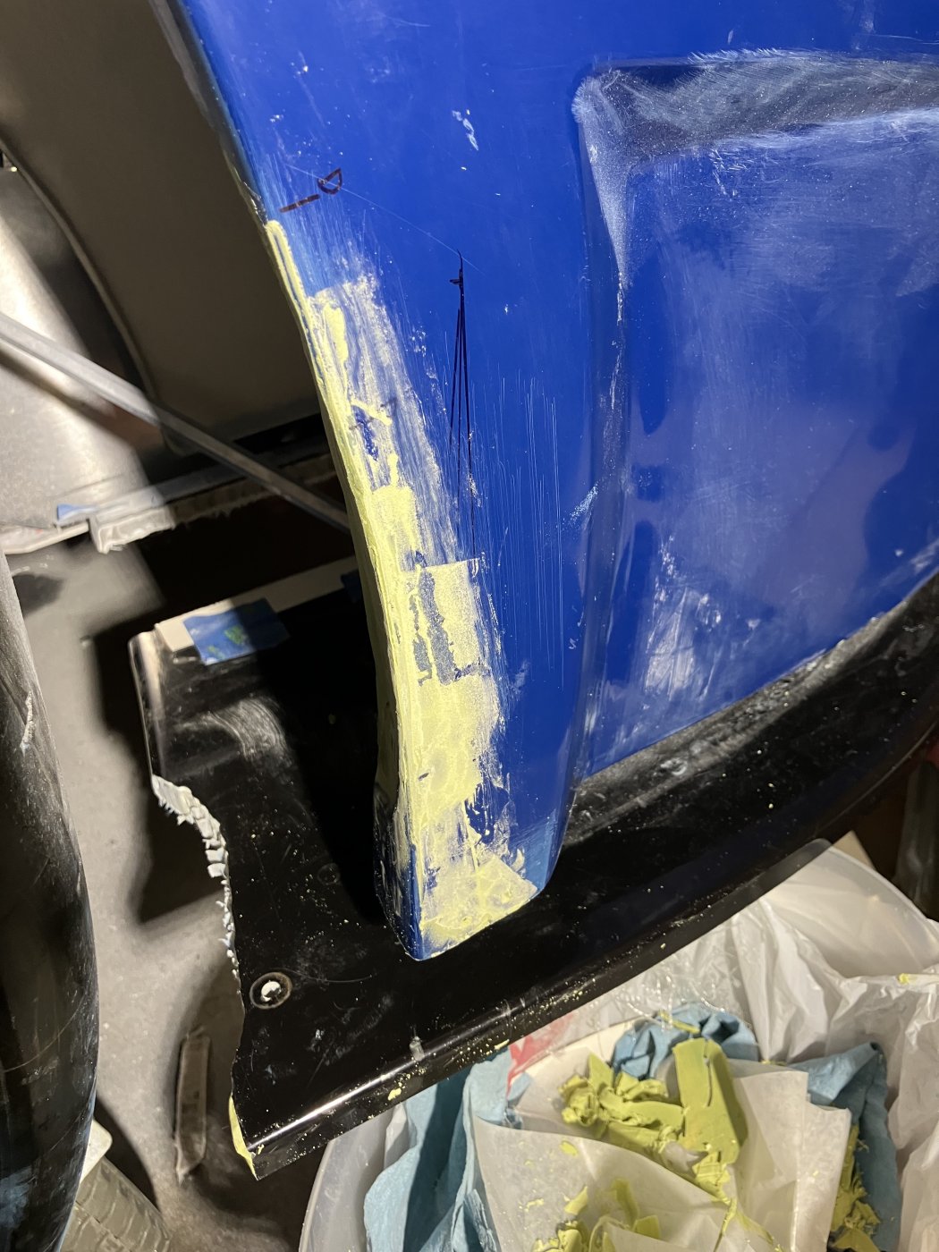

I followed Cam's lead again , trimmed the spoiler and also trimmed the wheel well, I also realized that the tires I have will not work , they are too wide , so , dismounted the Michelin pilot sport cup 285/30/19, and bought the pilot sport 4S 275/30/19 and that made a big difference.
Taking a chunk out of the wheel wheel and keeping the contour edge is much easier tan trying to re-do the edge , I agree with Cam on the approach .
I also cut the holes for the front diffusers

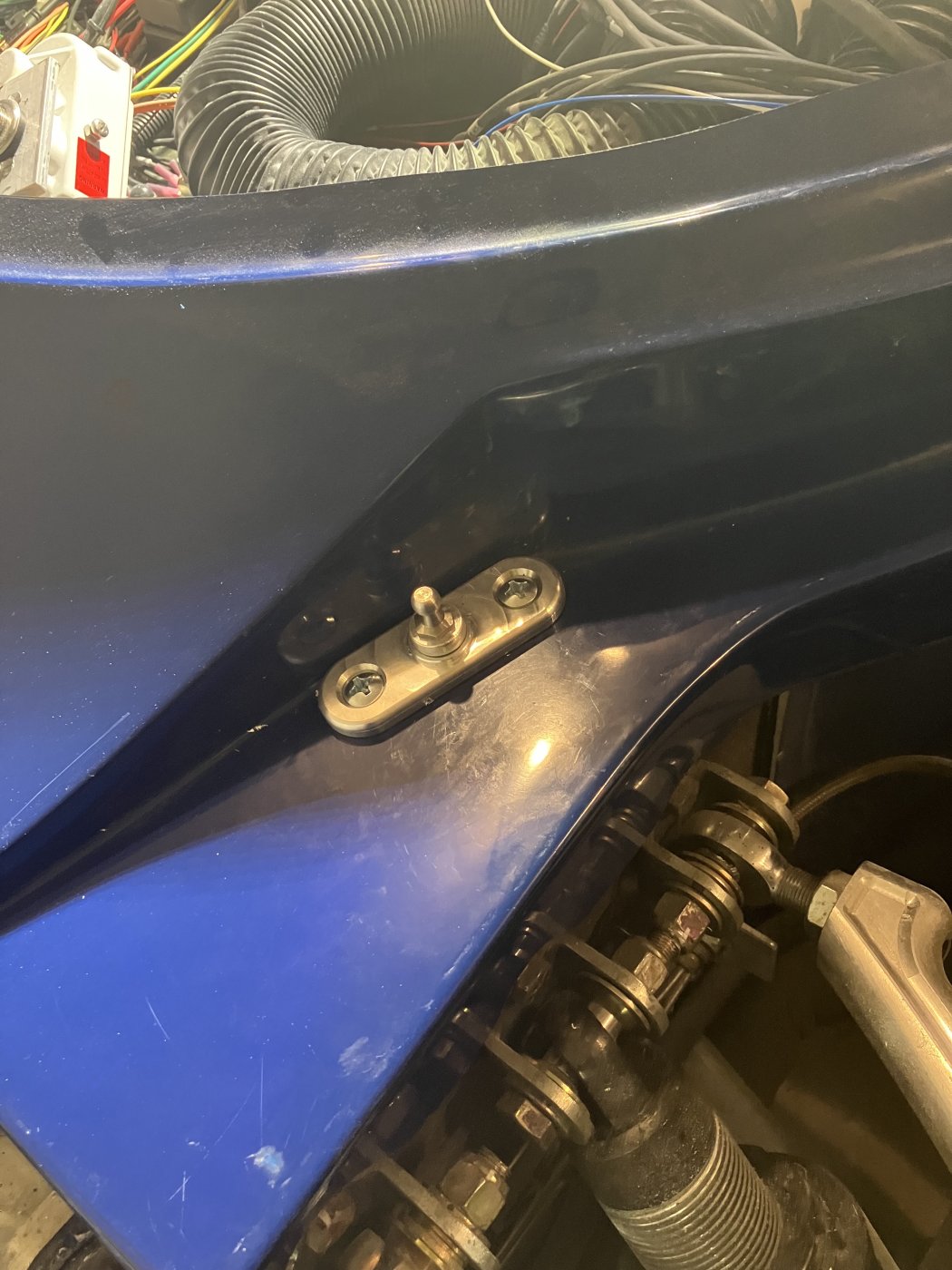

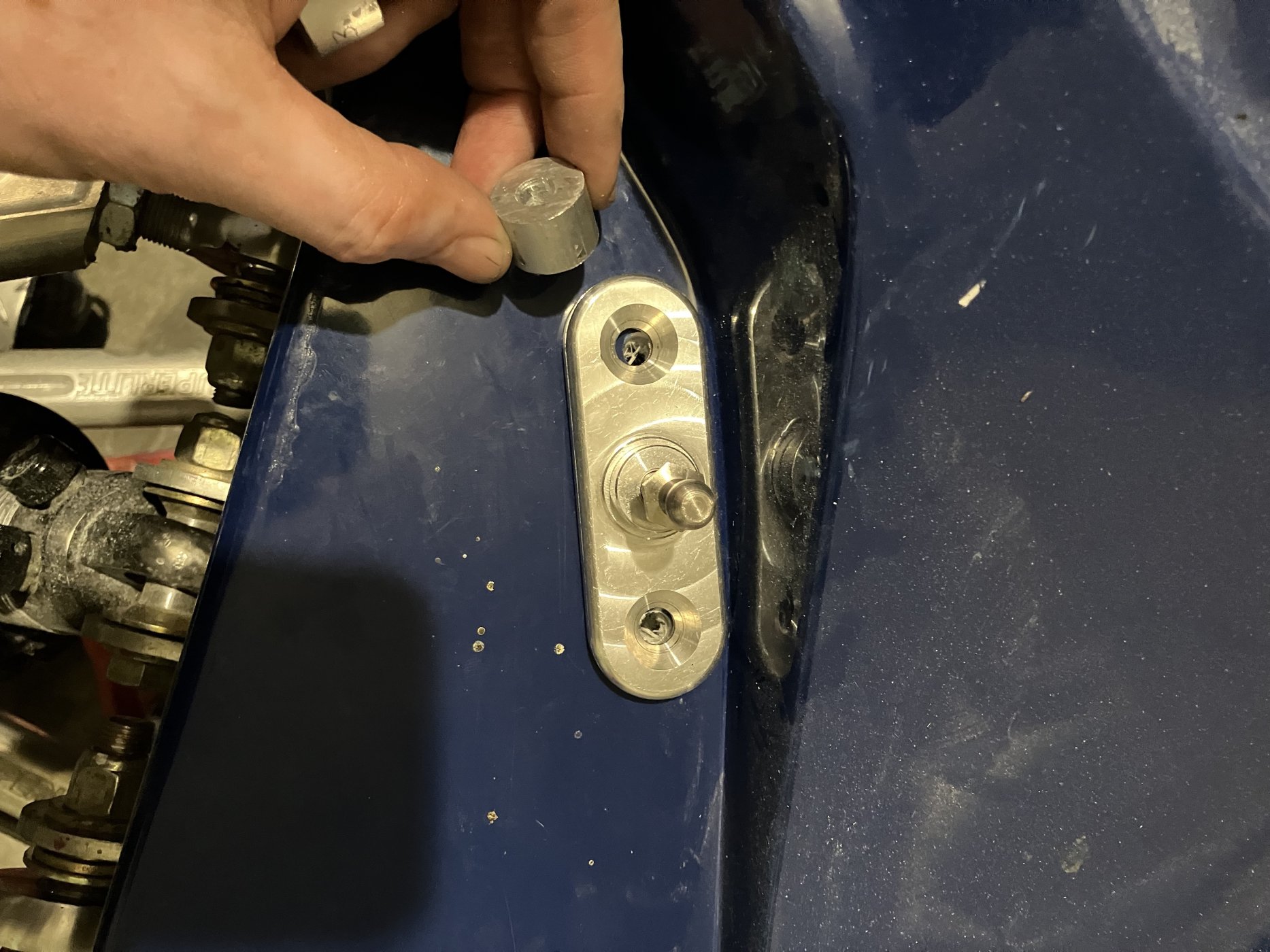

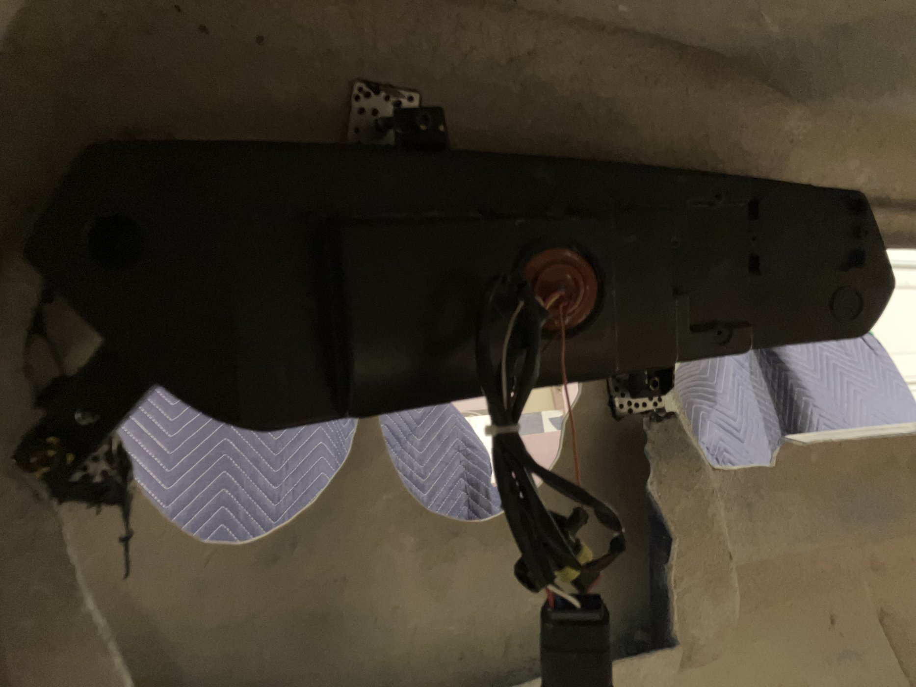

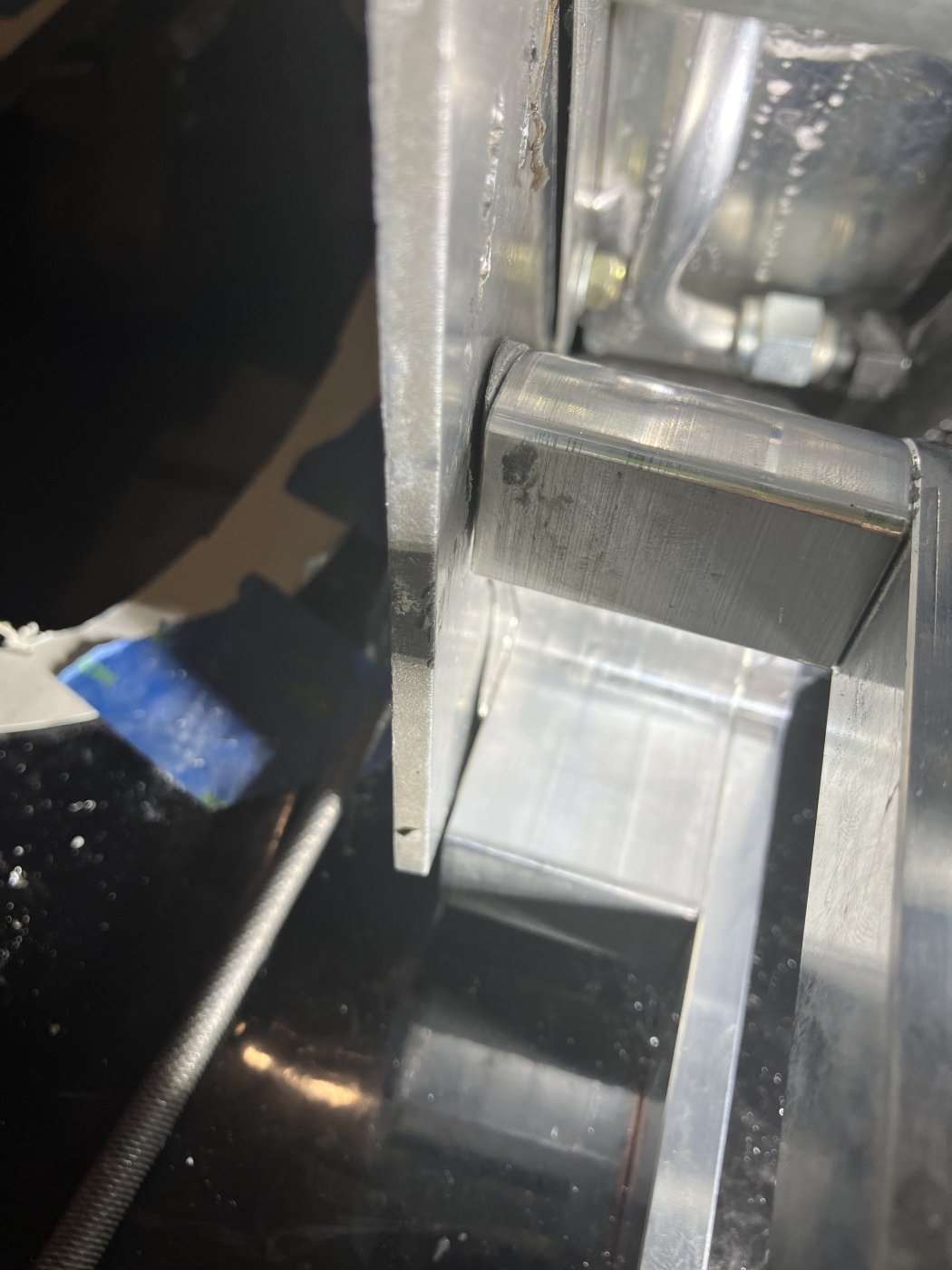

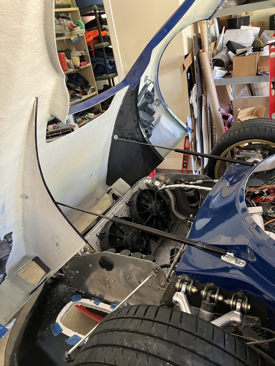

So , finally received my front hinge and decided to mount it prior to designing the front air duct , as it would save a lot of time .
like everything else in this project, nothing is straight forward , as it turns out the front hinge mounts to the walls of the radiator box, and those are not perfectly parallel to the frame, so , decided to make aluminum wedges to make the front hinge hinge work correctly.
Also it turns out that the spider does not sit against the footbox, so created some aluminum spacers underneath the strut mounts, that served to secure the mounts as well as the spider. Obviously this has to be done after the spider , front and rear clams and wheel wells were perfectly aligned with the tires.
Front hinge is a must when you are designing the front air duct and outlet , otherwise taking the front clam on and off several times is an absolute PIA, especially if you are working alone.
