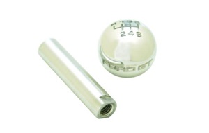

I don't have my Ricardo and shifter in the shop yet, but here is a photo from Ford Racing of the shift knob (with pattern):
Sorry Mesa - I missed the opportunity to check today as I was called elsewhere.
re Reverse though - I do remember it was a larger gap across the gate from the 1-2 position to Reverse, than the 1-2 position to 3-4 position. I hope that made sense.. and as per the pic above, it's hard left and forward.
This one is on a GTD as it happens, I'm sure Fran could confirm the details too.
