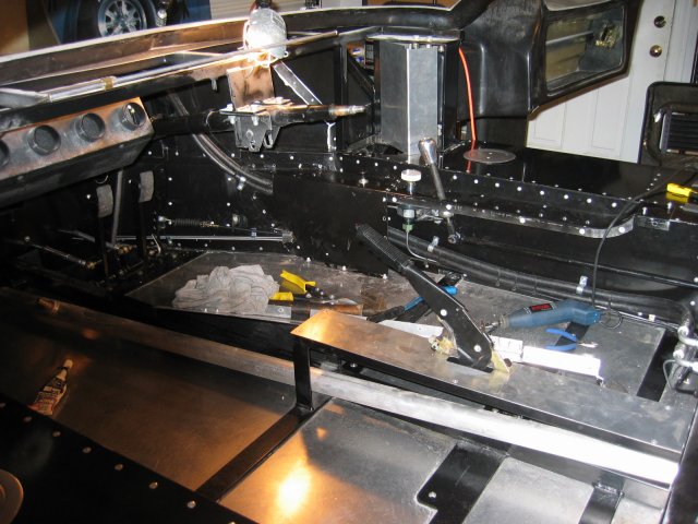

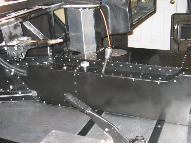

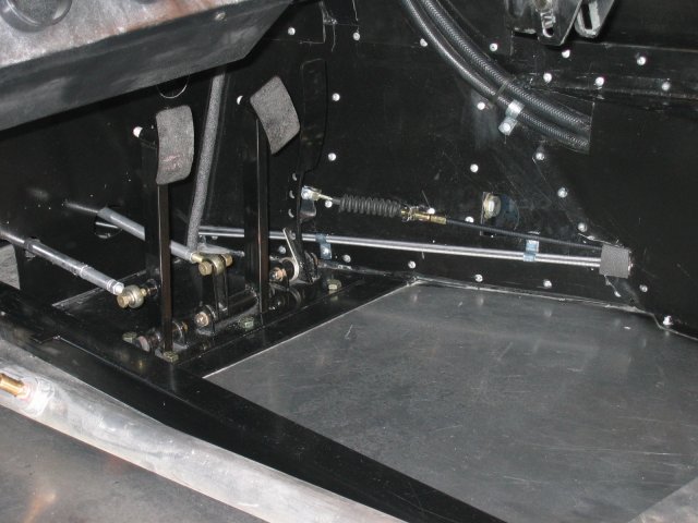

Some progress, although it is about 3 weeks old. Just a couple of pics of the side gear change and pedals. Side change is secured through many screws and is removable. AC, brake lines, heater control, accel cable, and gear shift run through this area. All are secured with rubberized "P" clamps and are very stable. I made the accel cable bracket so it is quite small. I also extended the front of the side section to meet the front part of the car, I did not like the original design that just left that tunnel open.

Looking good, Ron. Did you use rivets or screws/rivnuts to fasten your P clamps to the chassis? Did you fasten to chassis rail or only to sheet metal?
Re: Roaring Forties #44 - Ron Earp\'s GT40
I used rivets on the P clamps and did not limit to only frame rails. The major anchors for a line are on frame rails, but I also used the panels when needed - I don't like rattling lines or things to be untidy. And, any rivet used got a blob of sealant on the head before insertion as is usualy practice for me. Over time they will work loose and this can seriously prevent it.

The extension idea I got from Hershal so thank him! I mounted my heater cable on it since it seemed like a great place. I was going to mount my fire pull up there but since I'm lefty on things like that I'm mounting the fire pull on a small panel I'll put in front of the emergency brake, that way the passenger can get it too.

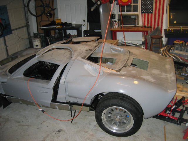

Progress! It is off the dolly and on the ground! It looks "jacked up" but I suppose that is due to no engine loading. I'll fix that this weekend. I did put a crack in the chin spoiler lowering it but it isn't large and I think easily fixable. In panic I forgot which way loosened the jack and ended up bringing it down too far on the jack. Shit! But, easily fixable.
